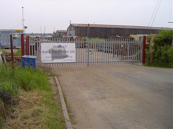

thats a top job u done there mate i see the hinges at the bottom are facing down is there a reason for this, or is it my eyes im making a set of gates for a friend at the moment there 11ft double gates ie 5.5ft not made a set this big before what size hinge do u use for that size of gate any tips would also be welcome also what paint do u use thanks nige.
Nah, we paint them. Its the worst part of the job, because suddenly something which could be dragged round the shop becomes more delicate than a very delicate thing.
I think painting takes as long, if not longer, than to actually fab them!
god i hated that jobDont we all i wish people would pay extra for powder coating
total of 17 panelsgod i hated that job

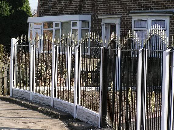

Is it me or does that look horrible.
Is it me or does that look horrible, why would you want everyone to see into your back garden?
thanks for the reply i bought some 16mm adj hinges today and a weld on pins to match, im using 60x60mm box for the posts and 30x30mm box for the gate frame do u think this will be ok,also what sort of price should i be paying to have a set of gates powdercoated 11x6ft approx just a thought dont fancy doing all that painting by hand nige.

The posts on the gates i have on this thread are 80 x 80 x 3 box section, concreted in and bolted back to the wall.
Yer don't comment do you.
Customer goes err.. i'd like so and so.. you go oh yes, that will look lovely. make it. fit it. get paid. snigger with workmates after. customers always right n all that!
yeah the customer all ways know what they want i just make it fit it and get paid for it
