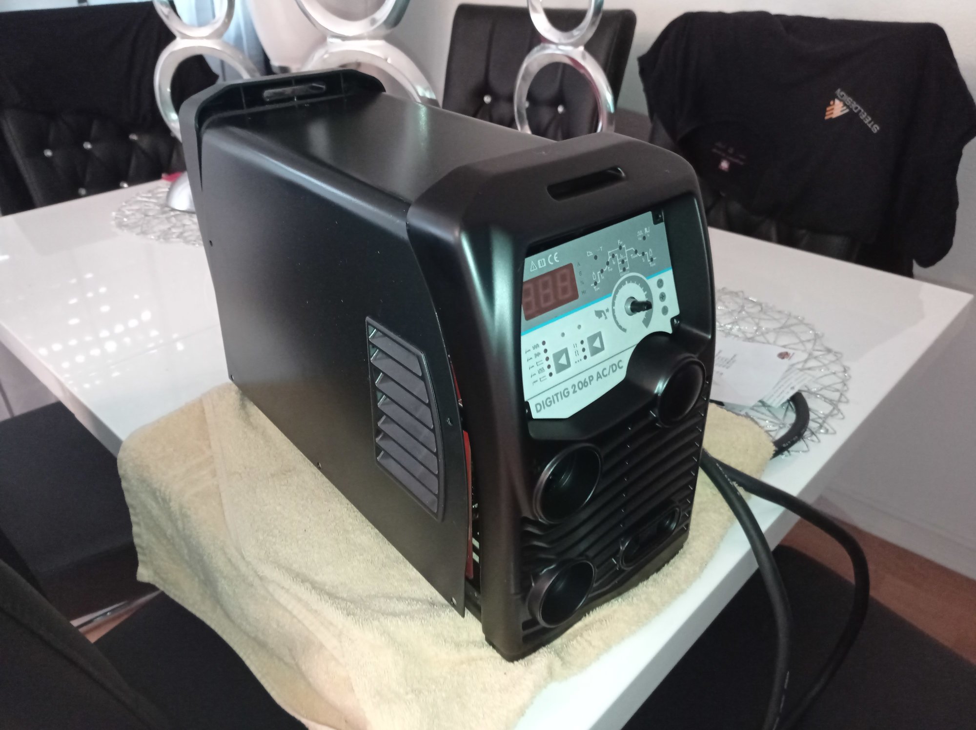

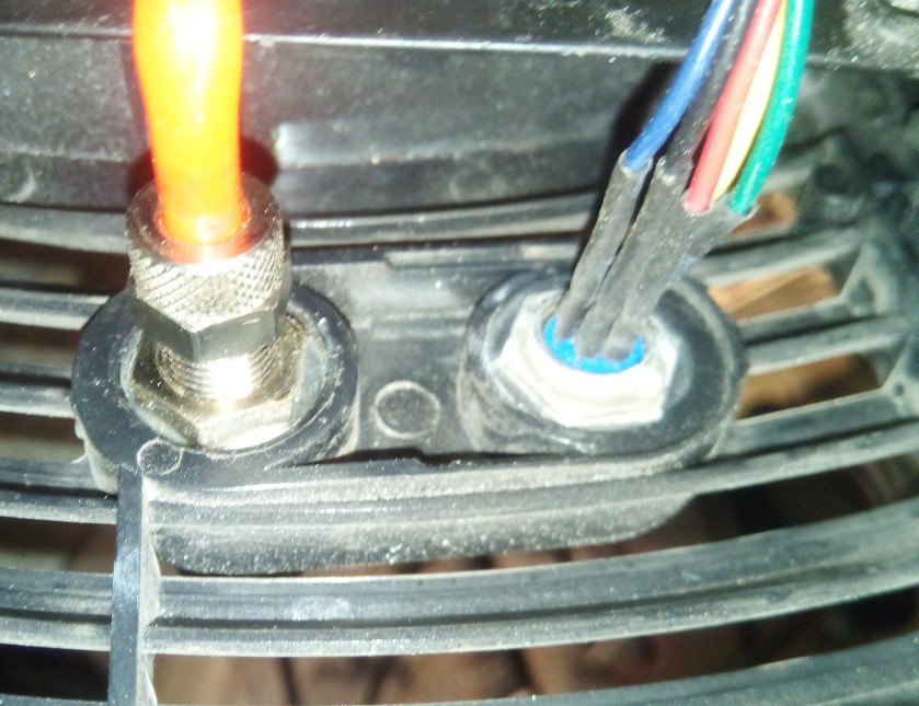

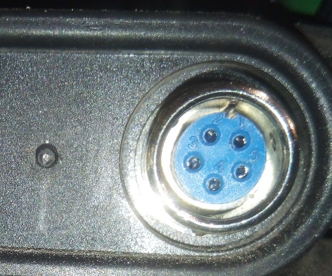

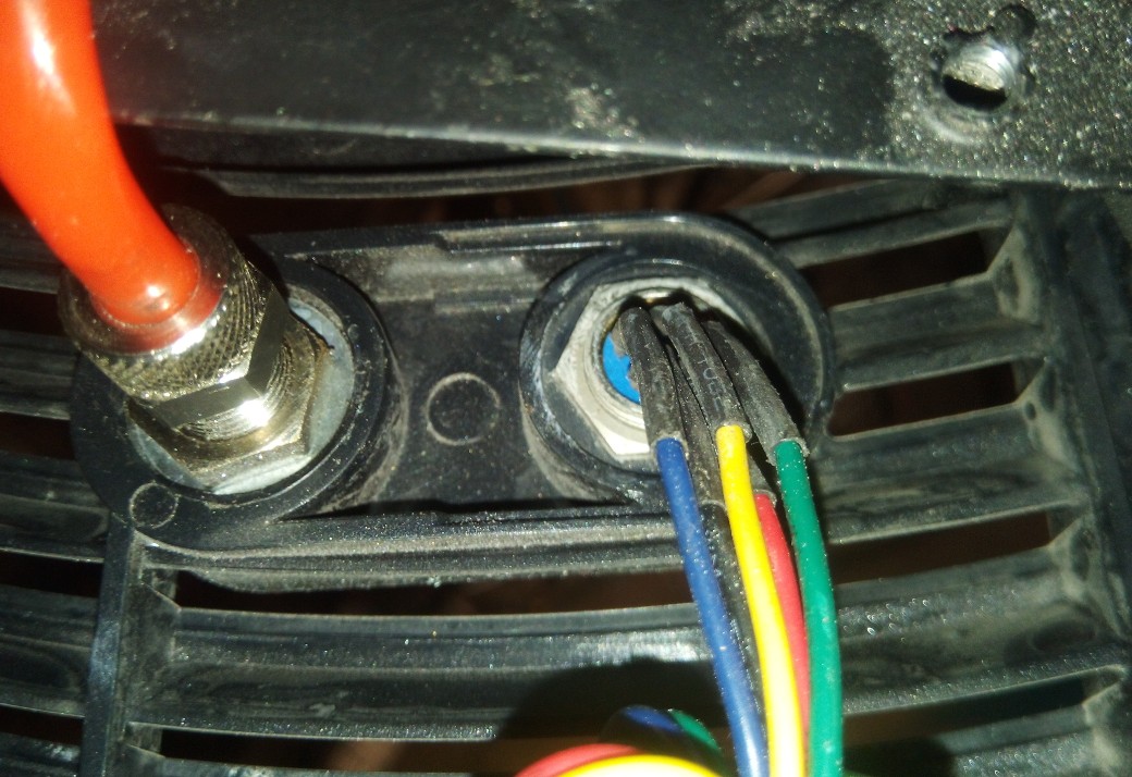

Took mine apart for a clean this morning and took some snaps for you.Where is Pin 1 at the connector? I made a mistake when I broke this tiny little Bastard.
And now it's in the trash...
So
1. Red
2. Black
3. Blue
4. Yellow
5. Green
