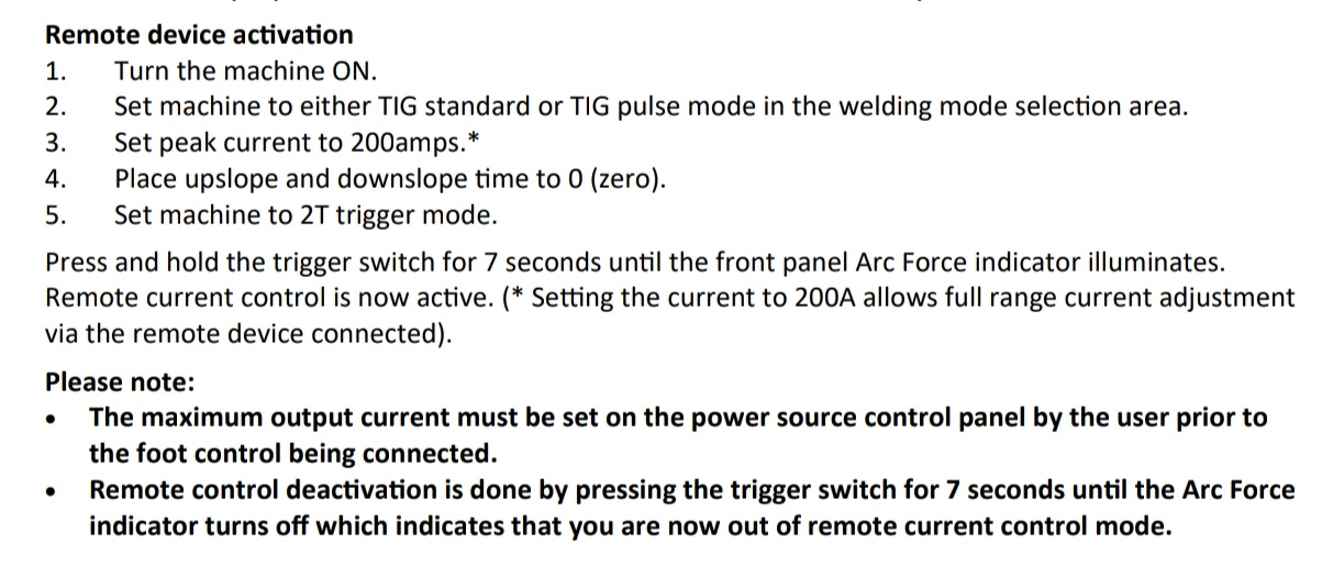

On another note, does anyone know if it is possible to keep the Sherman in remote (pedal) mode, or do you need to faff around with the pedal connector every time you turn it on? If so I'm adding an inline connector which is more robust.

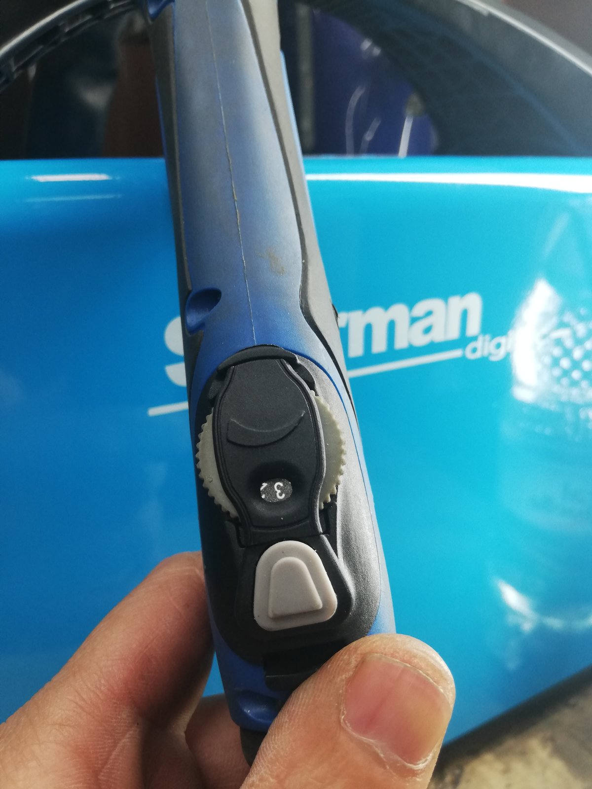

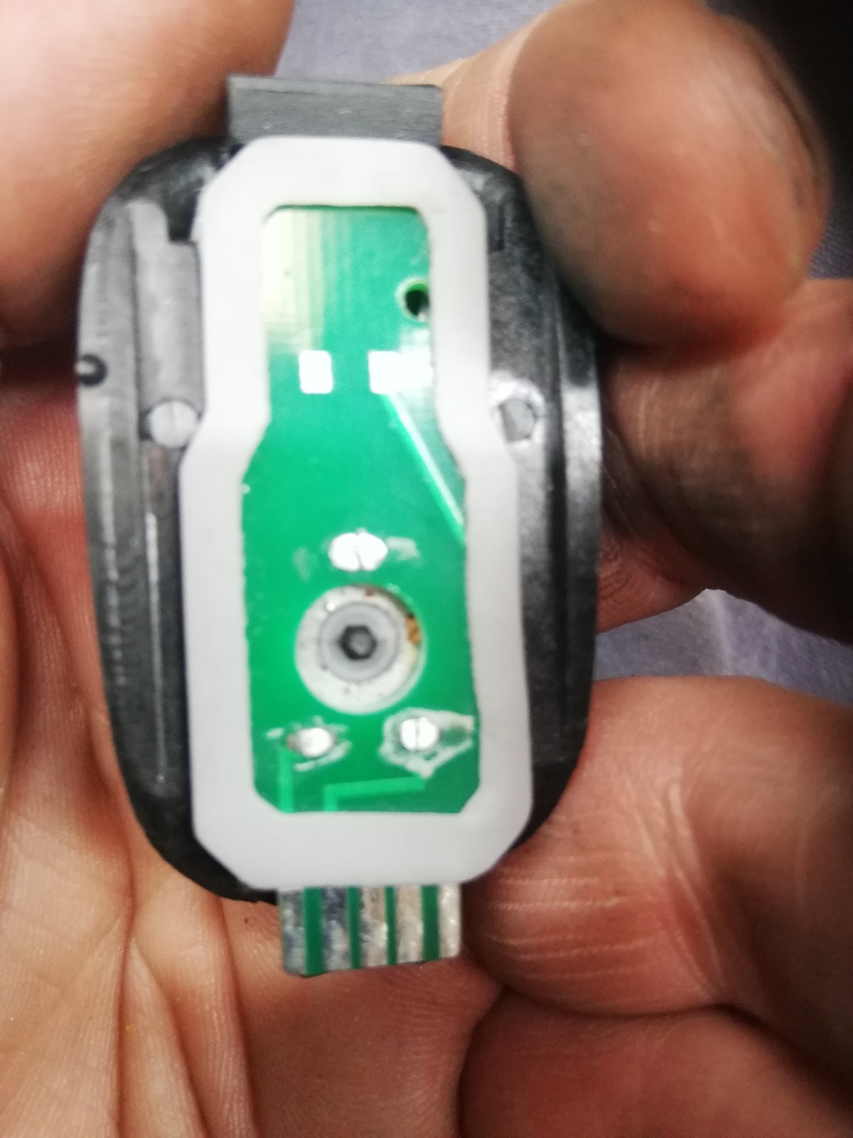

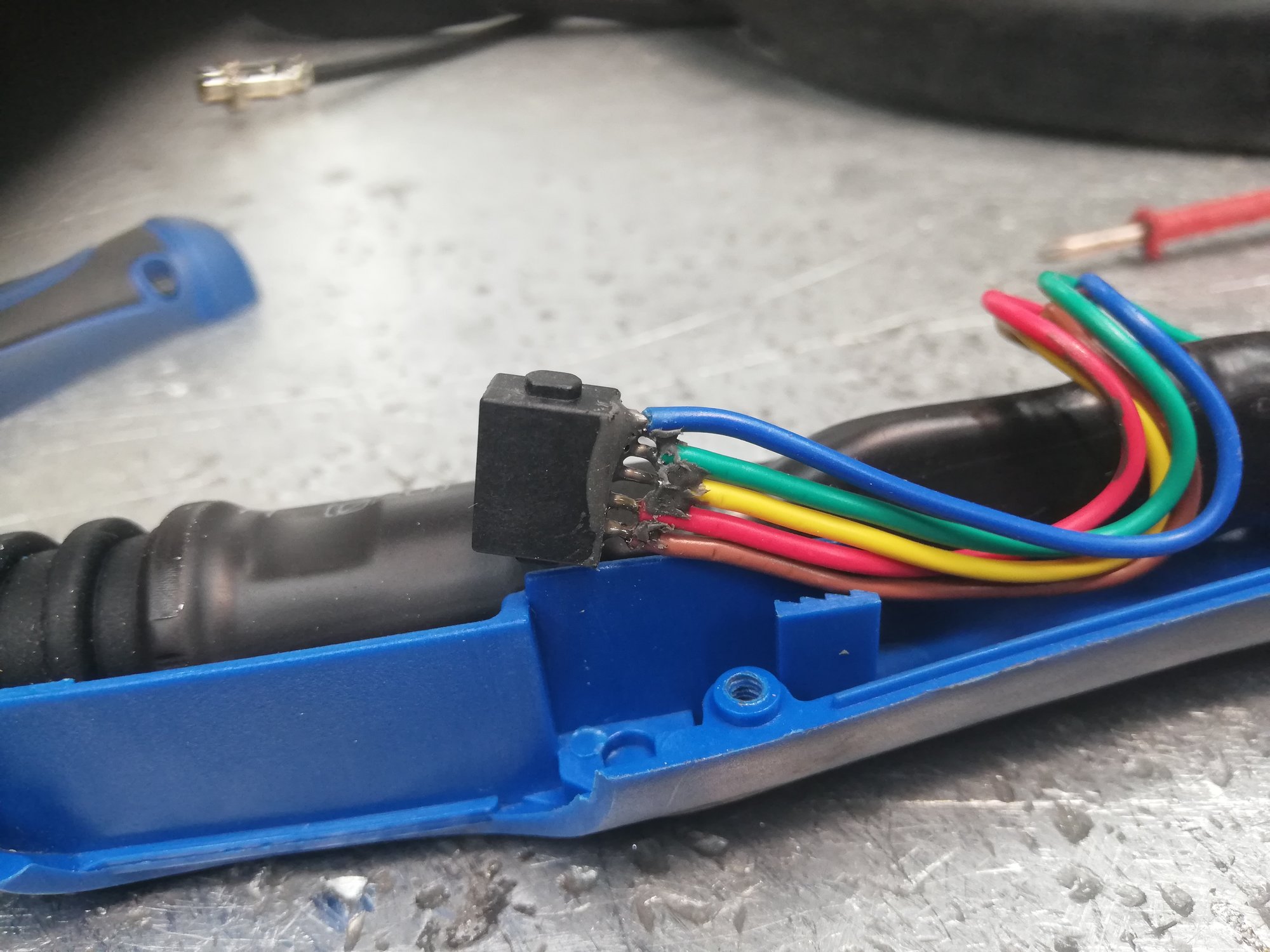

I’m not sure I understand - the red and yellow wires in the photo don’t correspond to what you have written in the note. Is that why the current adjustment doesn’t work. Sorry, might be a very dumb question!My current amperage adjustment doesnt work
4T is activated and the Remote LED ist on
For the pedal, I seem to remember that you just need to do the floor it for five seconds thing each time it's turned on (from memory, not tried it just now!) - is it not working that way for you?
