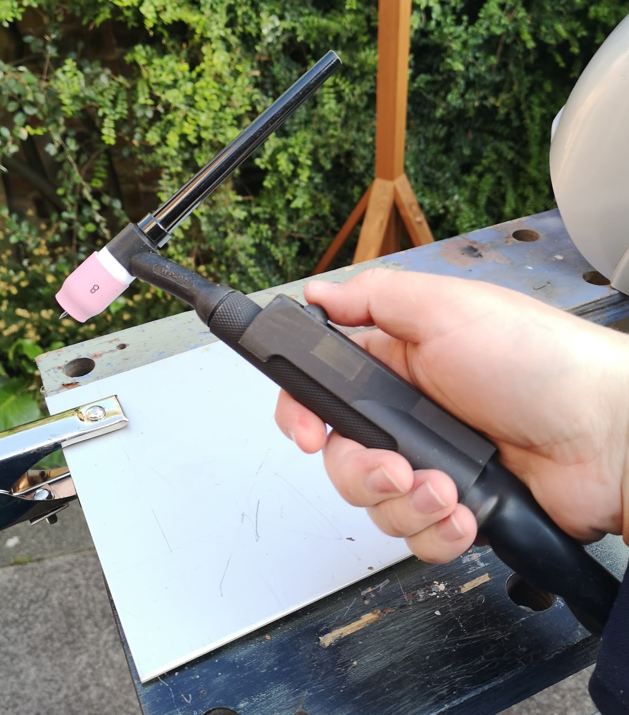

The one thing I don’t like about this so far is the torch, it just seems unnecessarily bulky... maybe time for an upgrade...They look ok for someone starting out
Get a flexi head on the torch and it will make things easier.
I used a WP26 torch for years and never knew any different so it was fine. I did always have a flexi head though and that makes a huge difference.The one thing I don’t like about this so far is the torch, it just seems unnecessarily bulky... maybe time for an upgrade...

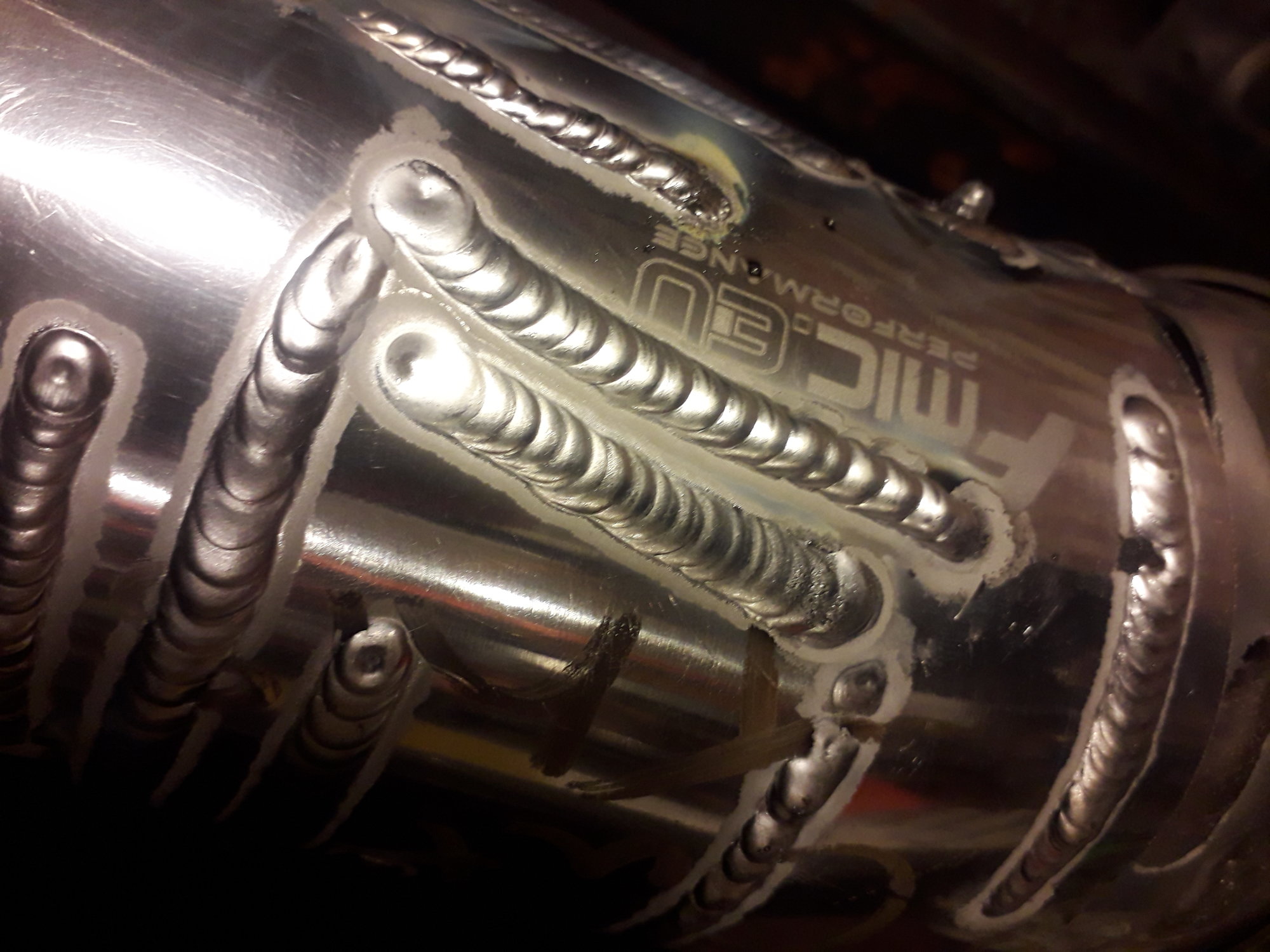

Thanks both, much appreciated. I'm hoping I'll get there. After I got a few reasonably consistent(ish!!) beads, I was quite chuffed when I got the 2mm top sheet welded to the 3mm under it. I feel I've made a lot more progress, quicker, than I ever did on MIG. As I said earlier in the thread; it seems a lot more user-friendly.
This said, I started to feel like it was becoming a little more consistent then I'd dip the tungsten or feed the filler directly into the arc, or something similarly stupid and have a setback and back in the shed to grind it again. Also had about 30 mins where neither of my helmets would stay dark, which was a bit annoying. Nearly jacked it all in then
On the torch, I have actually splashed out on a different WP9 torch with a flex head. This was the one I'd got the adapter, etc, for (supplies links earlier in thread). I much prefer the button too - definite click on and off. I know it's a silly thing but the bundled torch switch felt like there wasn't a lot between pressed and released. Twice I stopped welding when I thought I was still pressing the button. Here it is before I started today (appreciate I've probably got too big on cup on it!):
