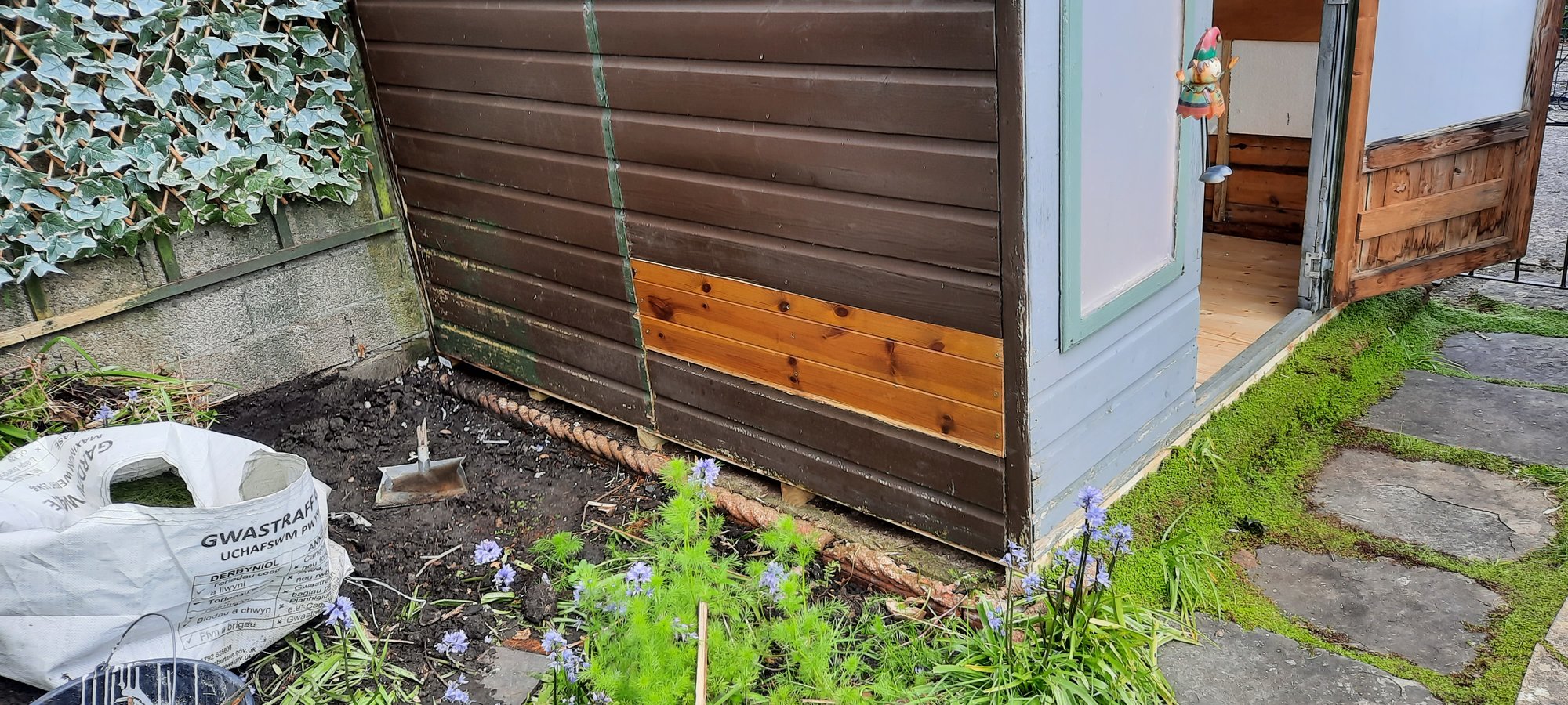

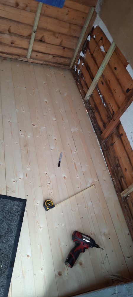

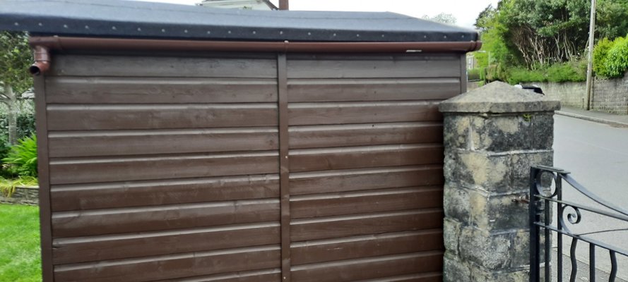

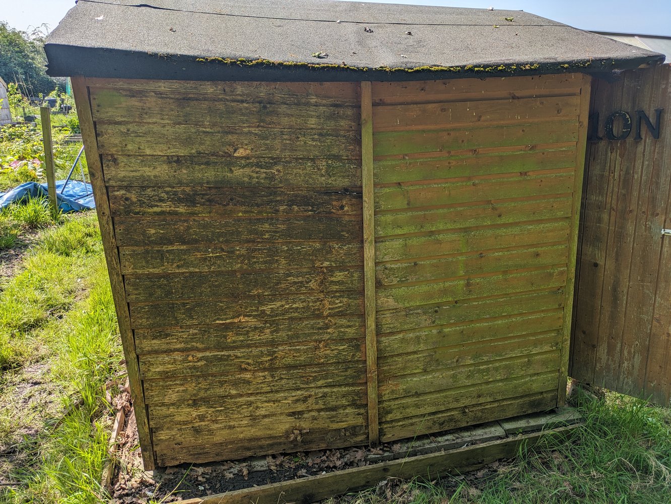

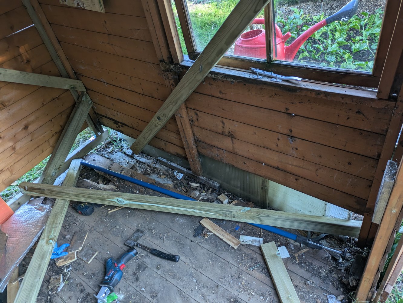

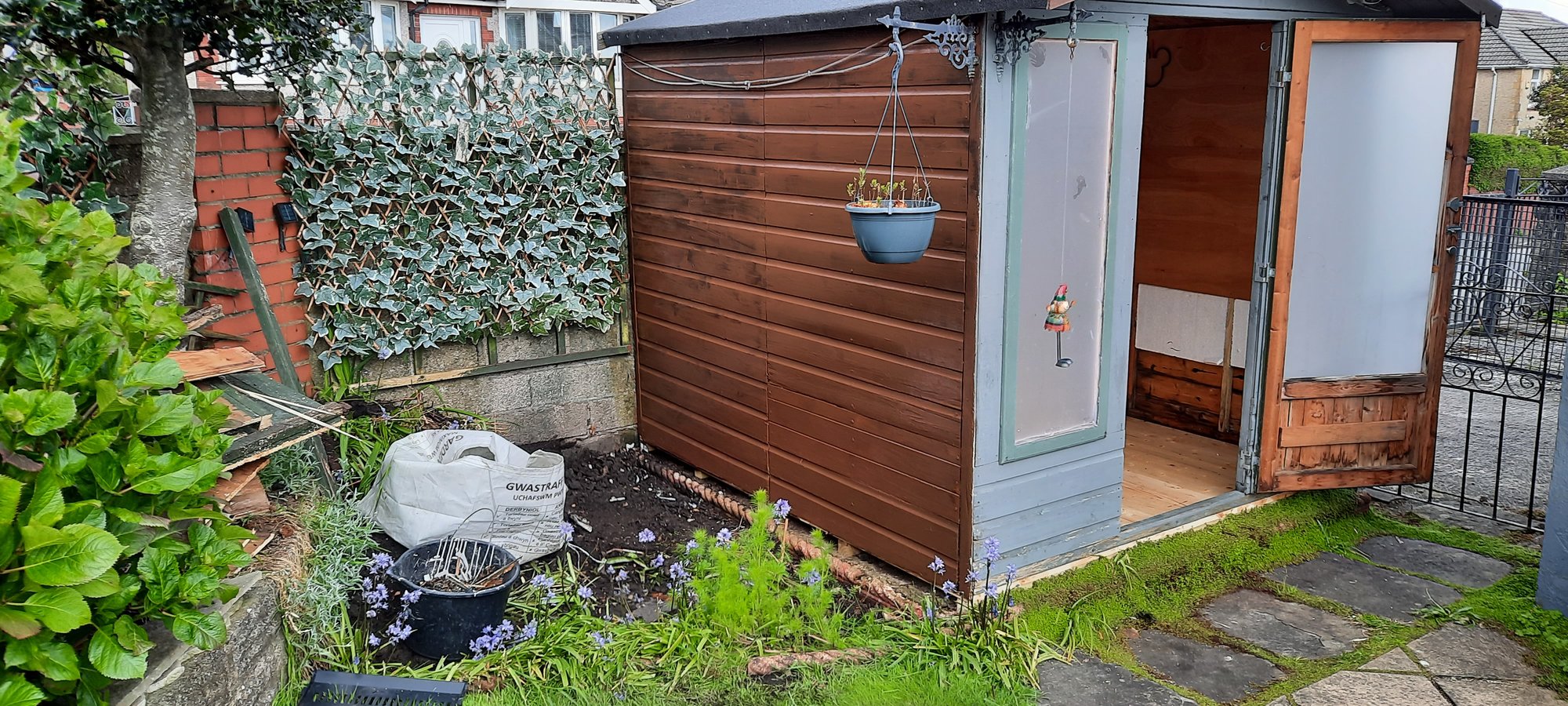

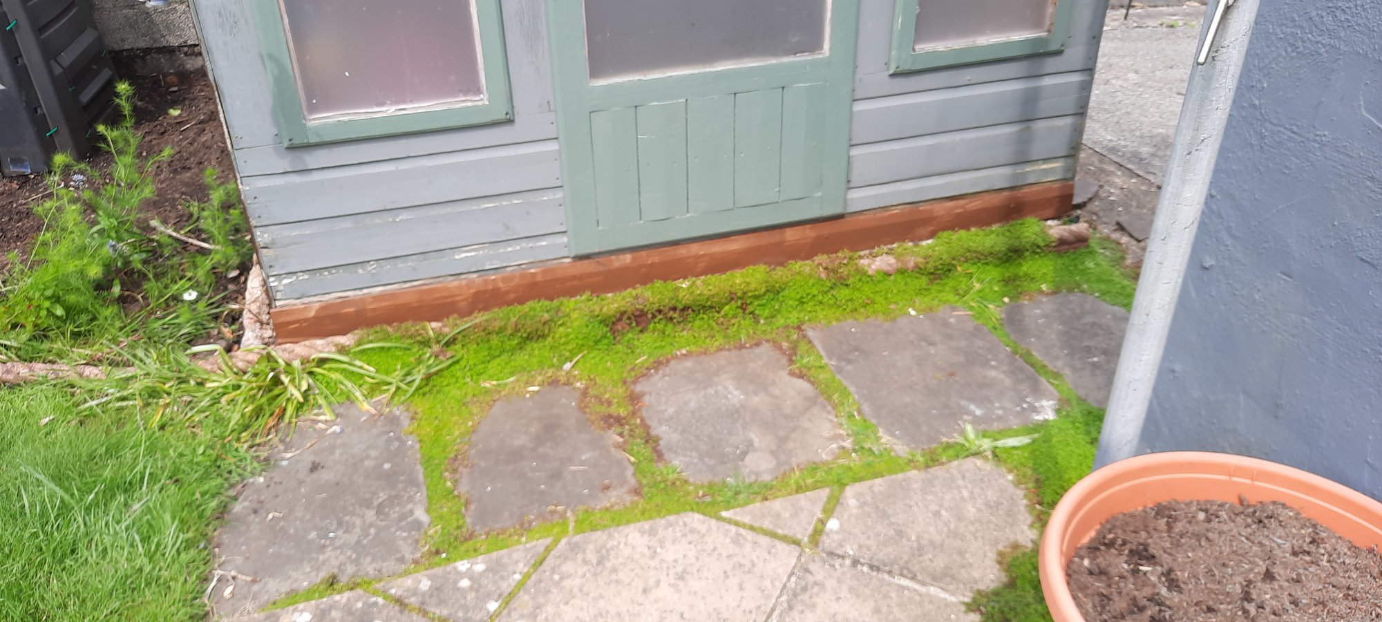

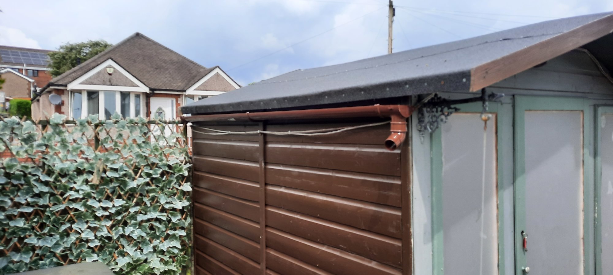

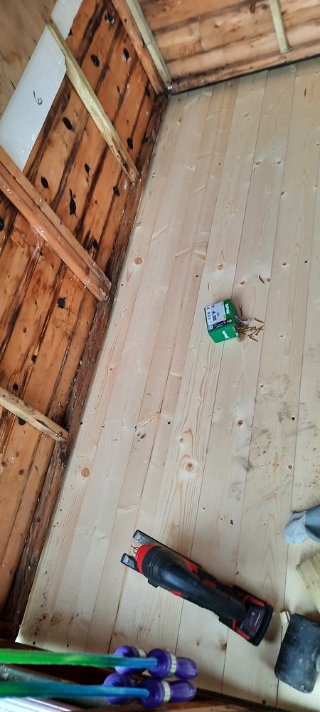

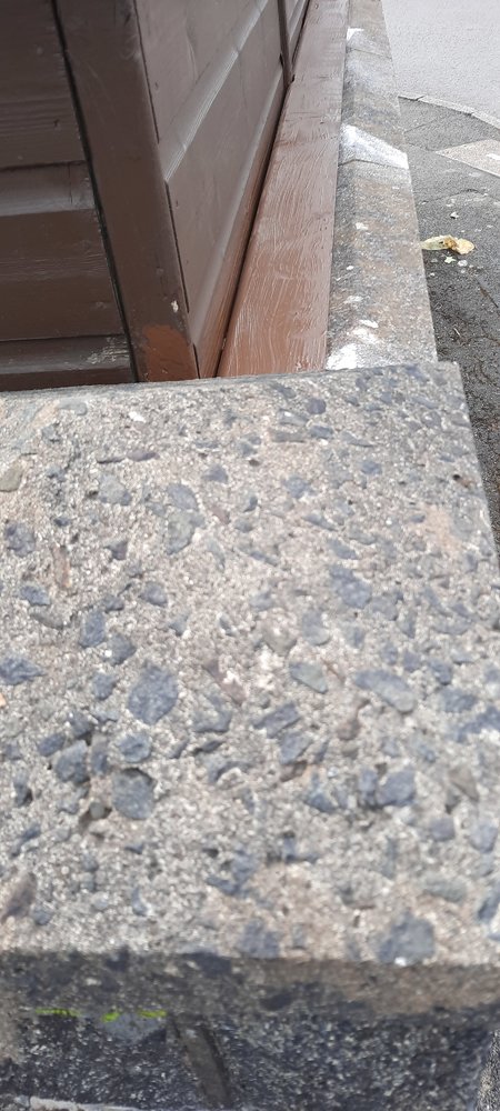

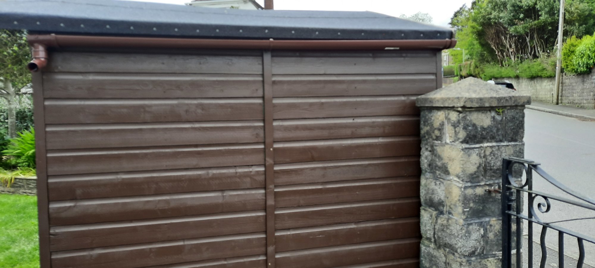

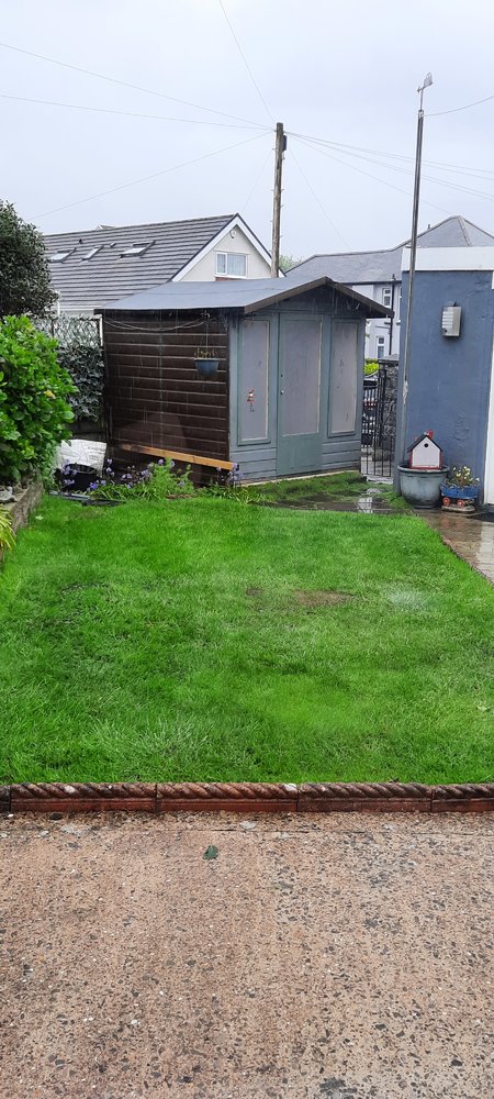

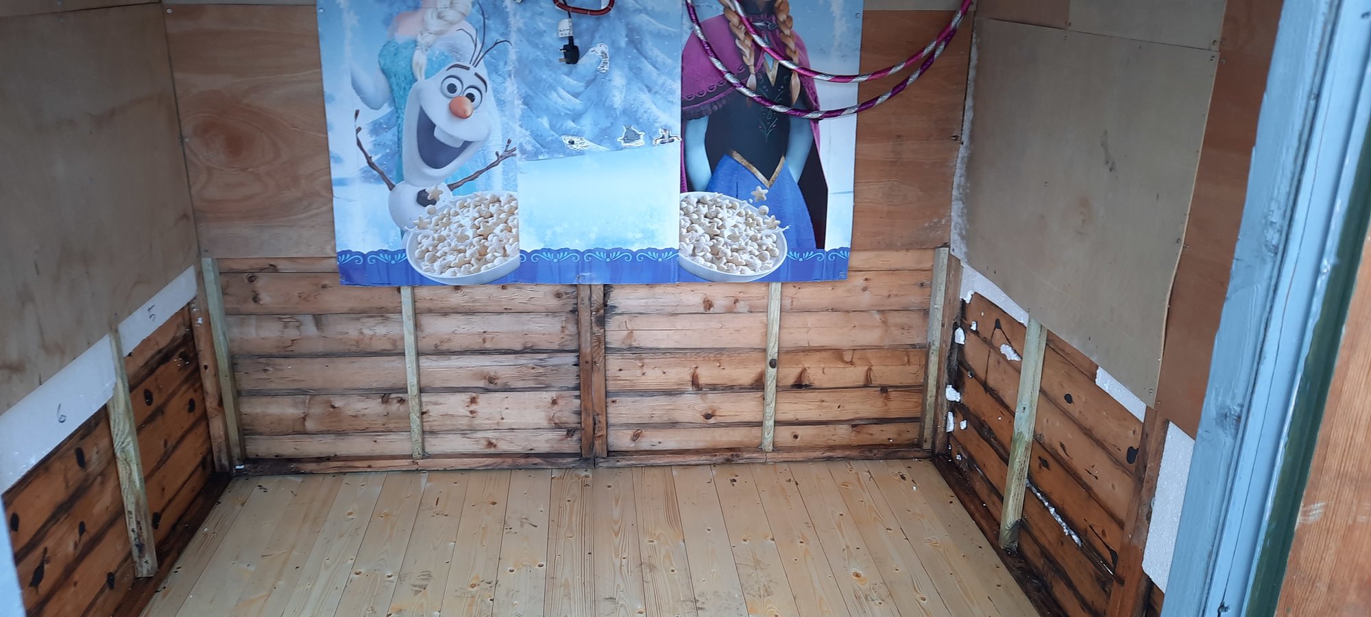

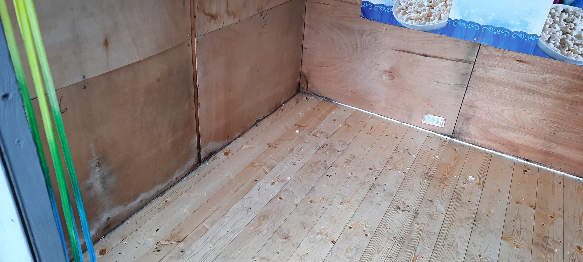

As the forum was down Sunday night, things have moved on and it's how she wants it for now. In all fairness most of the walls and roof are fine, but I've taken on the gutter idea to keep it away from the walls. I added 47x47 battens too the floor too allow a bit of through ventilation and she was adamant that it was going to have a 'proper' floor so we went with 18mm T@G which was treated before being screwed down. i had one patch to do on the wall where the cladding had broken down rather then rotted... I hope the pics say enough ! It was typical welsh weather Sunday afternoon too !
