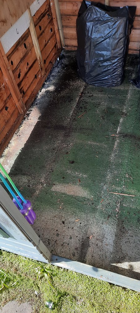

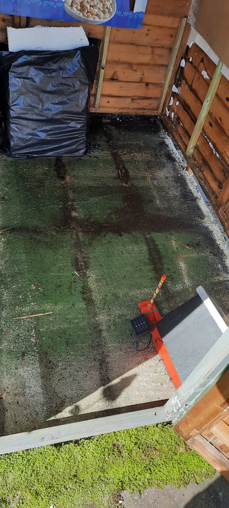

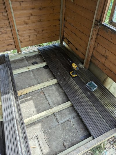

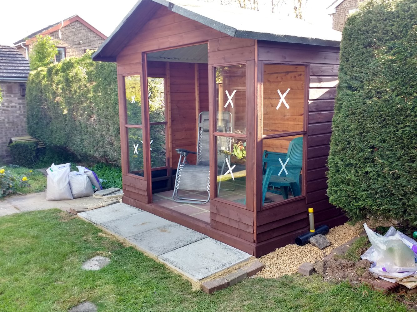

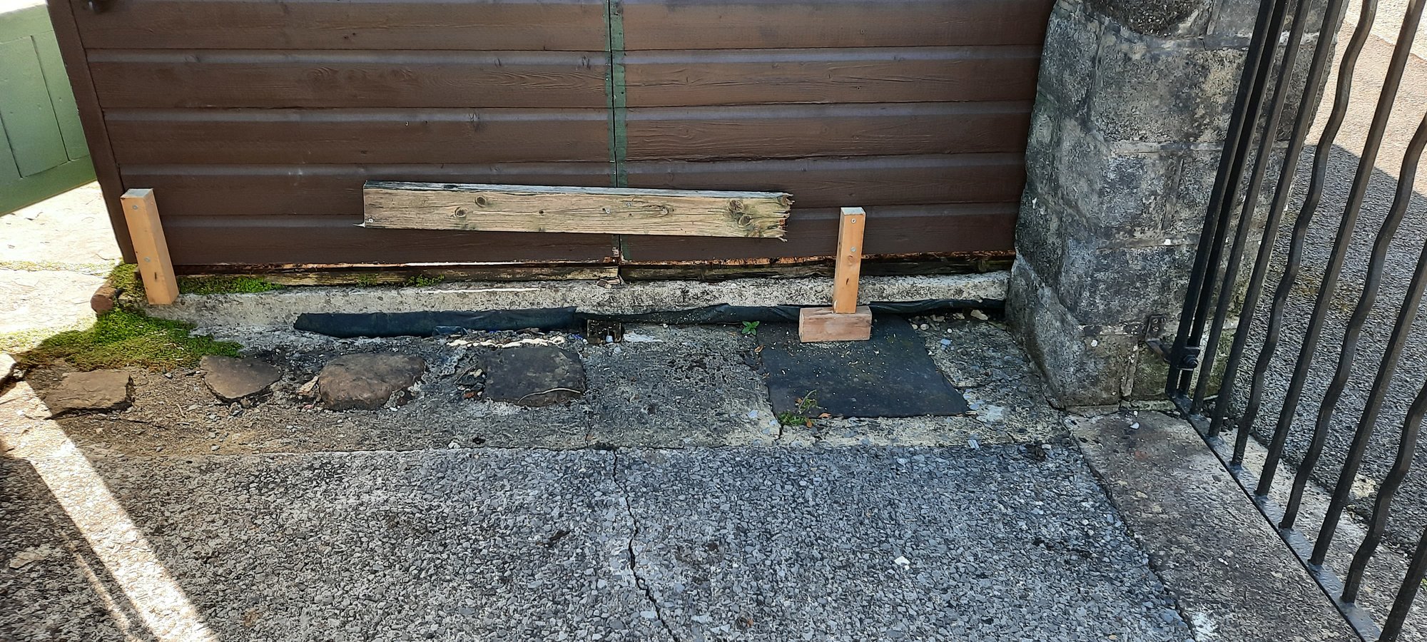

There's a gap at the rear which is going too need closing off as the dog walkers have found somewhere too dump there bags, that's the return of the pillar is there, the back wall is pretty dry, i'm think the water has been sucked up into the floor, can't remember the right name, all the walls i'm hoping will dry outthat tells me that your walls are leaking in as well
too close to the wall water can still get there so drying it out is going to be fun in itself
unless you swap to plastic 3x2s its going to rot out
Concrete base is a good start point, definitely.I put my shed on plastic decking risers. They keep the wooden base off the ground and will never rot.
They are height adjustable too and can take quite heavy loads.
They are ideal if you already have a concrete base.
for the price of the wood floor you might as well start to build it out of concrete blocks then all you need to do is get the wood for the roofIt's going to be a patch up job for sure as she agreed we would have been better of making it out of blocks as it mostly used for storage now .... maybe next years project then ? Haven't been too wickes yet![]()
