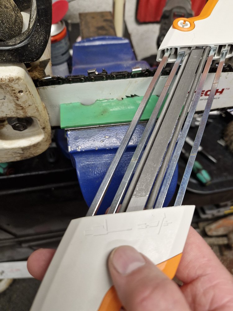

Angle grinder every time ,just have to be careful not to overdo it>In a past job we were agents for Husqvarna, Stihl, Sachs Dolmar and Oregon chain. Been on all the courses blah blah, and made literally thousands of chains off the roll.

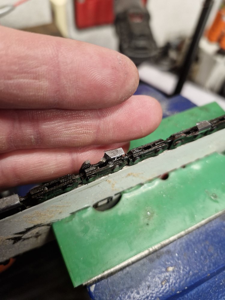

Chains are chrome plated so are hard on files so none will last long. They should be sharpened towards the cutting point, and the file should not be drawn back, but lifted off on each stroke. Angles must be about right depending on what sort of chain you have. You must try to keep the file straight, which is virtually impossible while it is mounted on the bar, especially if the bar is worn. Should also filed a little and often. That's the theory, and I have had loads of practice.
However, I can't be bothered with this for myself, and tickle mine up with an angle grinder with a rounded edged disc, or a die grinder if the compressor is on. Not good for chain life, but good enough for me with the short chains I use. If it was a big saw with a fairly expensive chain, I would make the effort ! Also got a chain sharpener machine, but I find its too much faffing about, but useful if I have hit a stone or nail (again)
