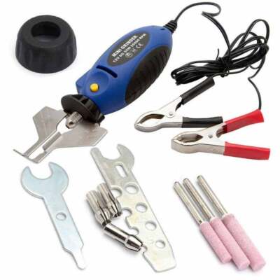

A file is ok to give a chain a tickle, after that its a grinder job. The small 12v dremmel type grinders are my go too, dont lean on the stone, use the whole length of the stone and you would be very surprised as to how economical they are.
