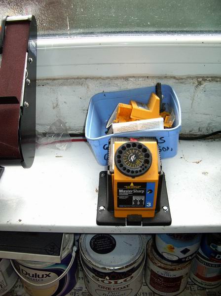

anyone tried this style of attachment ,,,,,i'm reasonable at hand grinding but even the best i know still get the odd bad one .....and as my eyesight is getting worse............http://www.machinemart.co.uk/shop/product/details/dga1-drill-grinding-attachment
similar to end/slot mill attachments but is it any good for drills ?........anybody used or got one?.........sams and robots, are like the ones i've used before did a reasonable job but have special stones and lots of bits ,,,,,do they cope with th imperial and metric sizes easily?......bigger drills are easy enuff its 5mm down i struggle with depending on lighting and if i got my glasses and my patience

This type of drill grinding attachment is better than hand grinding cos as at least you end up with the same length & angle on both sides of the drill, but they are very fiddely to use, the grinding wheel needs truing often & you cant thin the point. (req'd for acurate holes & less effort)
Use a Drill Doctor cheapest from -
http://www.northerntooluk.com/products.asp?subcategory=Sharpeners&category=Power+Tool+Accessories
They start @ £100, worth twice as much !! will do all twist drills - hss, cobalt, carbide masonary. 118 + 135 & point thining. Uses dimond wheel, I'v sharpend 100s of drills upto 3/4" (I'v got a big one) with original wheel, perfect each time, paid for its self in a few mths.
