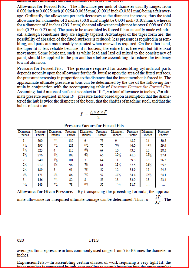

Can anyone remember how to determine the necessary tolerance to get a nice tight interference fit on a 60mm shaft and hole in EN8. Usually I leave a few thou and using the oven and freezer the jobs a good un.
This job is going to get some stick so it needs to be as tight as I can make it using a twenty tonne press.
Your right I forgot they were catered for in the Zeus Book. Thanks chaps.
