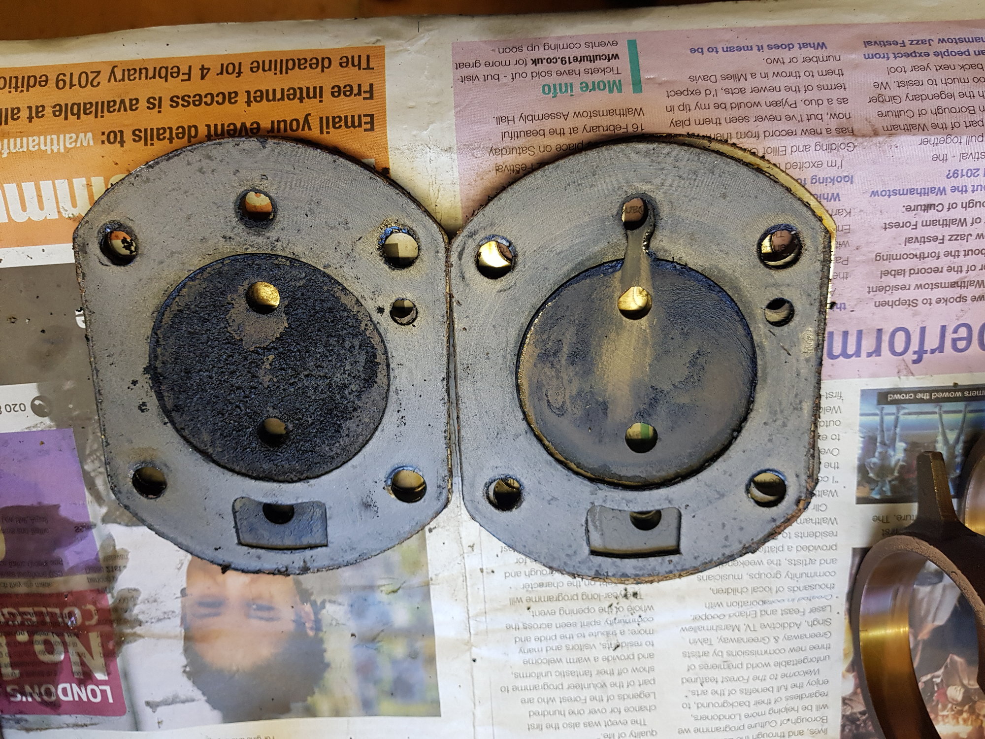

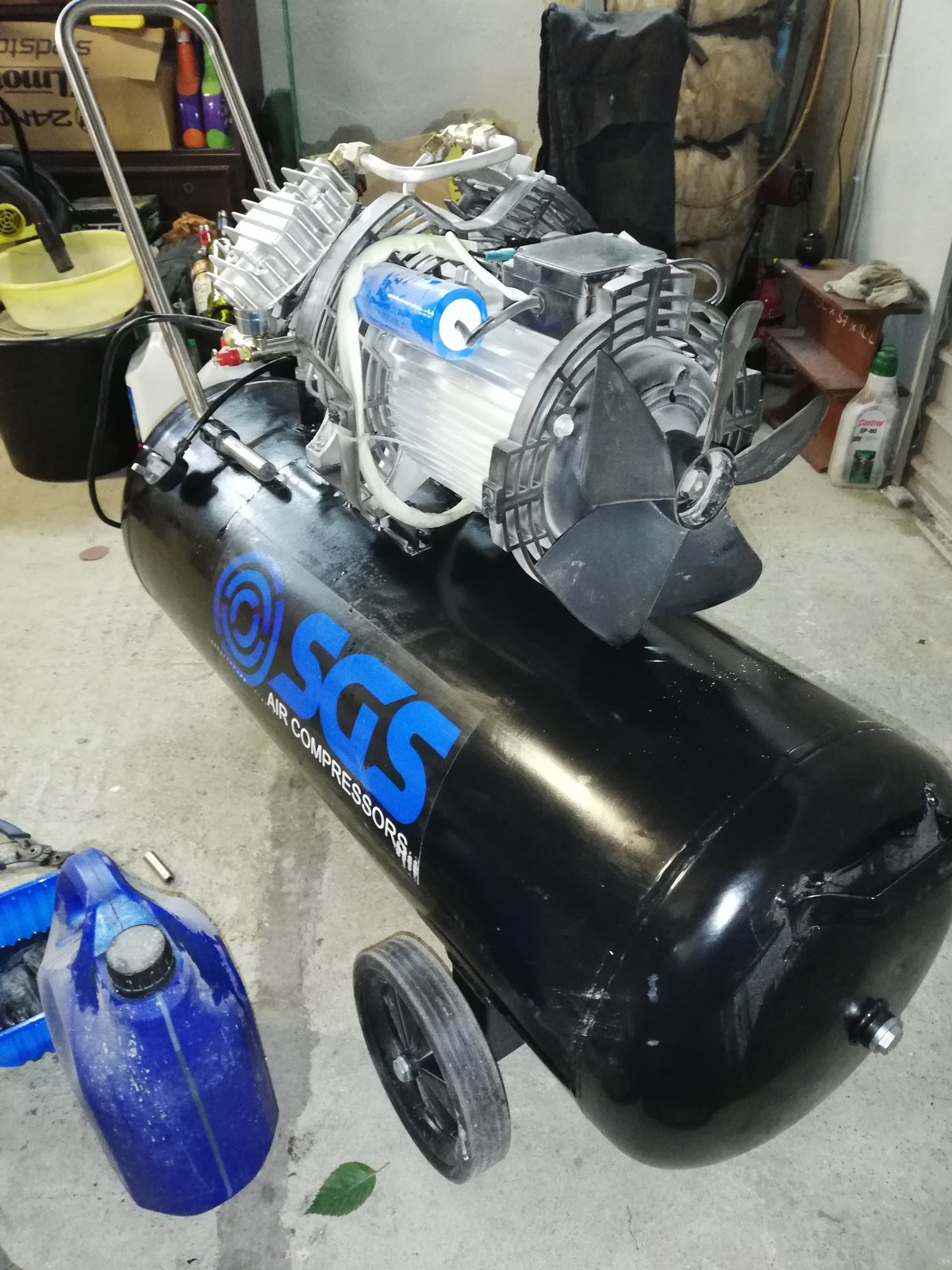

Hi folks.... been having problems with my compressor. Bought from UK company SGS Engineering, inside of warranty but the cost of sending it back from deepest darkest Eire would be prohibitive.

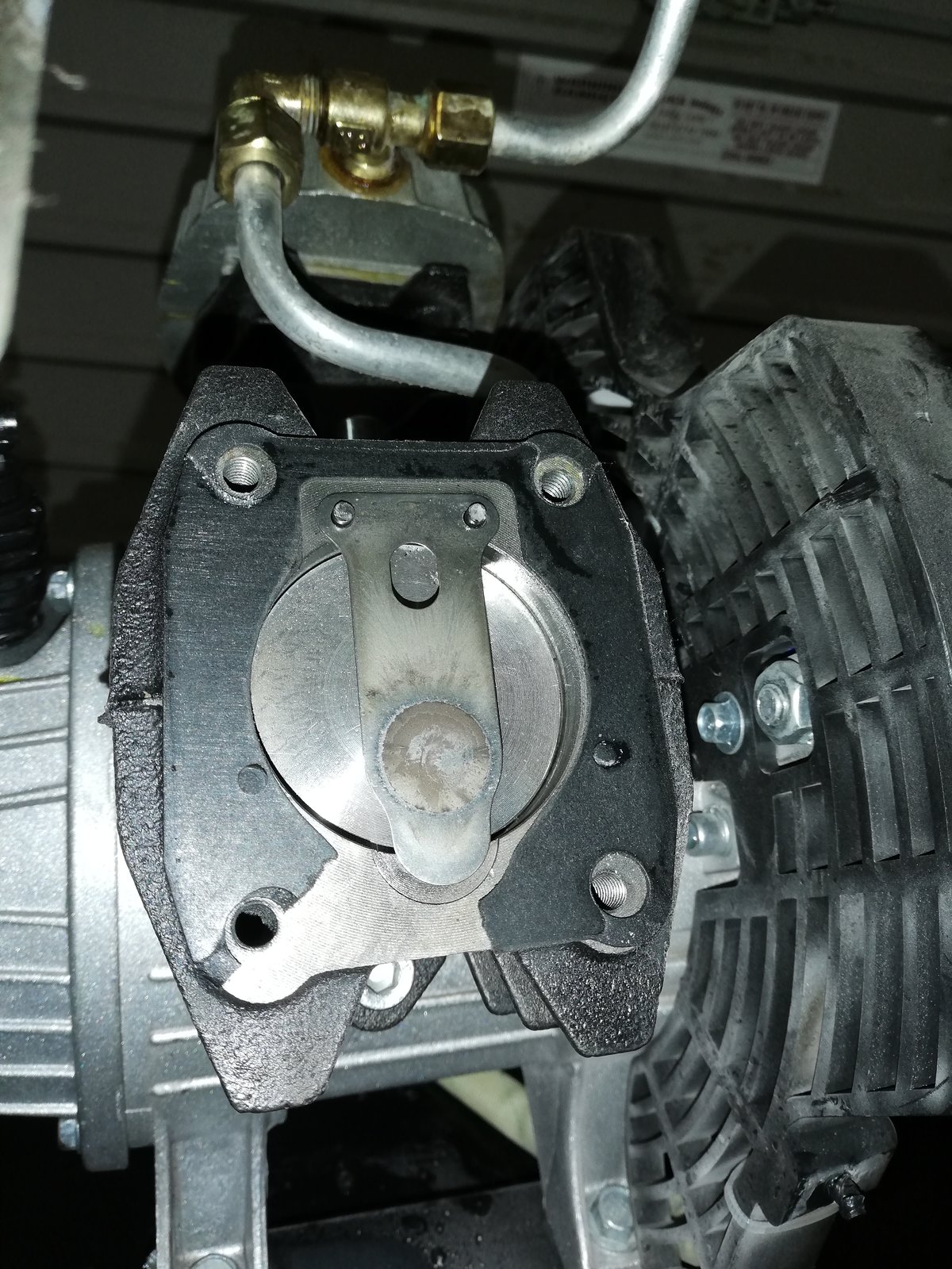

Anyways, it's been taking longer and longer to reach pressure and shutoff, so I had a look-see. Turned out 3 head bolts were a little loose. Tightened to no avail so opened her up. (I could feel the hot rush of air but had suspected it was from the fan but no).
So gasket is breached....
The offending article...
....the offending gasket....
Anyone else had similar? Any suggestions? I'm going to contact SGS obviously...
