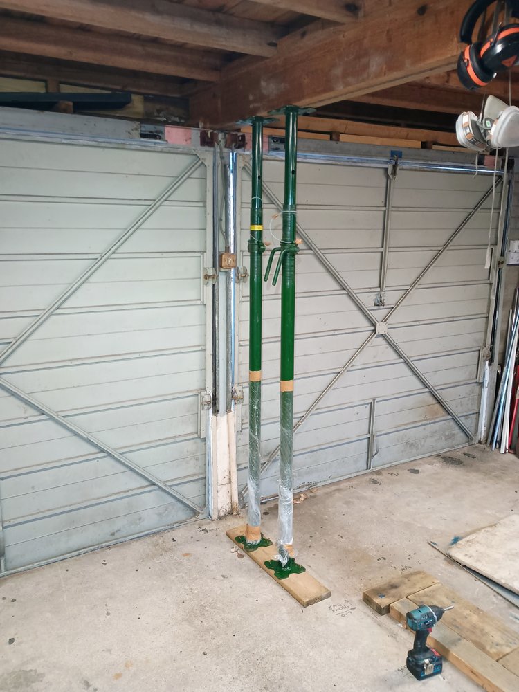

1 is ample enough 2 just is a bit better supporting
but id rather use 2 as better support make sure you tie the acrows to the center beam as you will lift therefore loosening the other acrow its just there as extra support as a just incase you catch the other knocking it out by accident
