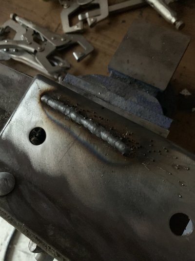

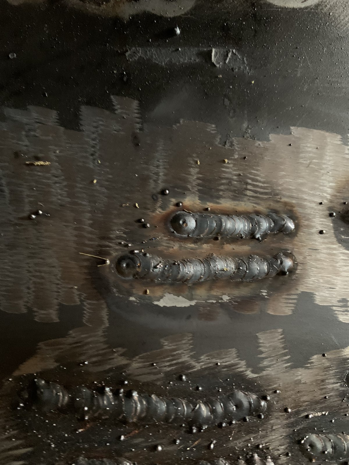

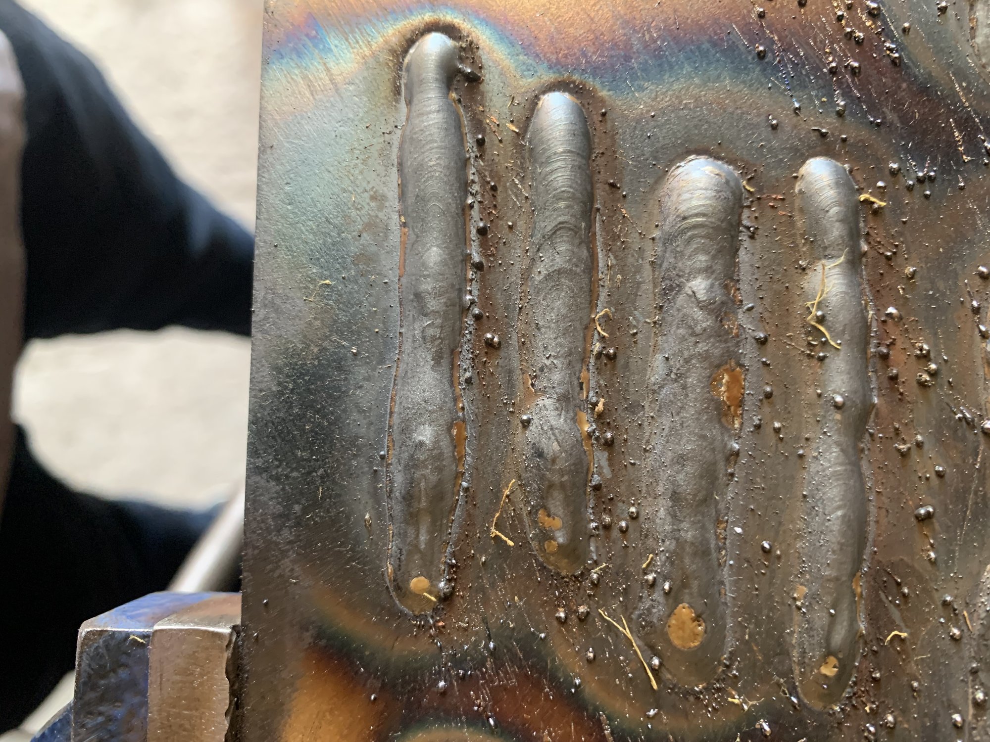

    Hi guys,
    this is my second attempt. I.bought some 3mm from eBay this is actually 2mm. Can someone critique these welds for me and tell me what i should look out for? I feel like they are ok and I’m ready to start sticking bits together. Thanks guys,
    Alex

    That looks pretty good to me for a second attempt. You'll get a better feeling for travel speed and penetration once you start trying to stick things together.
    I would steer well clear of buying small quantities of metals online if at all possible. The pricing for most of it is astronomical. Get yourself to a steel stockholder and ask them to cut up the biggest piece of 3mm sheet you can affort. Hours of practice on good clean steel without paying inflated prices.

    Not sure what you are using in terms of welding process wire, gas,settings but
    If using gas mig: The amount of splatter suggests you may have the wire speed a bit high

    Thanks that’s great. I’m having to move quicker than I thought I was going to have to to stop the sheet from burning through. I’m practicing so that I can do some car body repairs. So will try sticking some of these bits together and then when I get a feel for speed and what I should be looking for, I’ll move on to the car. Thanks, this is a great forum!

    Yep using gas mig. 0.8 wire and argon and c02. I kind of cheated and got a synergic welder so I’ll just creep down the wire speed a little and hopefully reduce some of the spatter. Thanks guys.

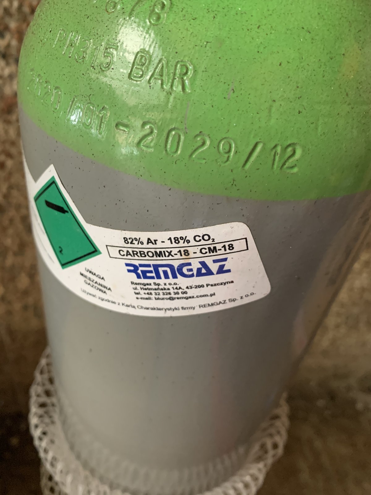

    the c02 is the reason you have lots of splatter is it not a mix gas?
    i use pure co2 but dont realy do thin stuff its rare i can do it but its way harder

    Sorry yeah it’s an argon Co2 mix. I started on some really thin sheet just doing the thin metal technique and then just to get a feel for welding it was suggested I should buy some 3mm, when I’ve got the hang of sticking them together I’ll move back to 1mm stuff but just wanted to get a feel for welding to start with really.

    That's very very hot and wet. I'd keep the wire speed high and turn the voltage down, possibly wire speed too.
    Having said that, it's quite a heavy gas mix, would be less spatter on a 5% CO2 mix, but it will be fine anyway.
    You need to run joints :)

    Or maybe not quite enough gas coming through.
    I generally tend to think of brown, sooty welds being a gas issue.
    It is quite spattery, though - but there may be a bit too much wire going in there too, I suspect.
    Seems it is a mixed gas.
    You may just need to turn the flow up slightly, or shield the area with something, if there are draughts about.
    1mm usually seems fairly easy to butt weld at the bench - it's just when you start doing it on a car that it becomes tricky!

    Yeah, I didn't notice that 82/18 mix, there!
    It'll be much spittier than argoshield light.

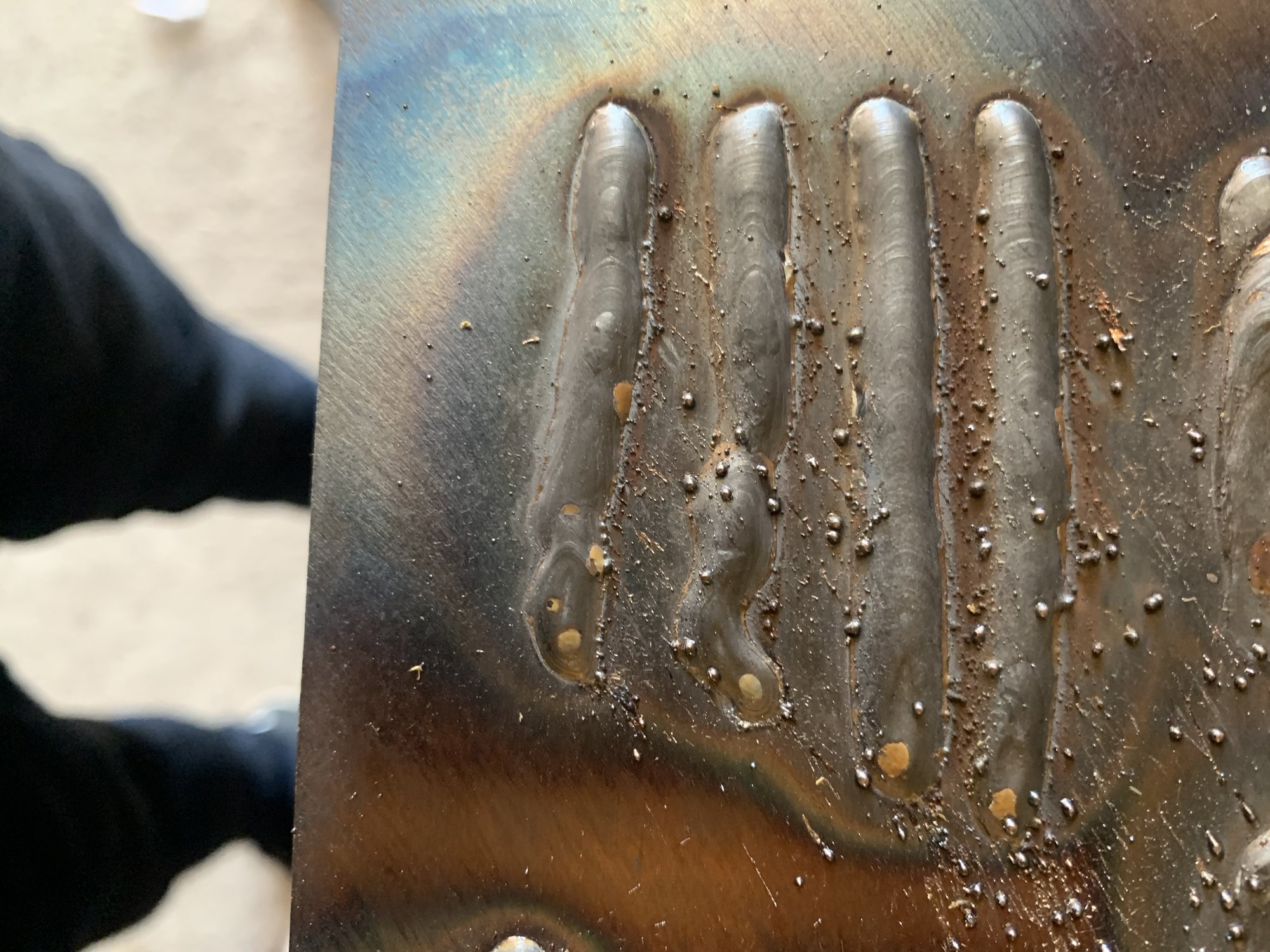

    Thanks guys, so basically too high a voltage and possibly too high on the wire speed? I’ll turn the voltage down a lot lower, gas up a bit higher and leave wire speed to see then post some pics and see what you guys think if that’s ok? Thanks so much guys it’s so very appreciated.

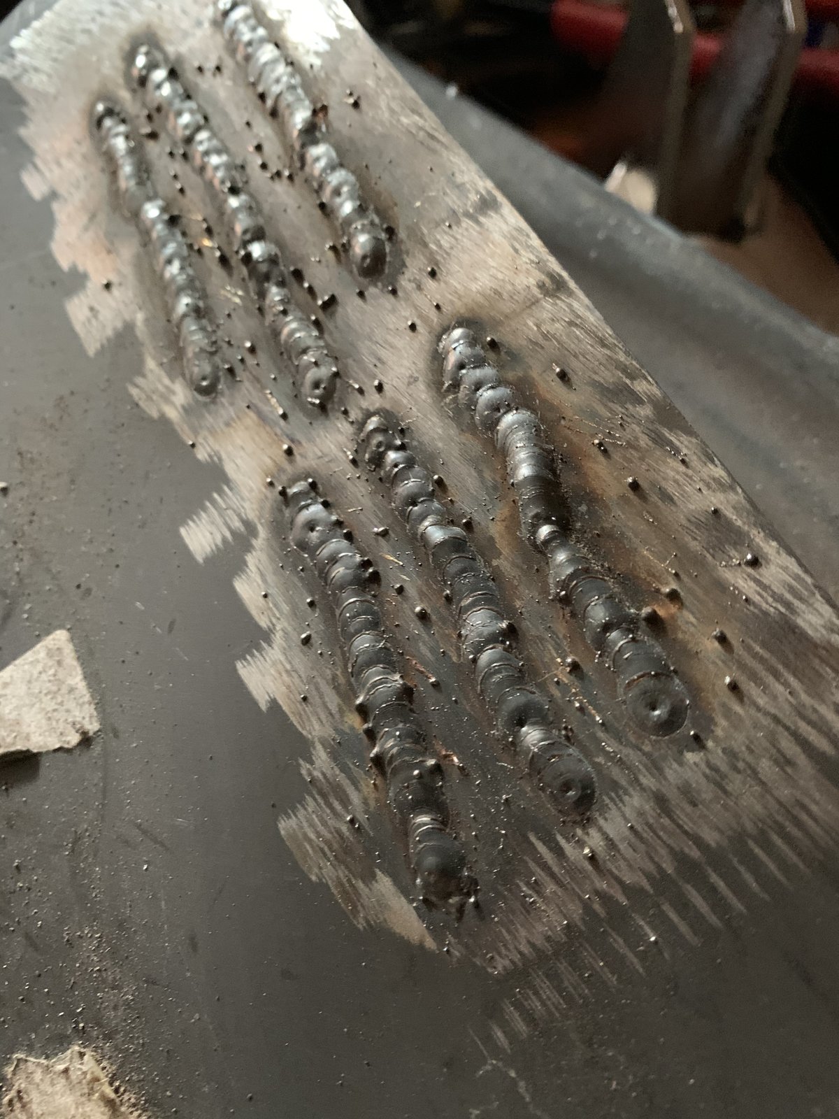

    personally i'd be going to the scrappy and getting hold of some old panels

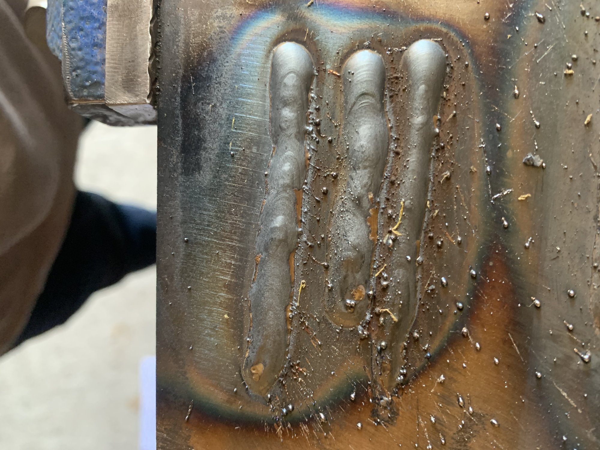

    Yeah that’s kinda what I thought. This was my attempt at 1mm

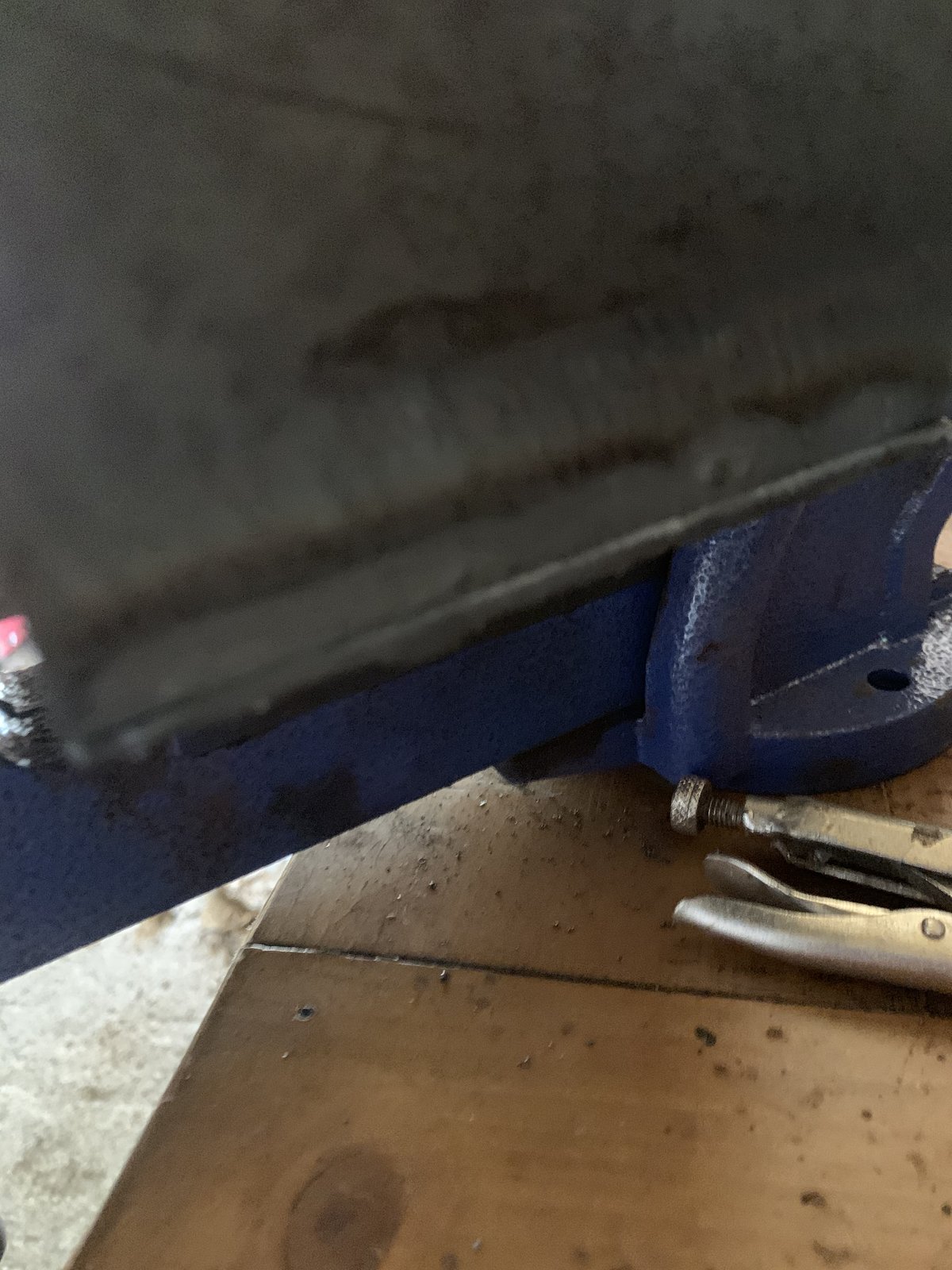

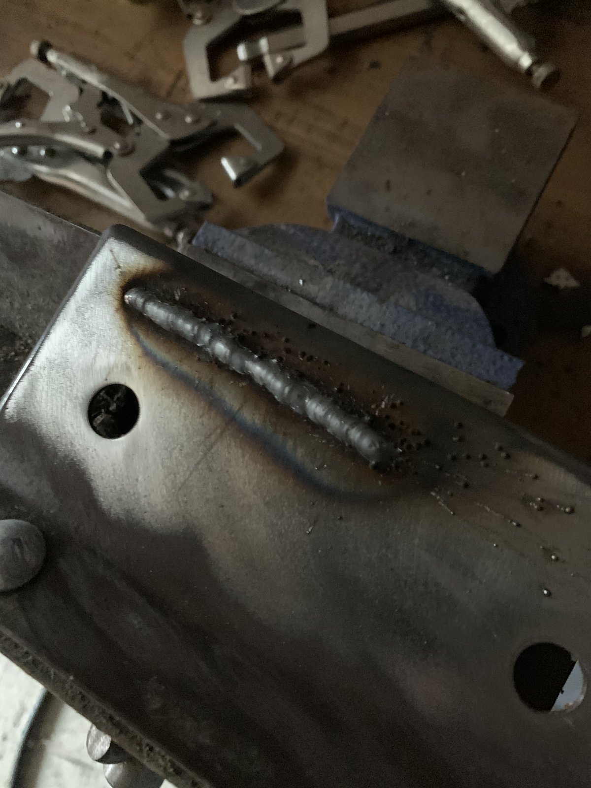

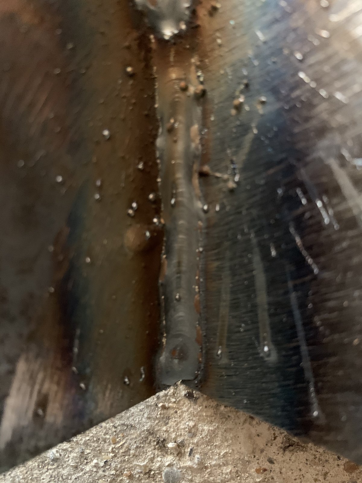

    Ok got two bits together. Guessing bolts too low though as no penetration at the back? Bolts were 19.1 wire speed was 4.4m/s?
    thanks guys

    Can't see too much in the first photo.
    The second makes it look as if you were welding vertically upwards - if so, you'll find it easier in a flat (i.e. horizontal) position.
    Still looks like not quite enough gas (the brown, sooty stains), but some of the spatter could be down to the "heavy" gas mix you're using - it does vaguely resemble straight co2.
    Having said that, it's got a fairly consistent profile, so travel speed is quite constant.
    Regarding the spatter - are you holding a particularly long (or even a very short) arc?
    I wouldn't know the volts & wire-feed speed on (assuming 3mm steel?) that thickness would be, without looking at the display while welding - and I think it changes constantly, so I'd only get a "snapshot" of the parameters as they were at the very end of the weld.
    I could go down & find out for comparison, if you want - but I think it changes with arc length, and probably measures a few other variables, too.
    Every welder seems to have it's "sweet-spot" where the spatter is minimal, penetration is good, and the weld profile generally follows - but repeating the same setting another time can be a challenge.
    This is especially true on some welders more than others, though.
    I had a SIP MigMate for quite a few years, and you couldn't expect to replicate a weld from one minute to the next - but when you eventually fould the "sweet-spot" it'd be ok, but usually only for a few minutes - and you'd be back in that first cycle of "constant adjustment" again!
    I'm sure yours won't be such a nightmare, though!
    I'm now hoping you don't have a MigMate, and I've missed this info, earlier in the thread!
    What welder is it, out of interest?
