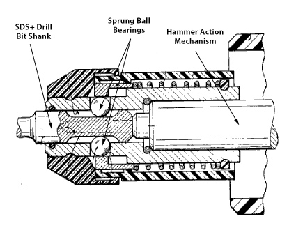

    Is it possible to get SDS bits, think my drill is SDS plus, that will drill into metal; I've had no luck finding them before.
    My only drill is SDS, and I can't afford to buy another at present. I've had a chuck adapter for a number of years, but it adds a little bit of a wobble to the drill and as I expect to be drilling some 3mm steel soon I might put too much strain on that if I have to use the adapter.
    Any suggestions? Thanks all.

    Mostly the connection between the chuck and the SDS chuck seems to wobble some, and I'm concerned about breaking the drill, pushing it through steel. It's lasted for a good few years now, but normally only use the chuck adapter for wood.

    It will wobble the point of the sds connection is not allows the bit to move for the hammer action. SDS_1.jpg

    I reckon your chuck will be just fine for drilling 3mm steel. When drilling by hand a bit of runout or chuck wobble is the least of your worries really.
