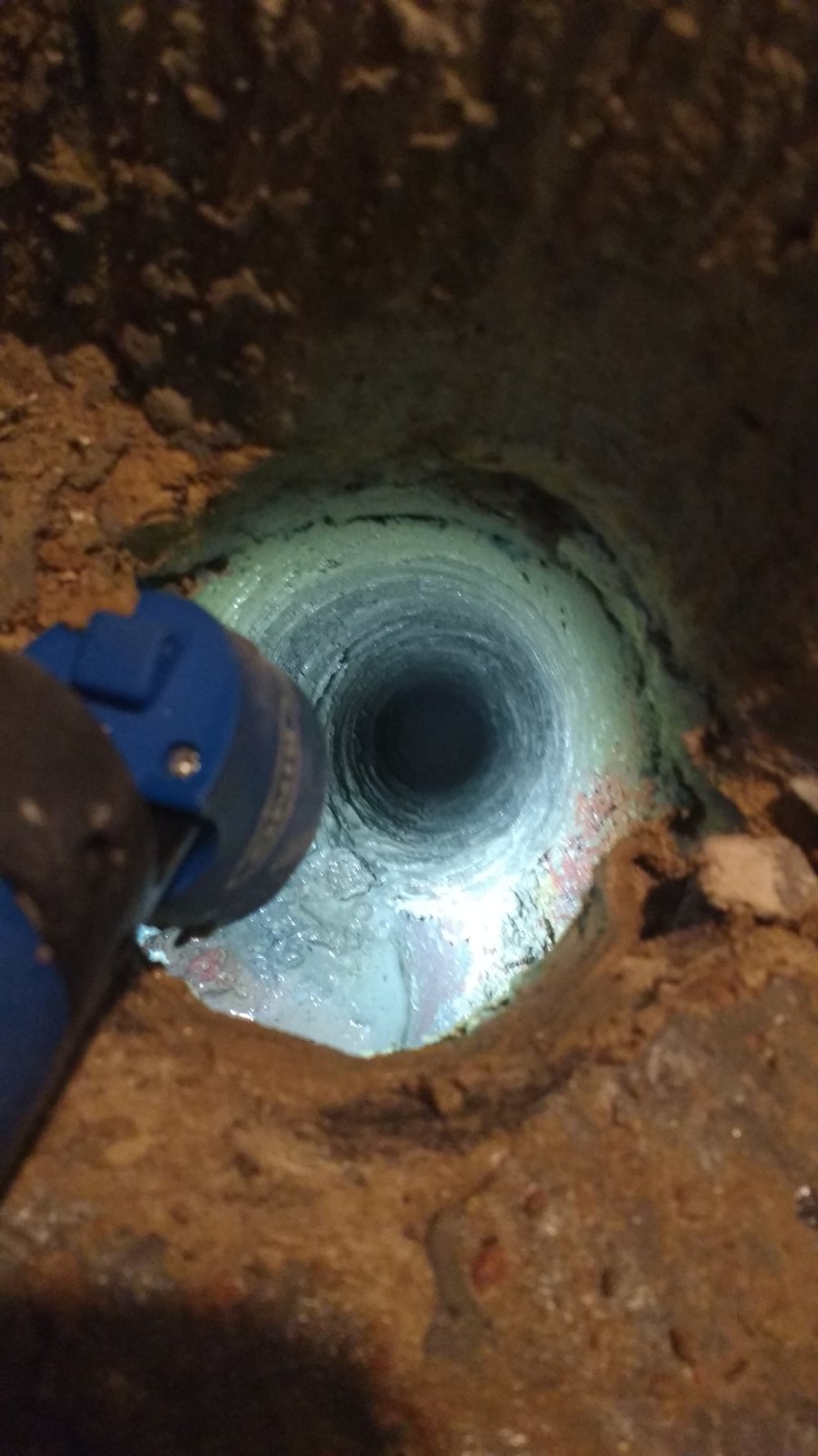

Erm...these were from Toolstation I seem to remember. Set of 3.
That's the 16 and 24 knackered now!
Good job. Looking at the hole I can't see why that was such a bastid to drill

Mole grips to locate a bit of bolt in the grove on the SDS drill bit , clean out the hammer head , put hammer head on the drill , clip the bolt bit & moles on the drill use hammer head as a gentle slide hammer . A bit of water running in the hole as you use the slide hammer might also help to get it movingNo. Did cross my mind. There is though nothing for the "hammer" to slide up against.

In a long hole where it's already damp/wet it's worth washing out the muck and dust with water even to the extent of trickling water into the hole to keep the dust as a watery slurry , keep bringing the drill out the hole with slurry on it and wash it off before putting it back in the hole .Live and learn. Bought the 1m bits years ago but not used them. I've never, either, drilled through solid concrete at this depth.
Pretty sure I've used masonry bits before going up in small size jumps but that was likely only through lightweight block walls.

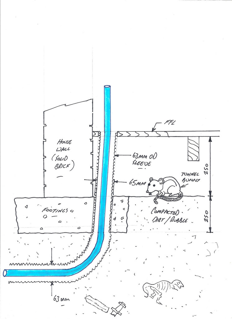

I had a similar job putting in a new entry for a new domestic water supply in our self modernised bungalow & a heavy below the ground STWA cable into the garage ( but no stuck SDS drill games ).
I know nothing, as someone from Barcelona said
I did mine. Luckily only thin strip foundations where I had to go through. That was hard though. I even did a drawing:
