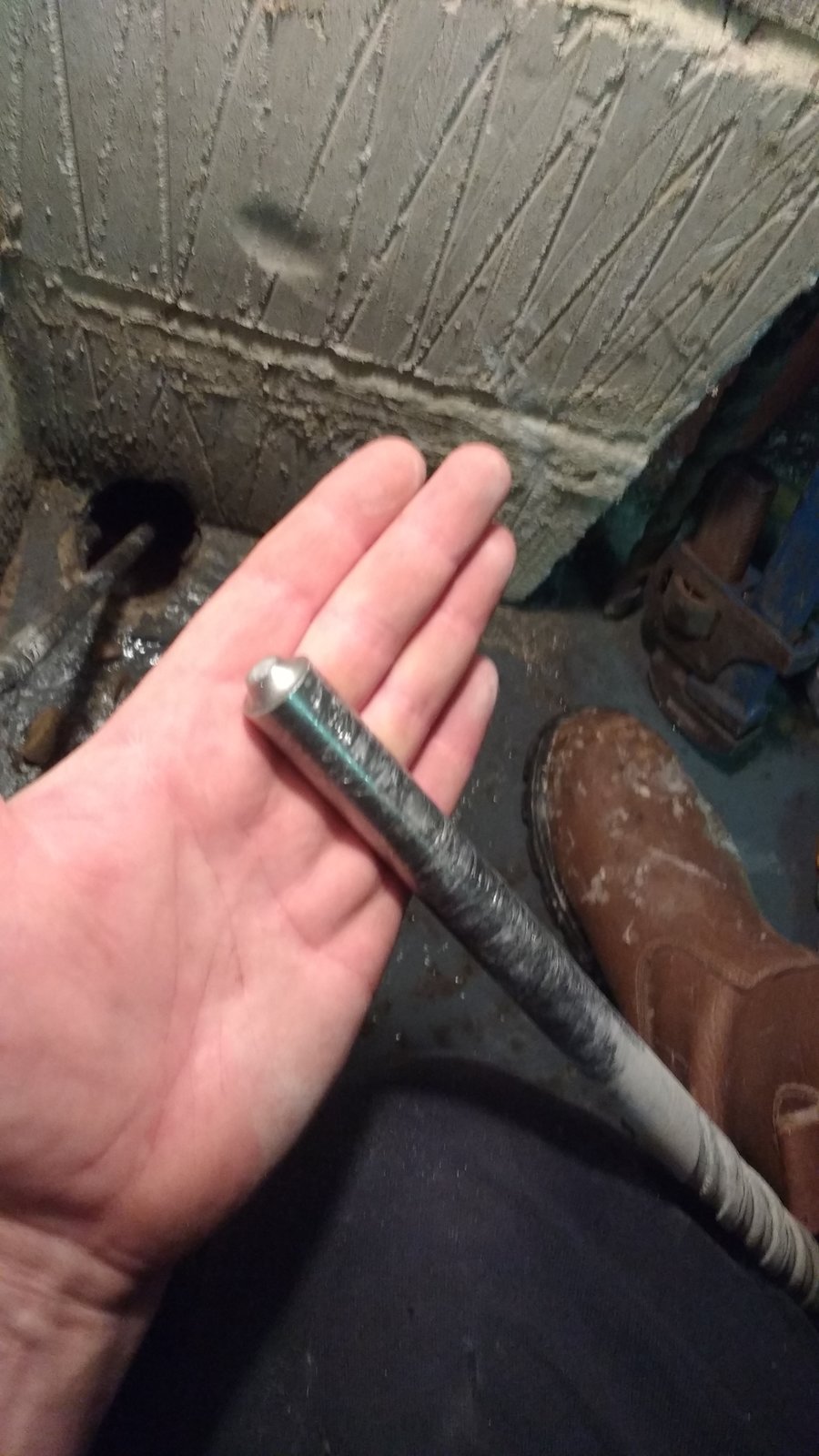

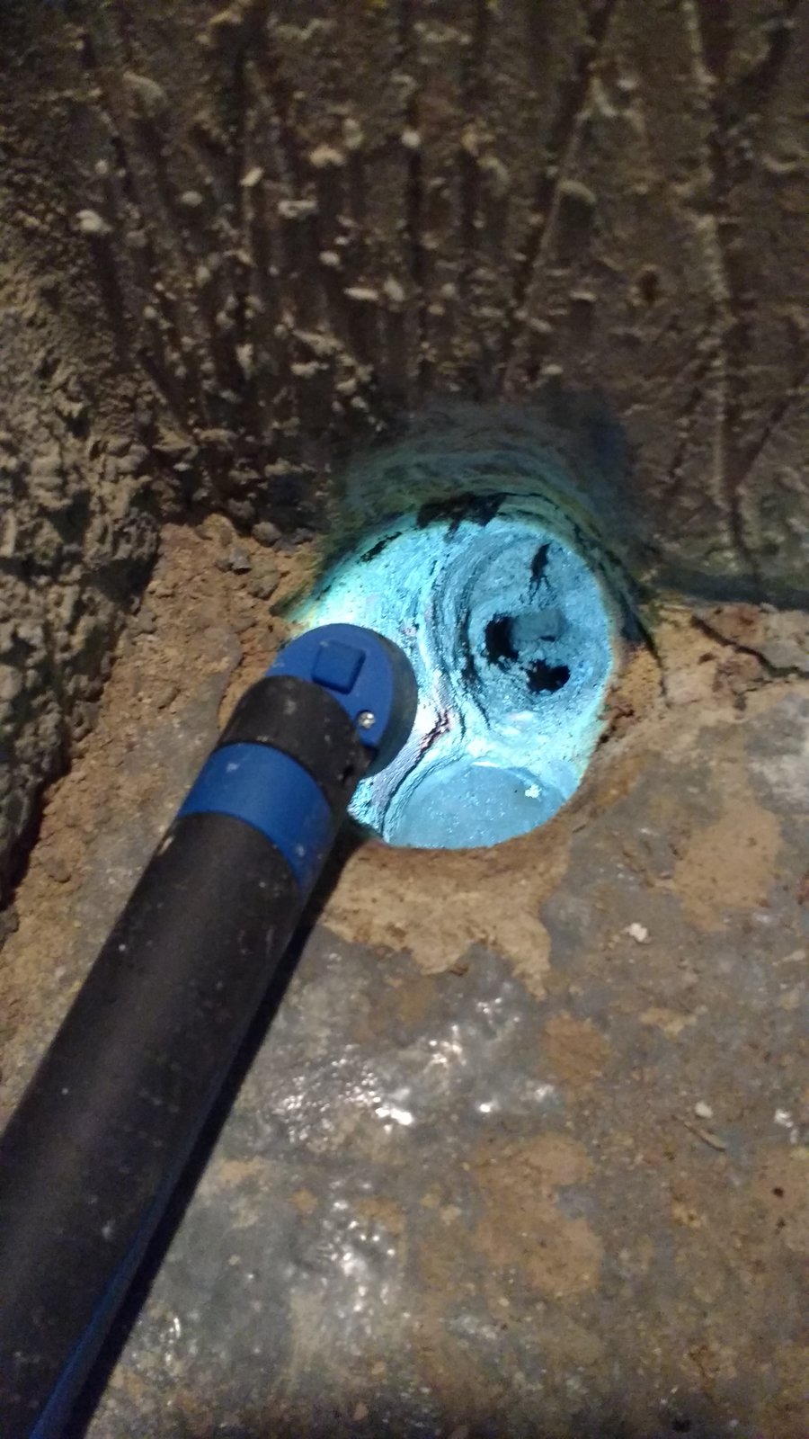

What about welding a plate on the drill bit and jamming a bottle jack where the drill bit goes into the floor, jack it out.
Nice excuse to buy a portapower then.That's not a bad shout. Pity I've lent my one and only bottle jack out!
I think so.Maybe time to come from the other side.
First rule of hammers, try a bigger hammer. The adjustables wouldnt stay on if I were swinging it.
given the amount of time you have used trying to get this out, might it be a good idea to cut it off as low as you can, fill the hole with cement and start a new hole a bit to the right?

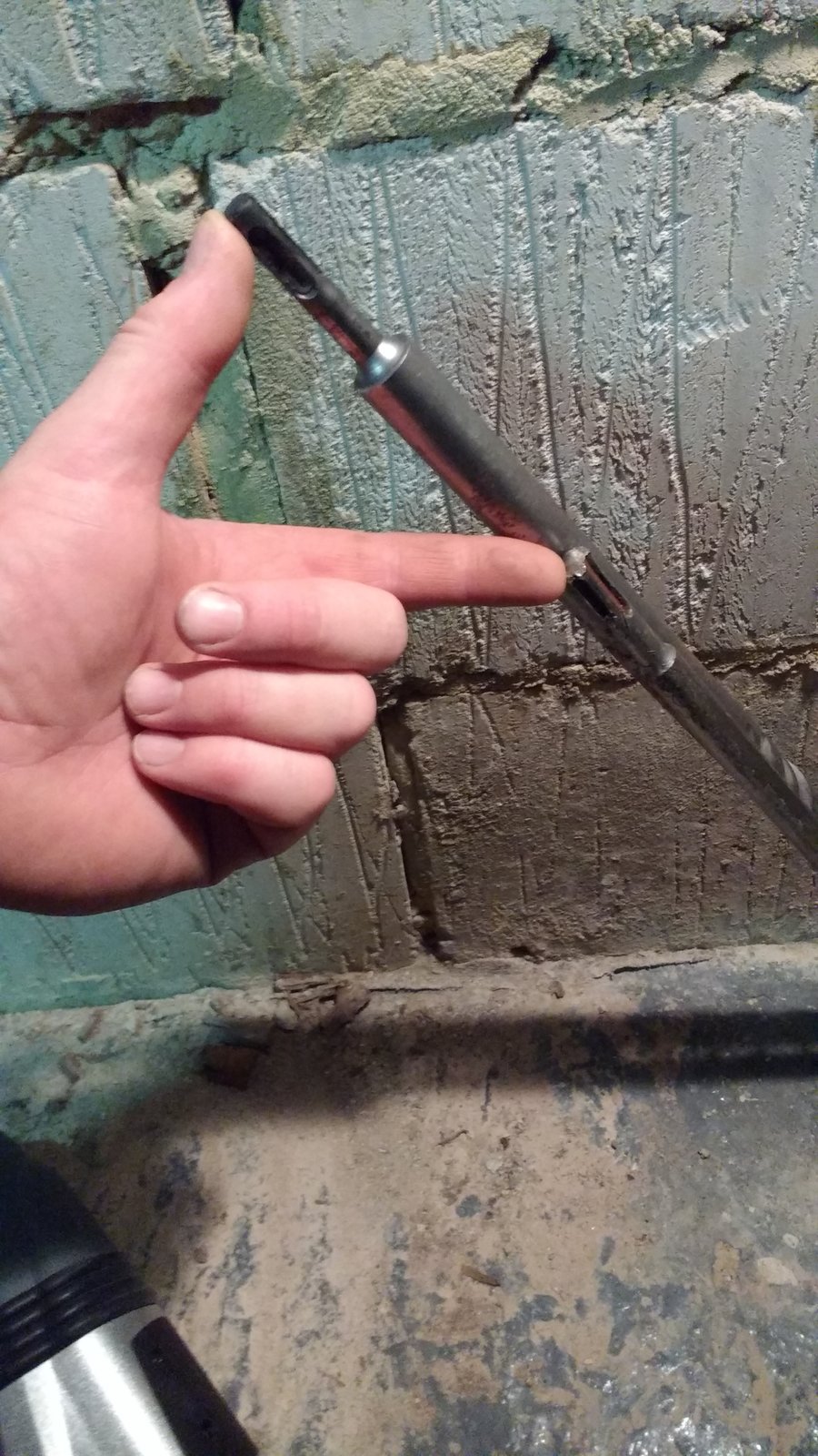

ooof, not seen that happen for a while (sheared off M16 SDS Max using Hilti Cordless SDS MAX that was way too powerful for that size of drill bit )
cant you just cut it off flush with the concrete and use the new hole that youve drilled beside it
ah ,, sorry ,,, have you oxy acet handy , you could bend a 90 on it to get some purchase for twisting or pulling , even a chain block and a simple frame may get you a good pull , and use the long end on the 90 for a wiggle , bung a pipe on it for a bit more leverage if neededNo. I want a 63mm duct through there.
put a squirt of washing up liquid down the flutes of the drill and a kettle of boiling water first too, then let it cool and give it a go ,, may as well have everything you can working for you as against youPipe / leverage is worth a go. Got some thick wall tube here.
