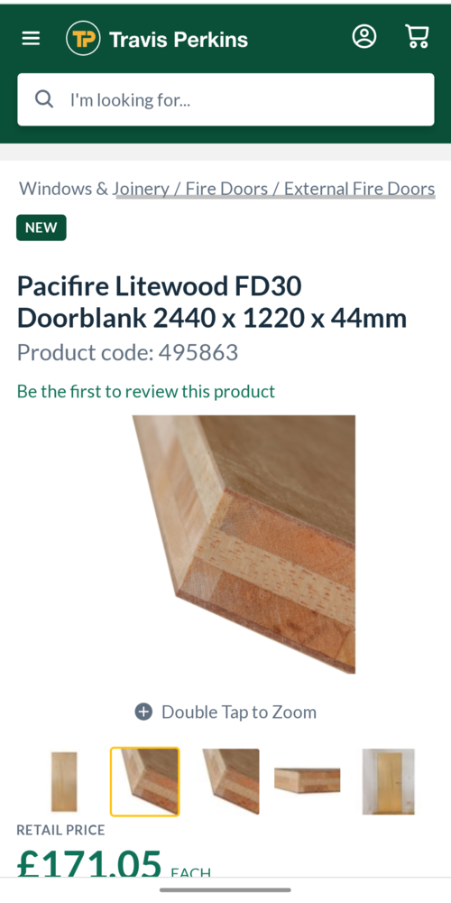

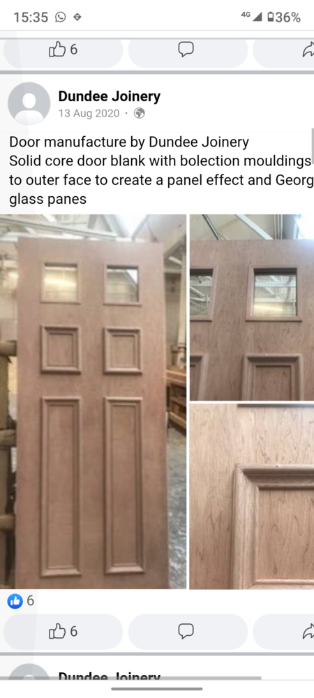

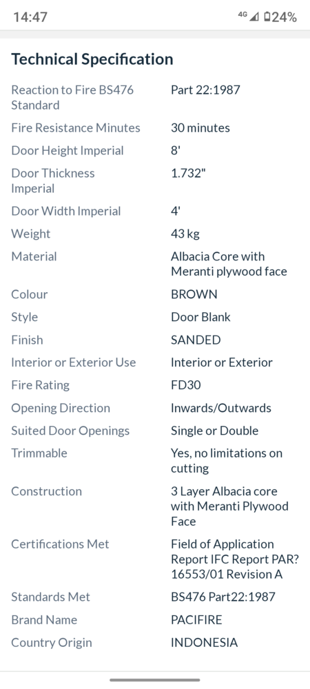

There are lots of joinery shops who will make you a new door….wont be cheap but will fit. If you have an account at any of the builders merchants they will be able to get it done for you.Looks pricey, but I'll ask them for a quote.
^^^^This, I dont think the internal will look as tidy as the picture shows but stand to be corrected!your finish is going to depend a lot on the quality of the block core which can be dubious at times
