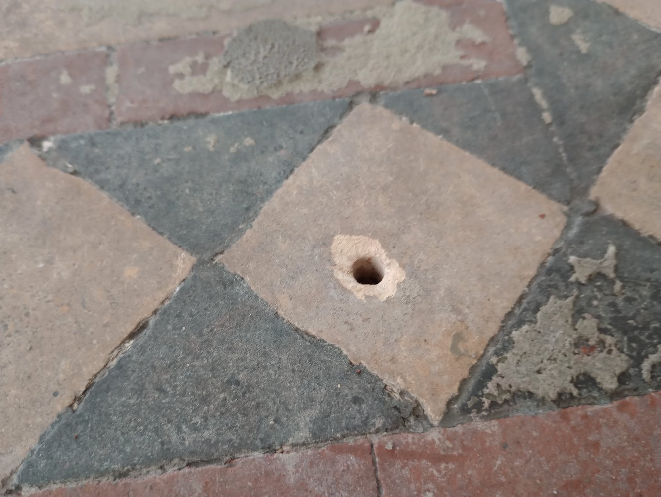

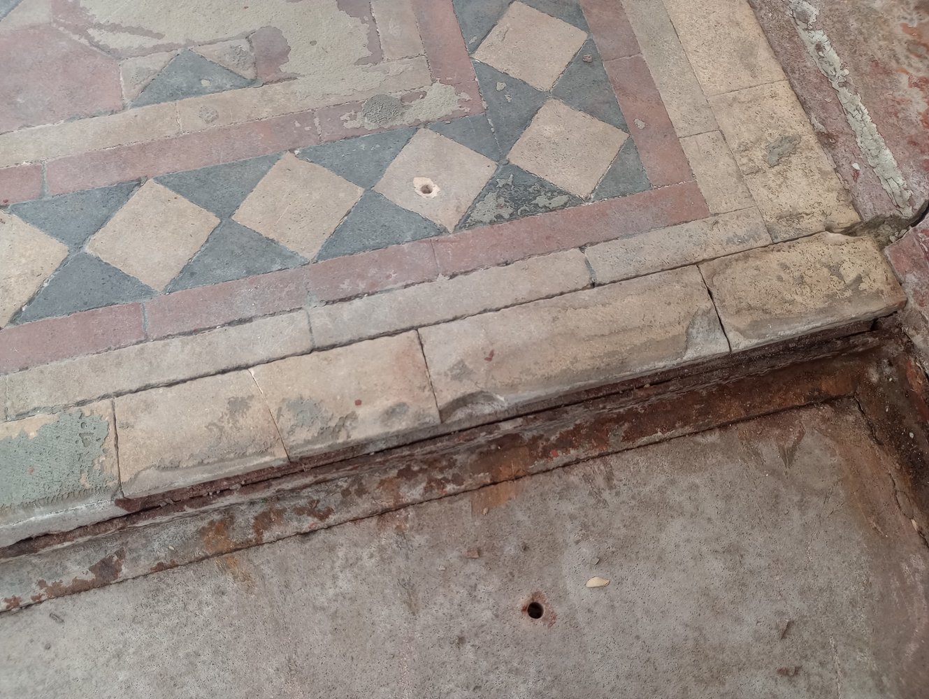

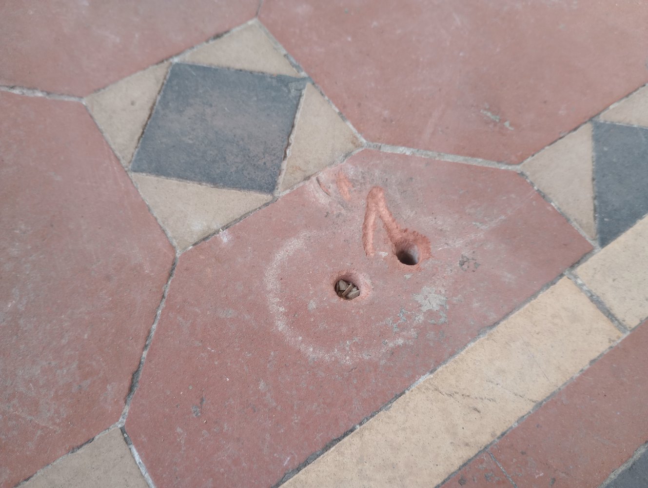

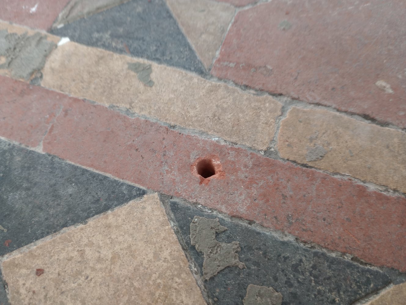

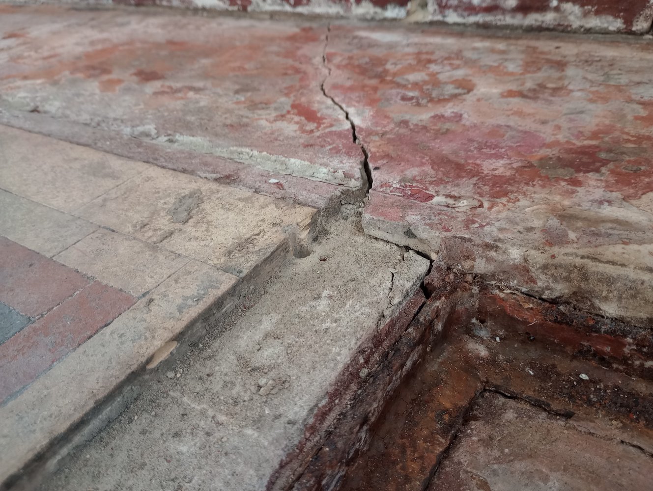

My immediate thoughts: I think it's a very nice historic feature of the house, and if it could be thoroughly cleaned and stabilised (and the major damage fixed), I'd be tempted to tolerate minor damage, which could be considered part of its history and 'patina.' I'm assuming that the tiles are mortared onto some kind of hard substrate (concrete, stone, etc.). Some close-up photos might help suggest some ways of mitigating the damage. I've done a fair amount of tile repair and installation on various antique homes over the years, and I might have a few ideas. For instance, it looks like there are a number of holes drilled or punched in the tiles, which could be repaired with colour-matched epoxy-modified grout. Grout colourants aren't hard to use; they just take a bit of trial-and-error mixing until the colour matches closely. I prefer powdered pigment-based colorants, as they are usually permanently colour-fast. Loose tiles can often be re-secured with clear epoxy, rather than trying to re-mortar them. Etc., etc.Time for a beer and some thought....

A few more thoughts: Without seeing the tiles in person, I could be wrong, but they appear to be solid-colour (through-colour) bisque tiles, which are relatively soft, but that can be a good thing, since chips and scratches show the same color underneath, making restoration more forgiving. I think the first thing to do is experiment with removing what looks like patches of mortar/cement residue on the tile surface. I'd start with trying to gently flake the patches off with a sharp-edged stainless-steel putty knife, without damaging the tiles. Then I'd try to remove the thinner residue/films physically, rather than with an acid designed for cleaning cement or grout residue, since an acid might damage or soften existing tiles and grout. I wouldn't totally rule out acid cleaning, but it's risky, and it would require research and experimentation before proceeding. I would start with the most gentle physical cleaning method, such as plastic pot scrubber pads and water, and if necessary, move slowly toward more aggressive abrasives, such as Scotchbrite pads, etc. If you use a wire brush, at least make sure it's stainless steel that won't leave micro particles that will cause rust stains. If the tiles are very soft, using powered abrasive tools might be too aggressive. It's a fairly small area, so you'll probably want to stick with hand tools.I'm also now thinking it's worth saving. The damage if fairly minimal, just a couple of broken tiles and a dozen holes, the concrete base seems to be good in general with just one crack at the edge/border.
I think you're on the right track. I've never used that product, but there are lots of reviews, so it would probably be worth reading through them to see how well it worked for people. If the consistency of the mixture is too thin, it might be hard to work with.Perhaps something like this might do it

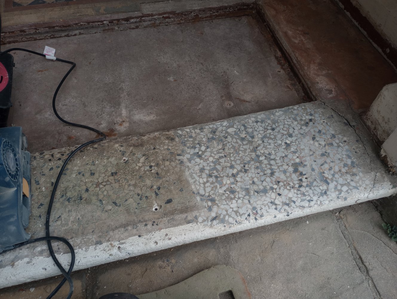

Any decent carpeting compny or evn the internet can be a source for a new mat. i made up a 50 /50 angle iron steel frame with bedding in lugs . got hot galvanized and set inthe floor to our conservatory double doors on the inside . I infilled it with self-levelling compound the the correct depth Got the rubberised backing coconut fibre matting cut to size it fitted dead level with the thermoplastic wood effect diagonals flooring too .That recess held a coconut fiber door mat.
You come across them a lot in buildings that had a tradesman entrance.
Have you considered excavating it deep enough to put in some sensible floor insulation & waterproofing ?
I thought that too, but insulating the floor with single timber walls, and single glazed cant see it making much difference.I plan to try to restore it first. A dpc and insulation would be nice if I I did redo it all.
Probably! The rear outer corner was a bit damp, not sure how to tackle that yet.Nice floor, seen some feet on it over the years! do you think there are going to be any damp issues?
My thoughts too, I could live with the cracked tiles, even the mismatch on the pattern, but would have to do something about the holes.Save it!
I'm also now thinking it's worth saving. The damage is fairly minimal, just a couple of broken tiles and a dozen holes, the concrete base seems to be good in general with just one crack at the edge/border.
