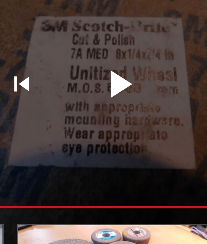

I am trying to say they can't be the right discs as they start at 45 quid EACH.They all come individually (well in boxes of a single type)

Ok so you have the correct discs. You just buy them in bulk.That's probably about right if you are buying them individually.
A box of 6 is about £200 for the bigger sizes.

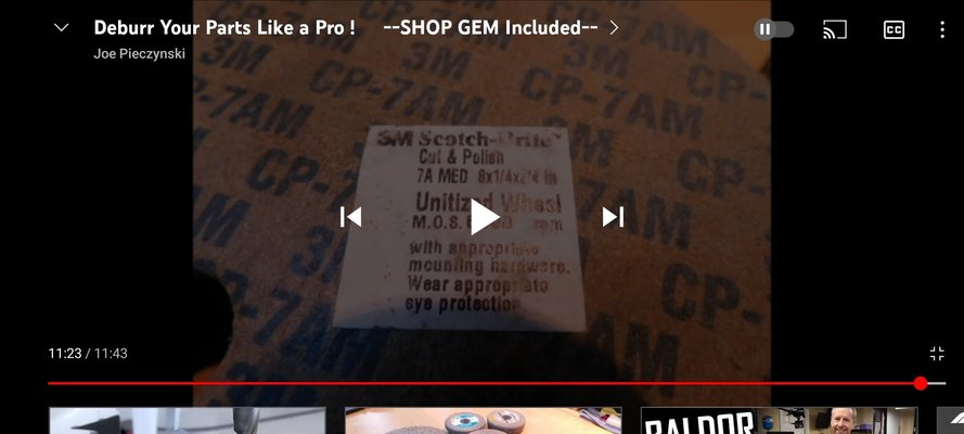

Deburring 75mm lengths of 20mm all thread. BZP.I think that number is a generic item code not an actual part number.
There are loads of variations on it,
Overall diameter, width, bore size.
Then compound/grit, firmness of the carrier, profile of the edge etc.
Let me know what job you want to do with it and I will see if I have got anything to suit
The number is typed wrong. It should be CP-7AMI think that number is a generic item code not an actual part number.
