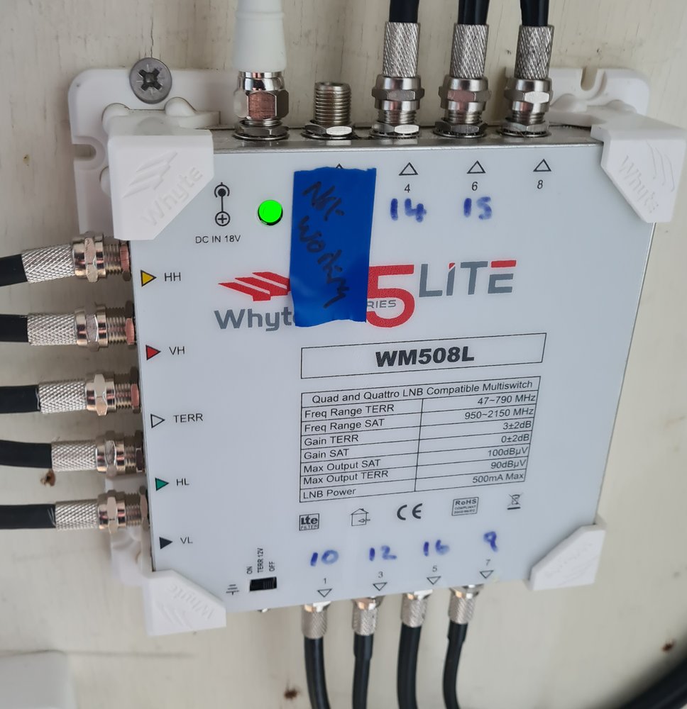

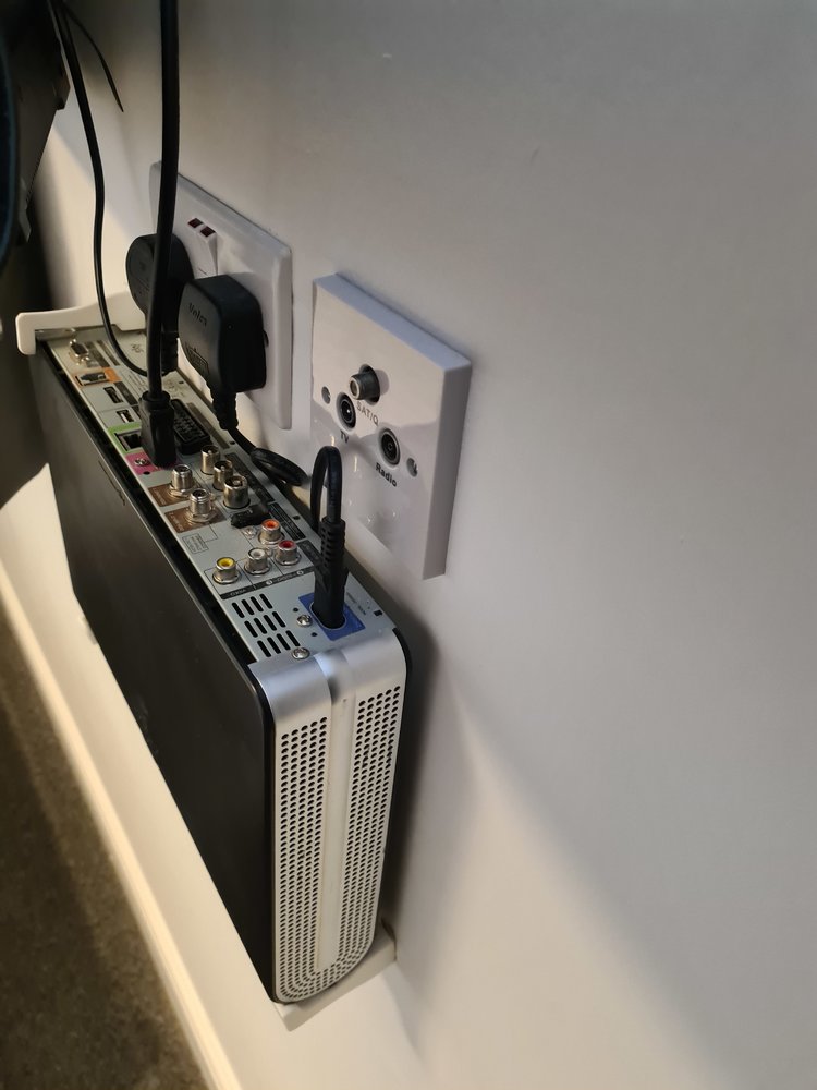

At work I've got a problem that the sat box said no signal
The pic is after I've removed the sat cable to Reseat it but made no difference I've had this before and took me quite a time swapping cables boxes etc
If I bought a satellite finder will that cheak the wall socket for me ? Before taking every thing apart putting in new cables etc
. Signal finders are no good unless you get a dear one, they will tell you if you are getting a signal but not which satellite it is coming from. I used a compass and the
It looks like your problem is the coax cable or a bad connection.
