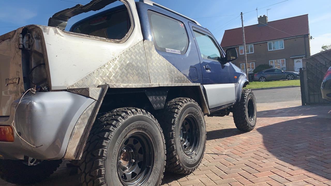

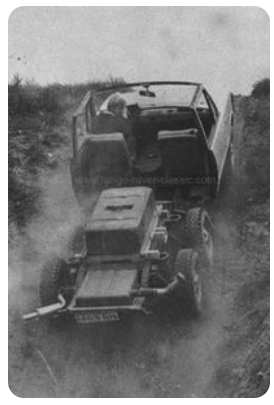

Mine is called a Scottorn when it was built mine is no 3 there were 4 (no 4 is in France).  No's  1,2 and 3, had the option, of 6x4 or 6x6 when mine was finished they then decided to take off the option so it was left as a 6x6, I still have the warnig lights on the dash.
The centre axle the replacement diff also has what people have called a mini diff in the nose cone, which is to stop wind up or at least help.
I can lock all axles so I have drive, I can lock the front axle to both rear axles, by using the transfer box, but if I lift a front wheel I will still move, but if I lift a wheel on either rear back, I will remain stationary. If I lock the transfer box and operate the diff lock on the centre axle which works on vacuum, it will then lock both rear axles so if I do the same test as above I will move and it can be driven.
I have driven mine off road in trails and around the off road course at Billing Aquadrome, the other thing about mine is, the length given in the books might not be correct, it has actually been lengthened twice, there is 9-10 inches between the front seats and the rear seats, and then 39inches at the rear.
It is very capable off road, yes I have had it stuck because of the length getting around tight corners as a friend who worked on it commented it has the turning circle of a super tanker, I have had it stuck in mid air with all wheels spinning.

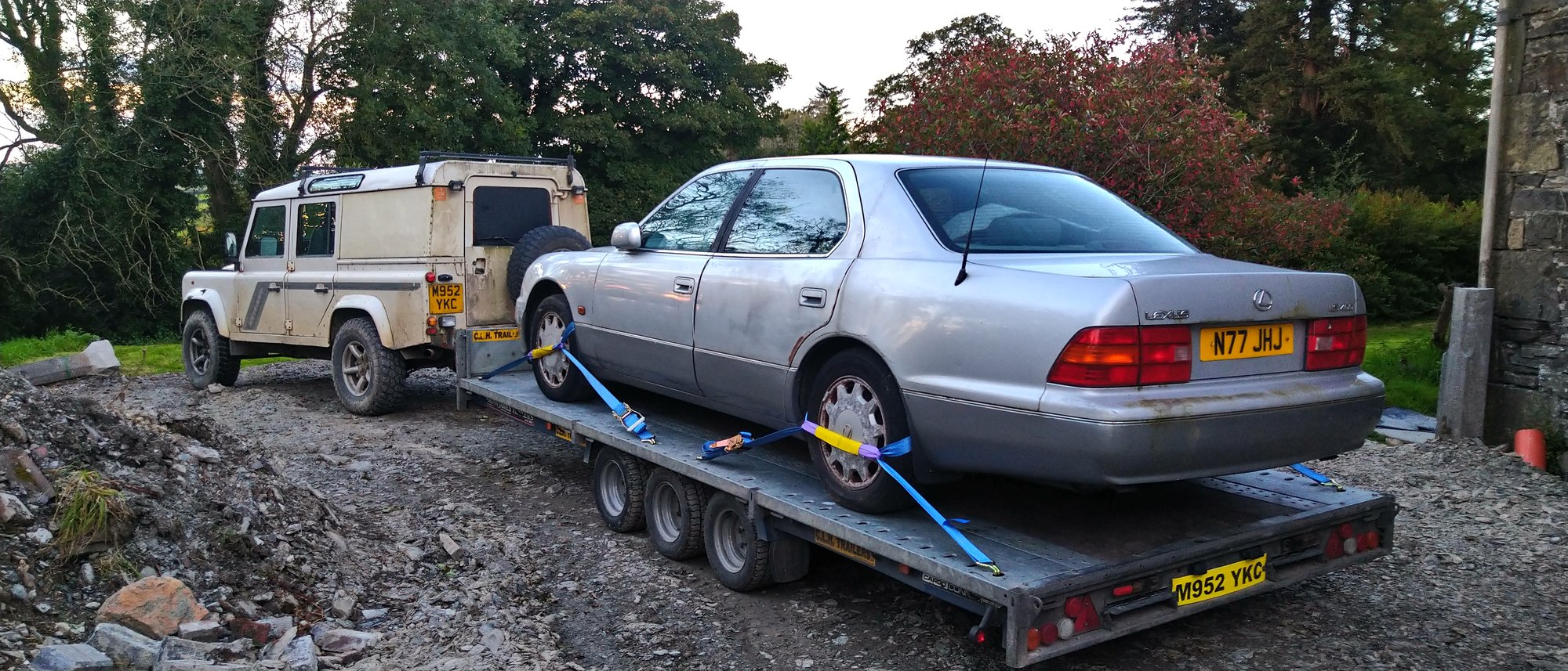

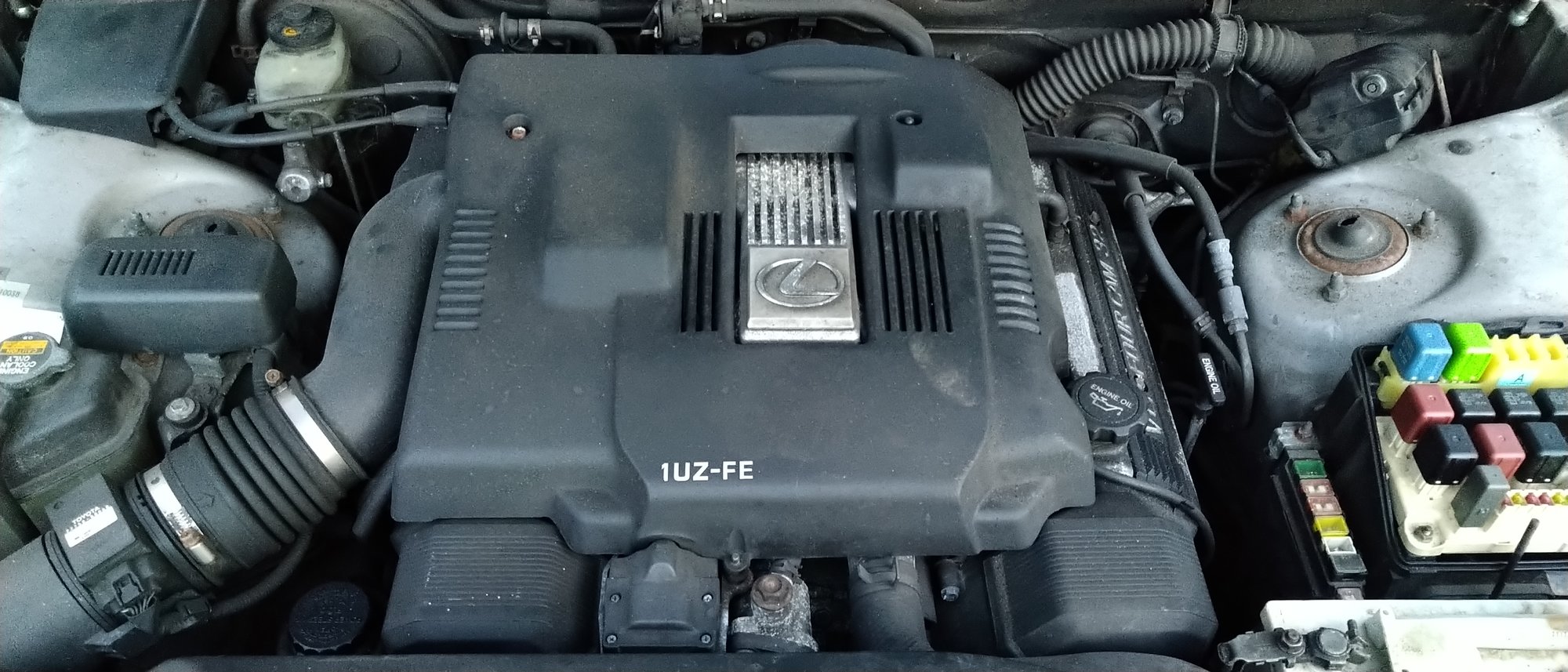

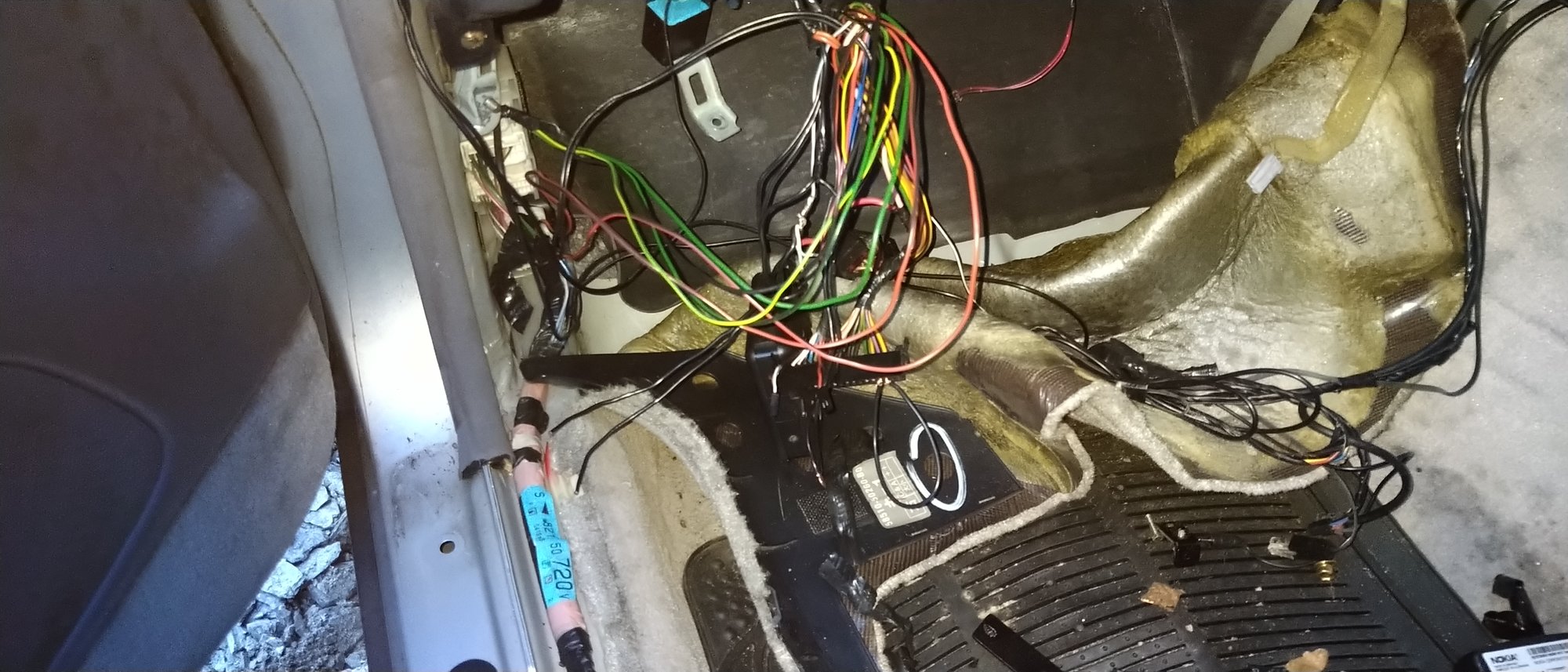

 (and a bit of a cheapskate)! The entire Lexus cost me £550 and a trailer rental, and some time to hot-wire it, being a petrol I don't have to feck around with gearing like I'd likely have to do with a big diesel lump. If I can be arsed I can probably get that £550 and some back in scrap or breaking and selling bits off it.
