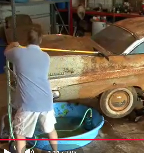

surley a small fishtank /washer jet pump would be ample to keep a panel wet ? my thoughts are how are you going to catch it all neatly , say you want to wet up a sill, the water will creep and be dripping off all the underside
you thinking of doing one section at a time right?
its only got to stay wet doesnt need to be blasted at any rate , a gentle trickle ought to do , then what make a frame and pond liner to catch the run off?
Driving thru a river is a once & done.It's not "acid" as such - it's a chelation reaction - the "Daz" laundry washing powder neutralises the acid.
There's a thread on here "home made evaporust" about it.
Any other issues with liquid, I'd rather find out in my back garden than in the middle of nowhere after driving through a river.
A shower pump would be ideal but it would need a head, so pump below fluid tank.I have one of those - it's what gave me the original idea.
Its going to take some experimenting with sizes of pump to get the correct pressure + flow.

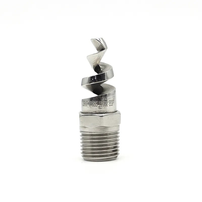

I ordered one of these:
Pressure washer that can lift from a tank with roofmans attachment on the business end?
I'd be more worried about it taking the zinc platings off anything over time, calipers, pistons, etc.
Neighbours. A PIAI think that'll be overkill - plus, can you imagine the neighbours' reactions to a pressure washer running 24/7 for 3 or 4 days?![]()
