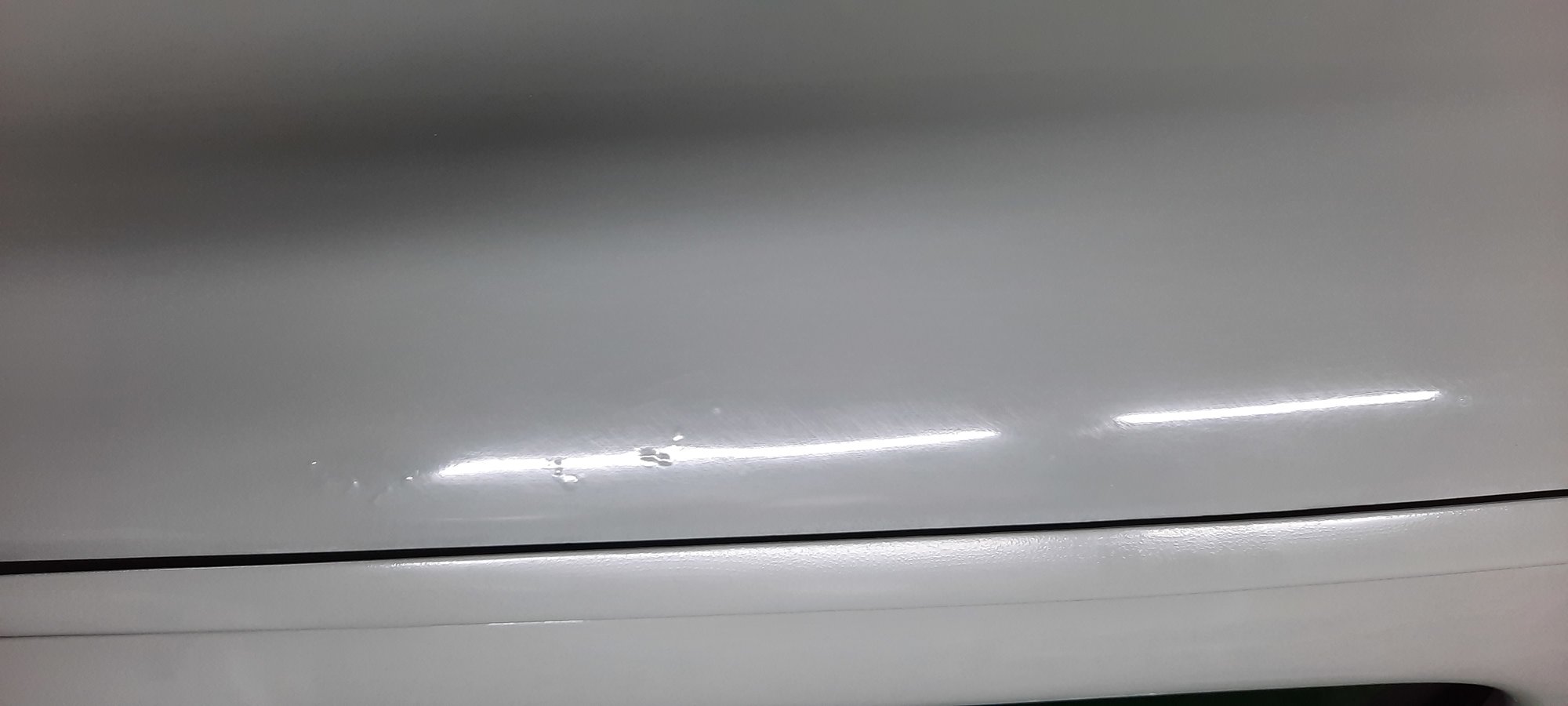

Some time ago i tried my best too erase these rust spots, but they have come back
The plan is too fully strip the area with a some 50mm stripping discs, then spot blast the areas that require it, in addition i will try the acid treatment and have obtained a litre of this
But from what i've read it needs thinning by 40% ? and it's add acid too water from my school days ? PPE for this apart from visor and rubber gloves ? i will be able too doo it just outside the garage doors and get it back in out of the elements. then a 10% wash and apply the Lechler epoxy primer ? No rush a t present as there a few other bits being done on the pop over the winter and looking at a full blow over
April ish !
Start to finish through the week, ground out rust spots and covered with Fertan, brushed on Lechler epoxy primer and flatted back and fill as required, several thin coats of Lechler hi build as I'm only using my 1.3 gun, quick guide coat of black etch primer from a can, flat back and feather and several coats of ie ? gloss too flat back tomorrow, match is good !

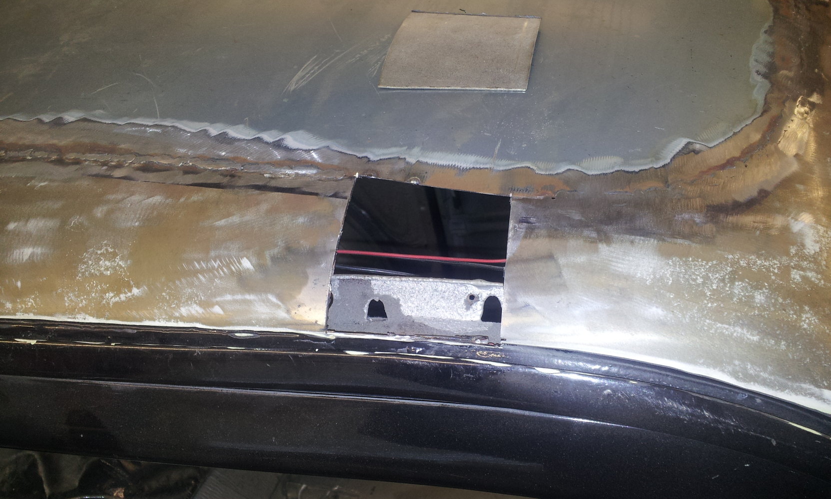

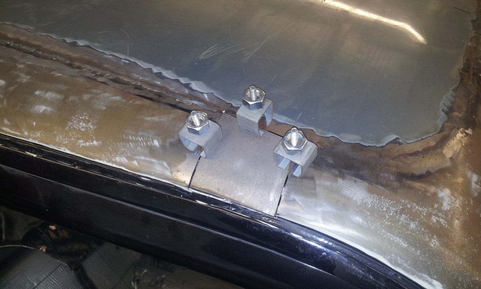

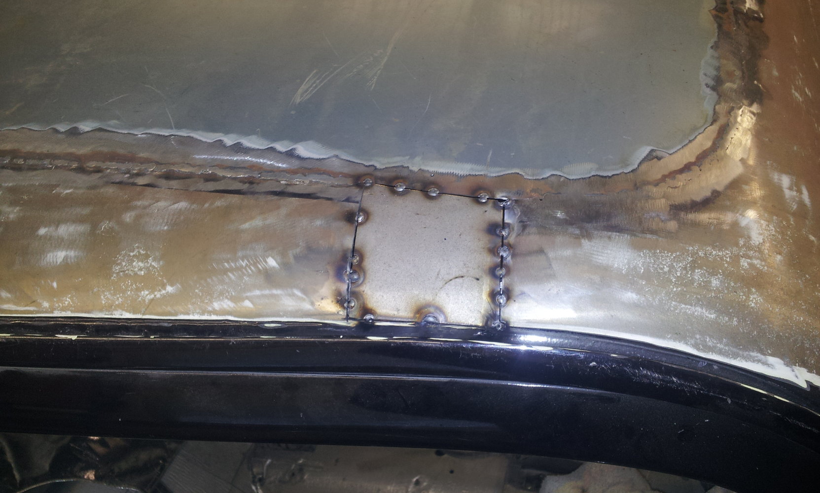

maybe it's welder time rather than acid !
