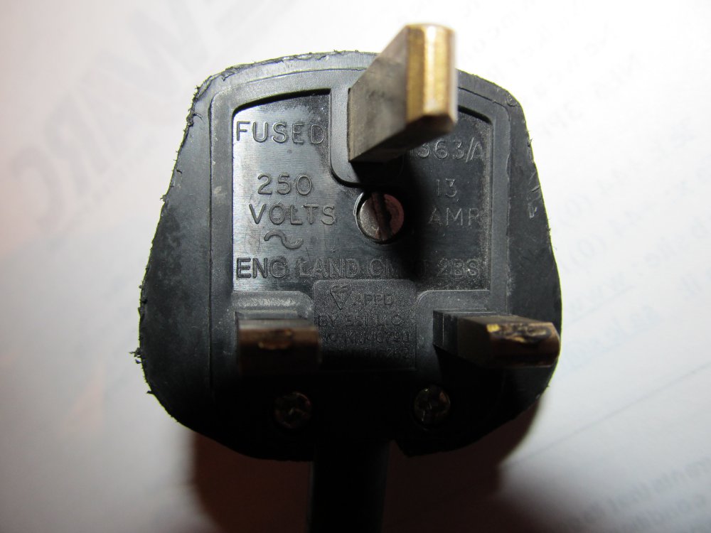

That looks well toasted, I would not have even plugged it in. Please get it checked out by a sparkie / repair shop and get the correct 32A out let and suitable wiring installed and tested.This is the plug it came with when i went to get it, it was run through normal household sockets with an extension into the garage got it up to 140A with out blowing any fuses. It'd be nice if it just limited me to run under 100amps rather than not work completly. Could maybe switching it to lift instead of HF help thanks for the quick reply guys appreicate it
Well noted mate. Guys needs a sparky immediately to check out his plug and cable wiring back thru his machine switch then.I don't think many picked it up, which is why I highlighted it![]()

I would not be happy with 10mm cable in a 13A plugI think Richard's got it there Ben. Some of these units can make more sensitive electricity supplies trip out. I used to have one that was the same and it would sometimes trip two or three times in a row before it'd start up. I put it down to some capacitor charging somewhere inside it.
That being said - the cable and plug look shocking (pun intended) and for the sake of a fiver I'd have that all out and rewired. You never know, that might help it. At the very least you can be sure it's not gonna bite you.
A 32A dedicated supply is what you need. It can be wired in a million different ways and I'm no sparky but usually it'd be a dedicated line in T&E or SWA from the CU to the 32A socket. If you're moving in a few months then it's not worth it really. Spend the money on a new power cable and plug...![]()

Yea i measured the whole cable like you saidAnother assumption on my part here.
I'd bet you measured the '10mm' cable just on the outside?
Cable isn't measured that way - it's specified as the cross sectional area of the conductor, nothing at all to do with the insulation.
I'd go with 3x2.5mm myself, or step up if going to 32a supply.
