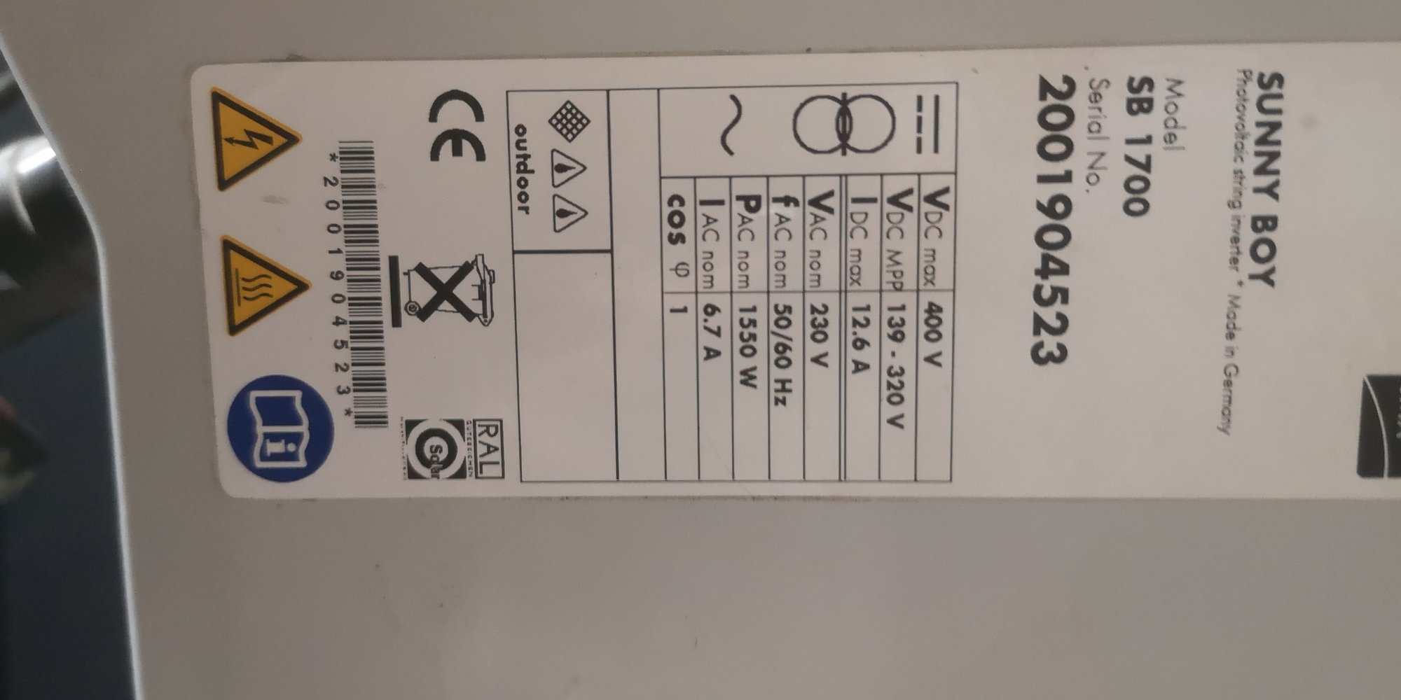

That's an old sma sbxxxx inverter. The "xxxx" part if the model number on the data plate is the max power. It's old now but still a quality European inverter. I'd use it if capacity is suitable. I've a few spares for this if you find yourself short of connectors or brackets etc.
If you do decide to get a new one, I'd offer something to buy that sma if it's sb2500 or bigger.
