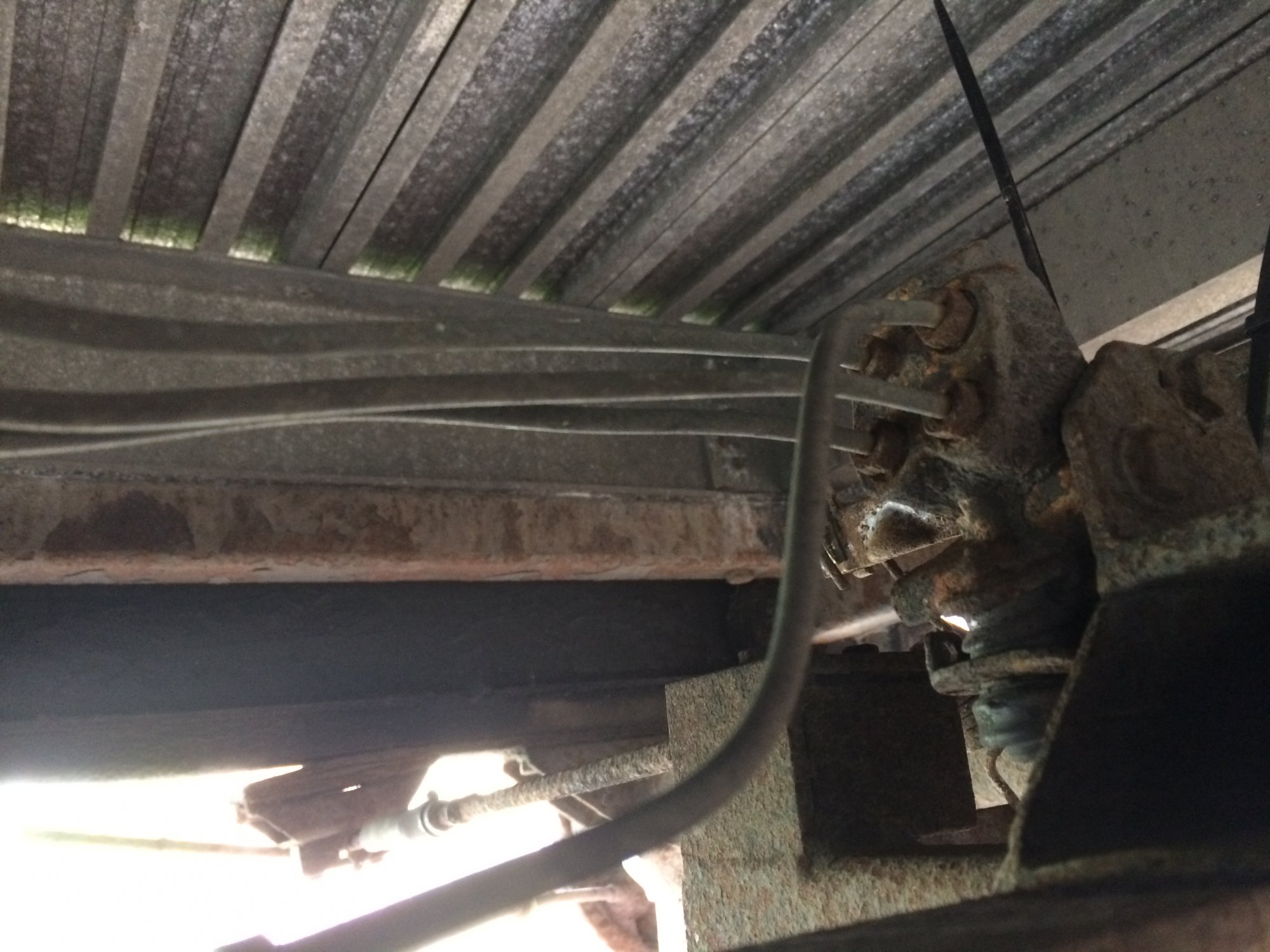

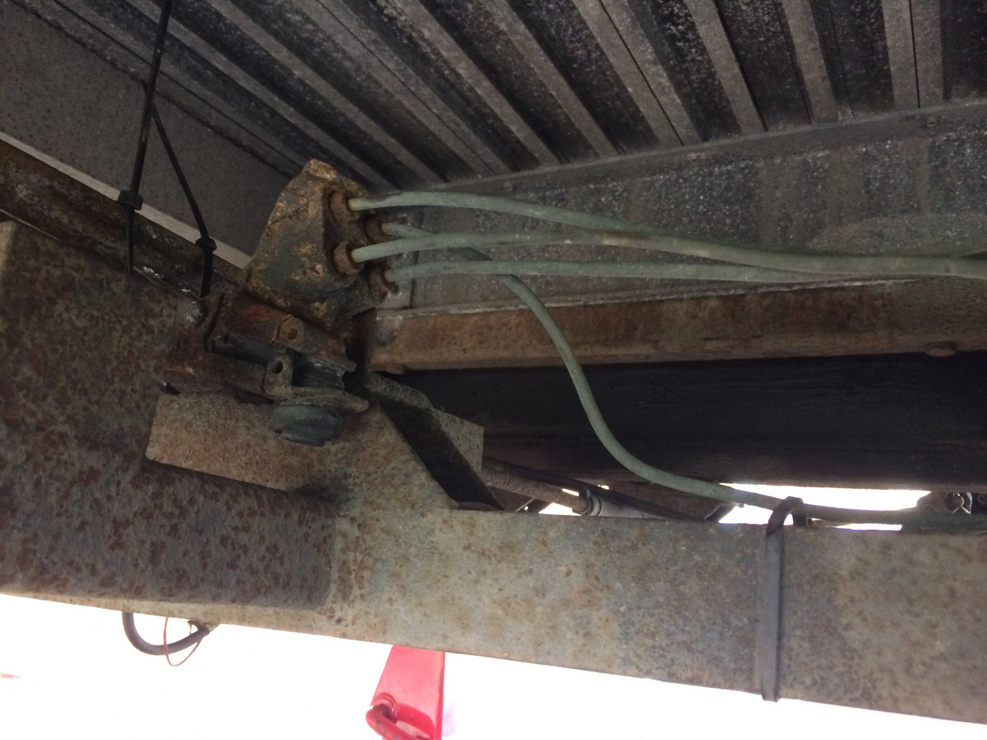

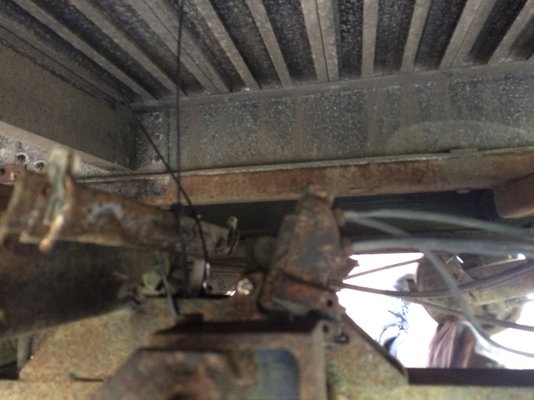

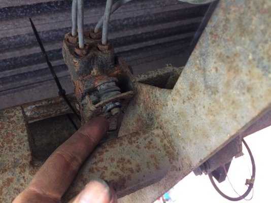

i set them up as you described. i checked the cylinders were moving with an assistant.
i clamped all 4 rear hoses and still had a long pedal so bled front and rear brakes with the engine running. air did come out a couple and the old fluid was a bit dirty but not real bad. pumped through just under a litre of new fluid overall.
