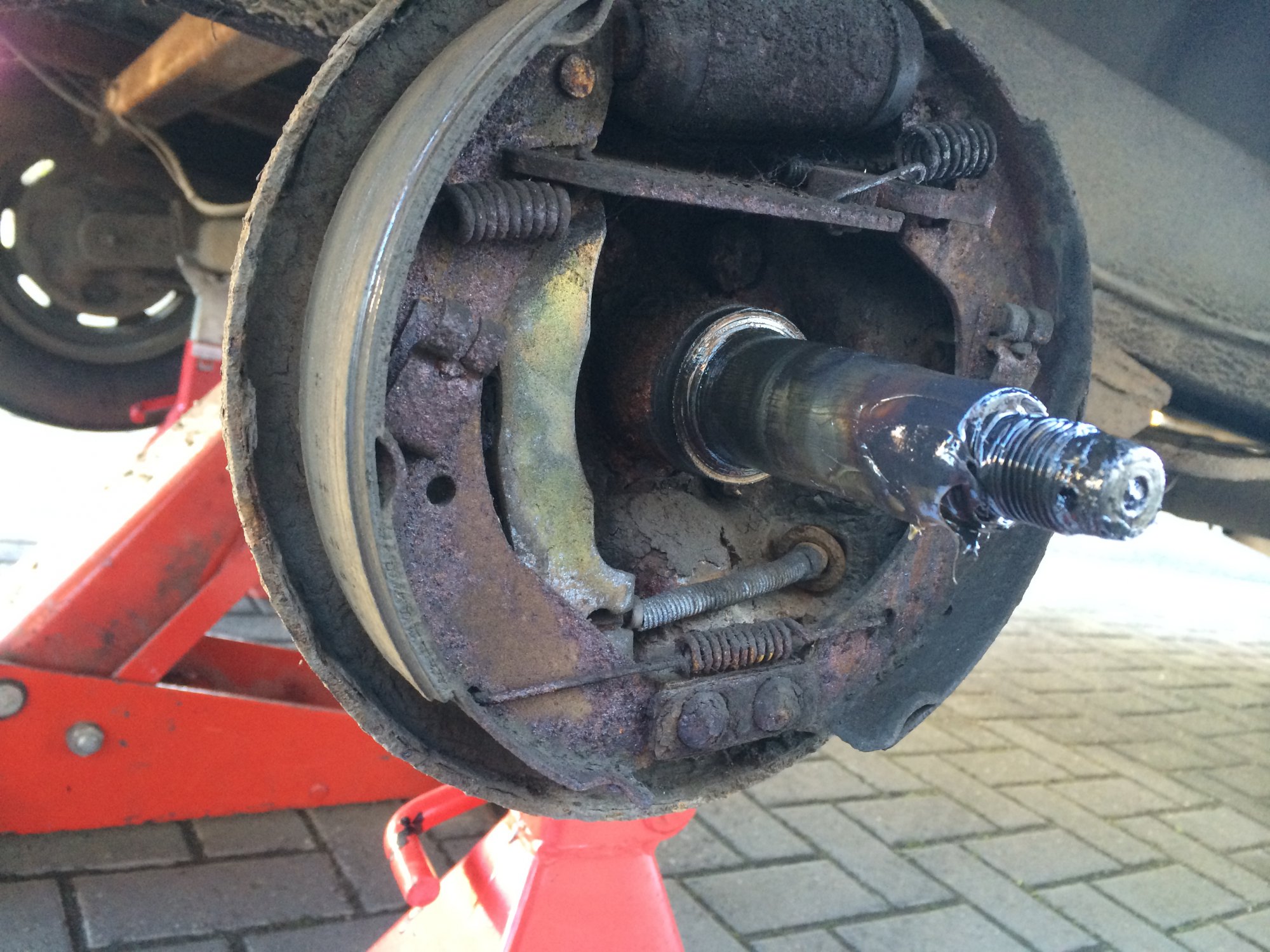

what's got me confused though is that when I clamped off all of the rear flexi hoses I still had a long pedal. which is strange as clamping them off would stop the rear brakes from operating.
that's why im scared to fit the larger rear cylinders and get an even longer pedal.
the front discs/pads are a bit worn but that shouldn't be an issue surely.
