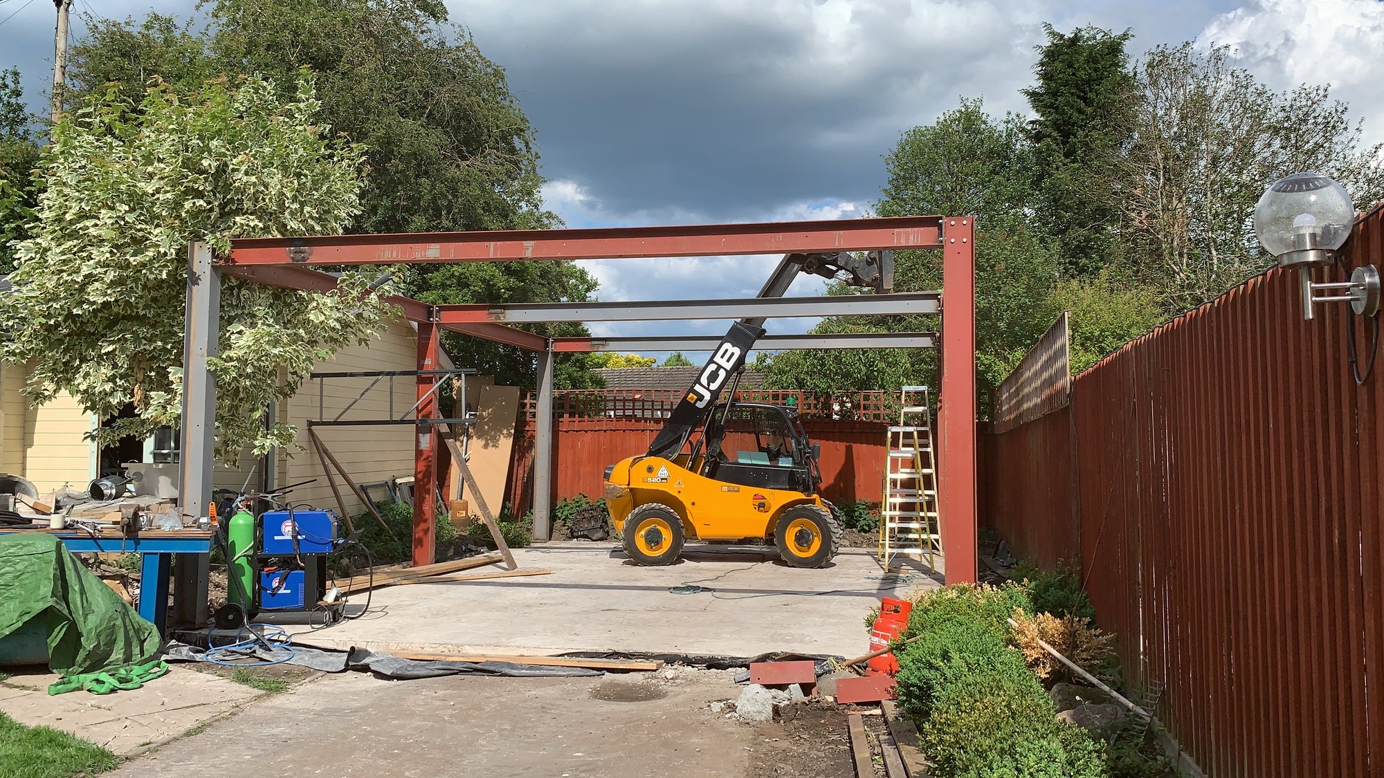

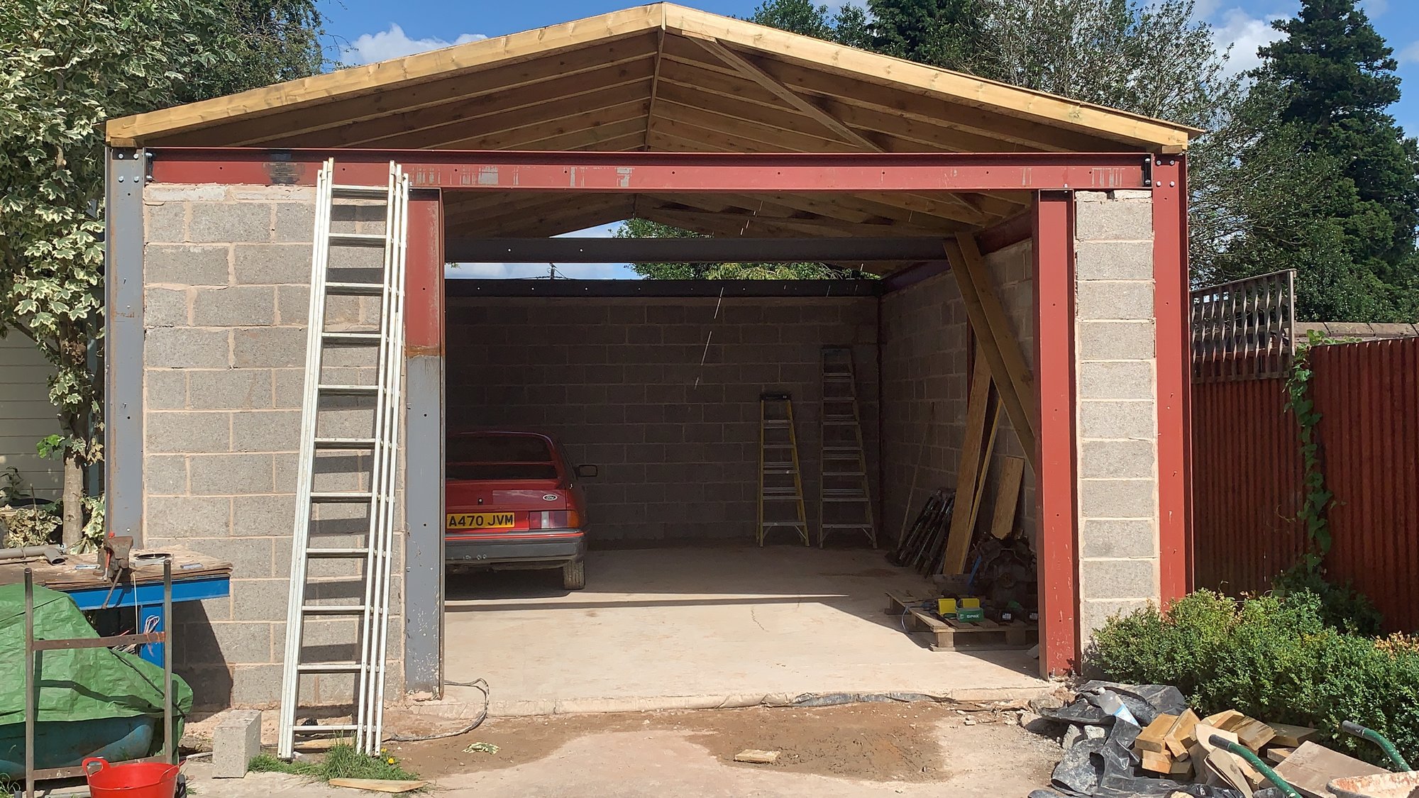

At first I was thinking how’s he going to get that JCB out. Is that a big garage? Looks great. How do you go about something like that does the building inspector have to come and sign off the steelwork as you go or at the end like a regular build? Genuine questions, never contemplated managing or undertaking something like it myself.

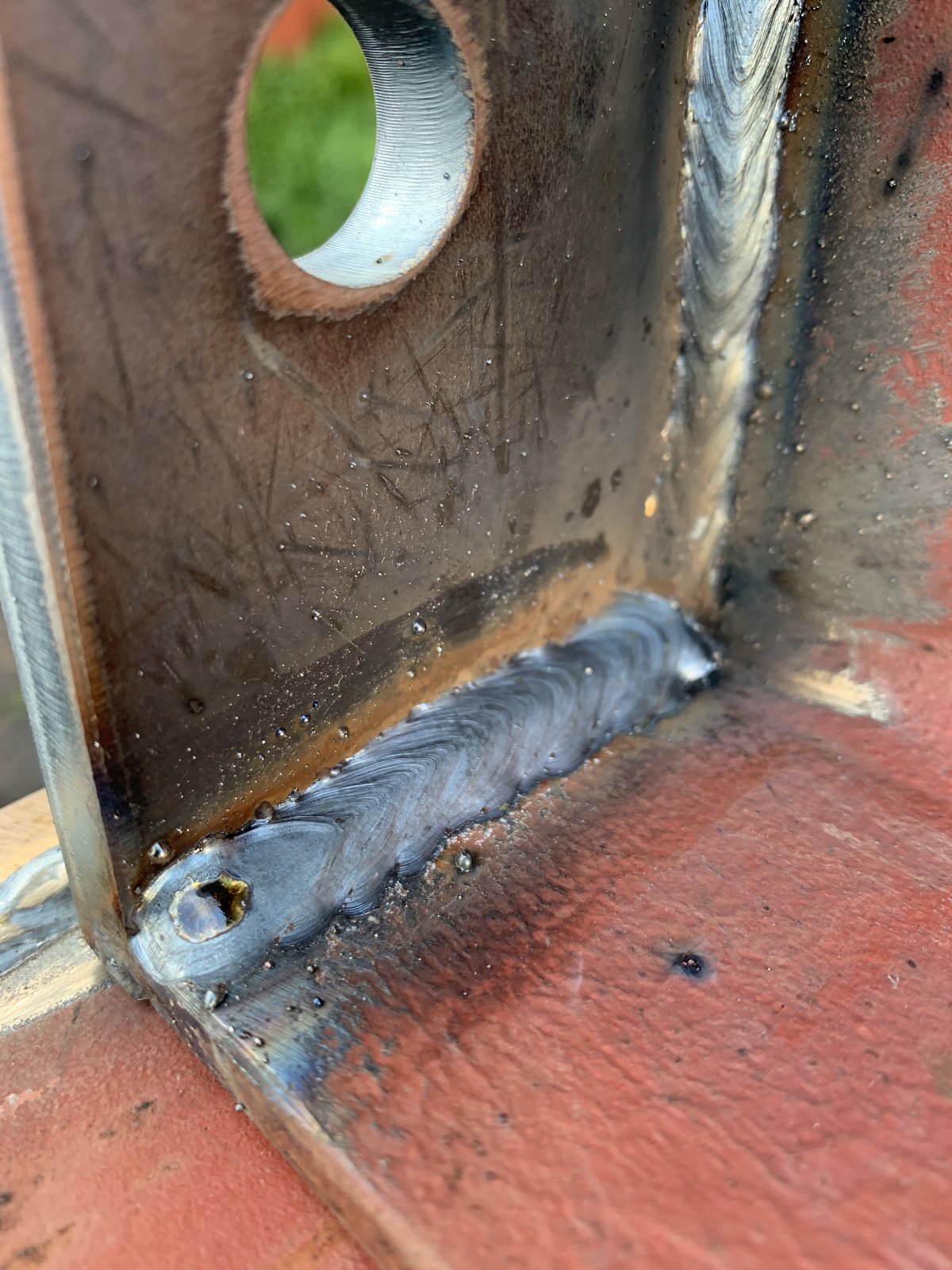

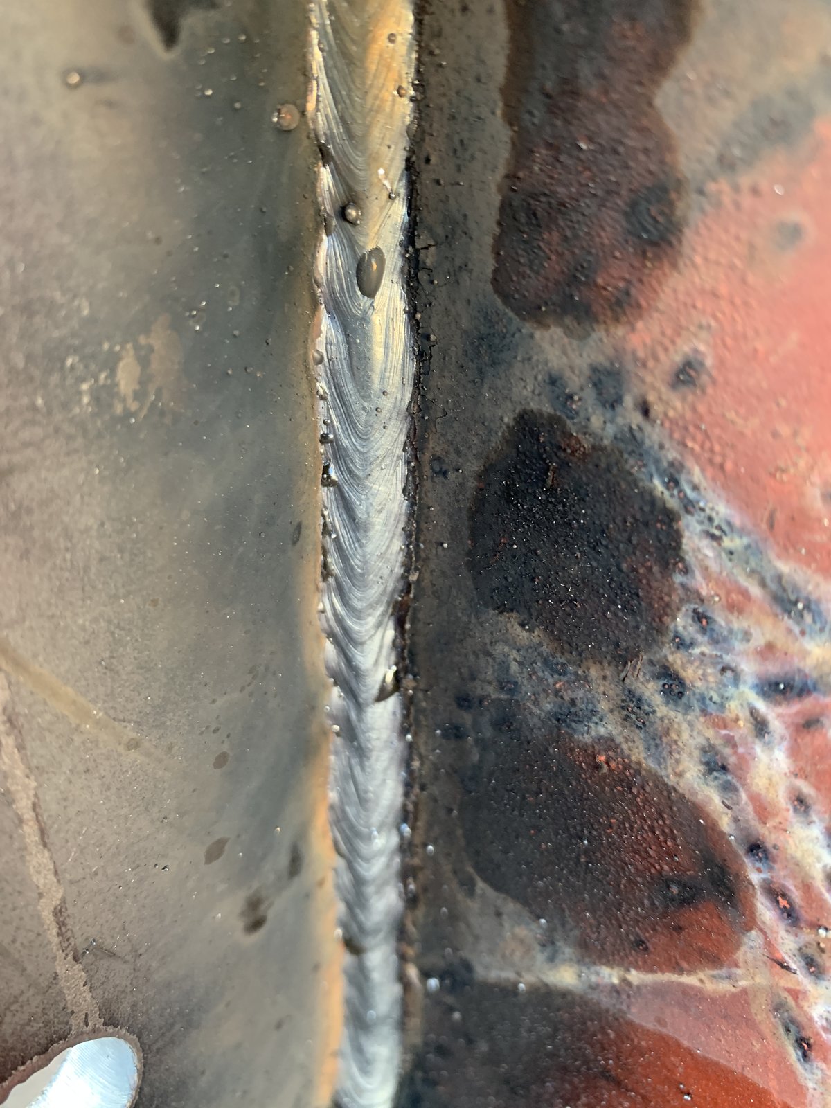

Why not for code work? The welds are fine and dandy, great penetration, good consistency and would easily do the job. Coded work is about the operator skill, not the machine so much. In the right hands (not mine) this machine looks more than capable of producing work to code standard. It's not as good doing overhead though, fine in the vertical up/down and horizontal, but again, that's more about my lack of skill.

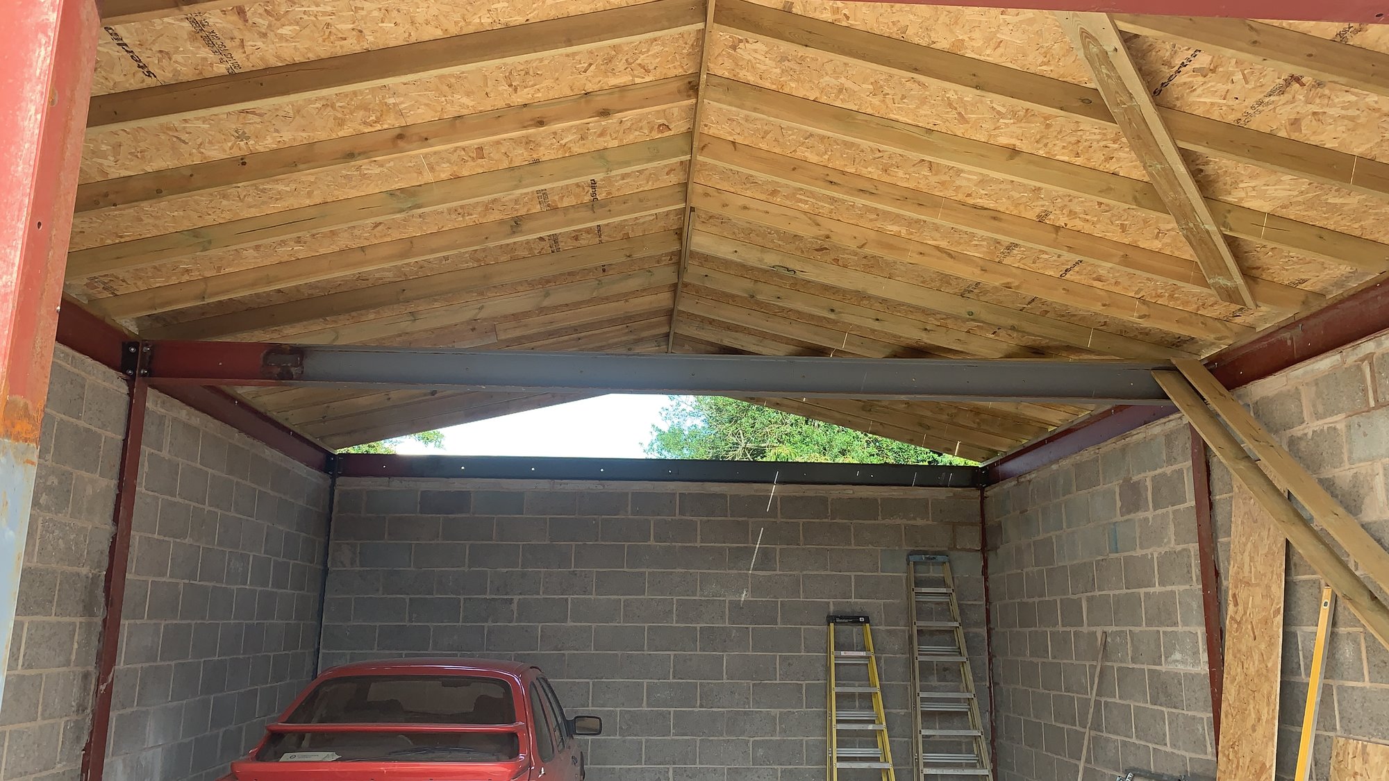

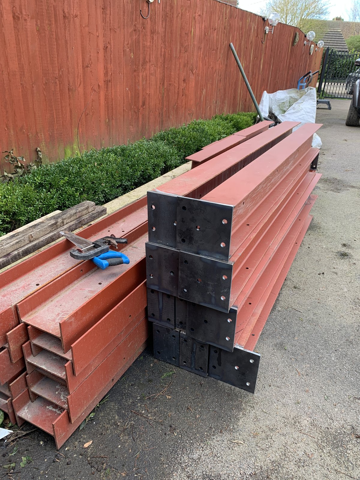

For reference, This was all done with the R-Tech 250 and their 50 amp plasma. By an amateur. This is 8mm steel I-Beam welded to 10mm end plates. 1.0mm wire and about 220 amps. Note in image 2 the penetration is fine. The last 2 images show what a crappy operator can achieve in less than ideal circumstances. Outside, mediocre skill levels, no posh jigs or table set ups etc. Just clamps, squares and grinders with the beams supported on some trestles.
So is the machine really that bad? I personally don't think so, especially for the money. How much better would it have been with a 2 grand machine? That's debatable. How much better would it have been with a professional operator? That would be much more noticeable.
The one thing I would concede is that pretty much all inverter based machines are likely to be less long-lived than a well made transformer machine. Electronics are great, but hate abuse. Personally I can live with that for the benefits of portability and storage when not in use. A professional fab shop would not be too fussed about either of those things.
All the above is my personal experience, just to add balance. I'm no expert.
