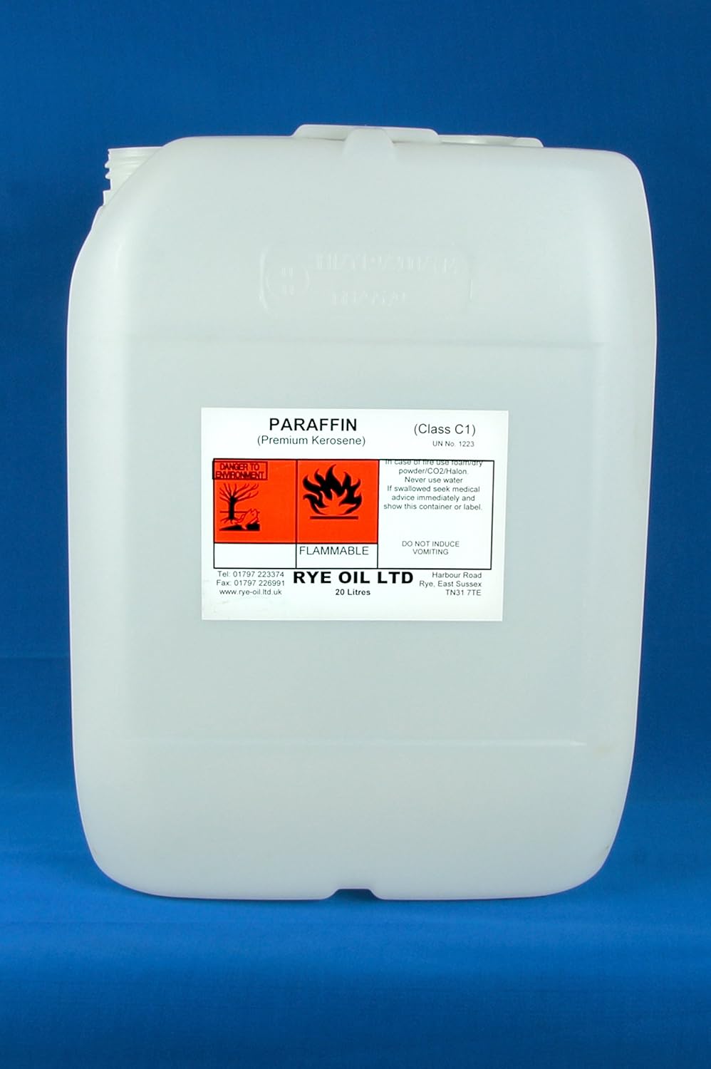

Another one that we used to use when at school. That's why WD40 works, I believe it has kerosene in it.
It makes cutting ali with a jigsaw very easy too- you can use, oddly, a fairly coarse wood blade. I've cut very large alloy yacht spars like this, I mean masts for 50 footers. A final squaring with a rasp is often barely needed.
Without the WD40 you end up with not unattractive steel and ali stick.....
