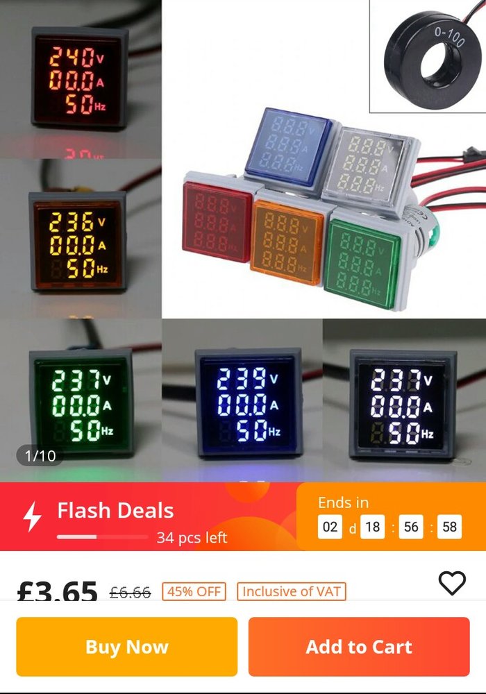

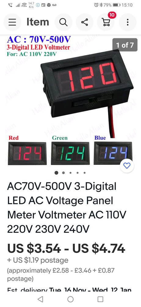

Square analogue or the little Chinesium ones?
Thinking a red, yellow and blue one would look cool for the 3 phases. Much more blingy than the new phase colours!
[£5.18 22% OFF]Geekcreit® 3 in 1 AC 60-500V 100A Square LED Digital Voltmeter Ammeter Hertz Meter Signal Lights Voltage Current Frequency Combo Meter Indicator Tester With Round CT Electronic Accessories & Supplies from Electronic Components & Supplies on banggood

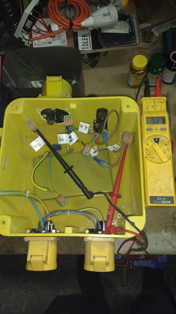

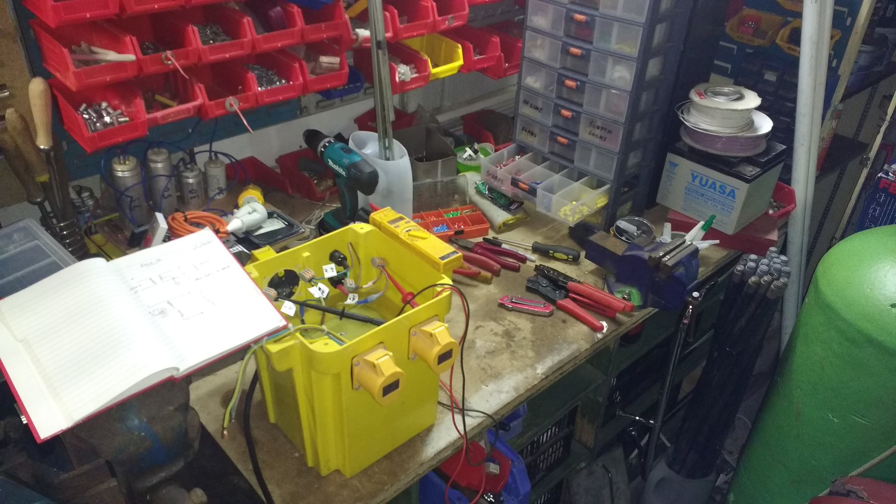

whats bench space??Having made a bit of bench space I just had a play with reconfiguring this 5kVA site transformer.

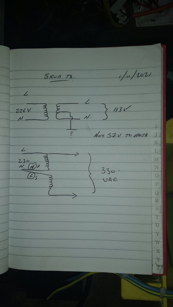

I've "stacked" the primary winding on top of the secondary as per the sketch below.
First I disconnected the wires to the 110V sockets and clipped them out of the way.
Then I put a 3-way Wago in where the incoming L goes to the primary.
I then cut the incoming earth that goes to the centre tap on the secondary and isolated both ends with Wagos.
I cut the incoming neutral where it goes to the primary and put in another 3-way Wago. To this I connected the L of the secondary.
My new "take off" is then from the original L on the primary and N of the secondary.
Getting 330VAC. I must check the volt drop out to the garage.
What else.....I'd take the incoming earth to any circuit I connect but leave the centre tap earth isolated.
Need to clear some more bench space now to get the motors on there!

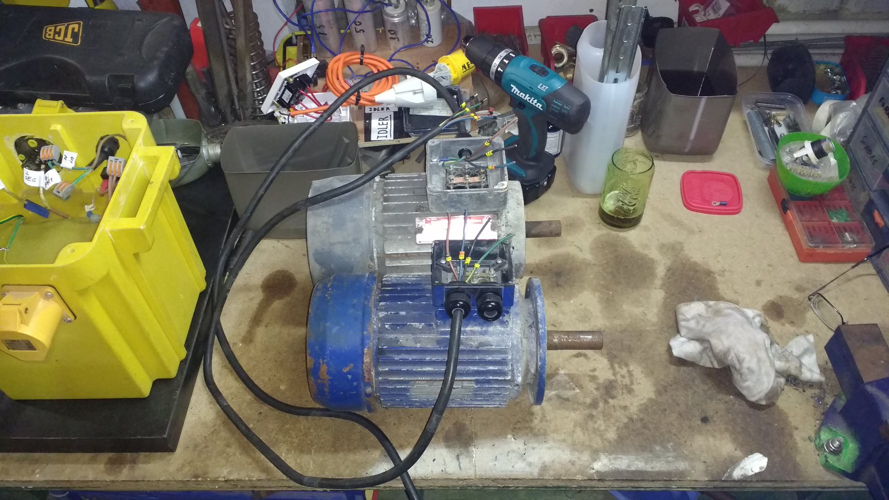

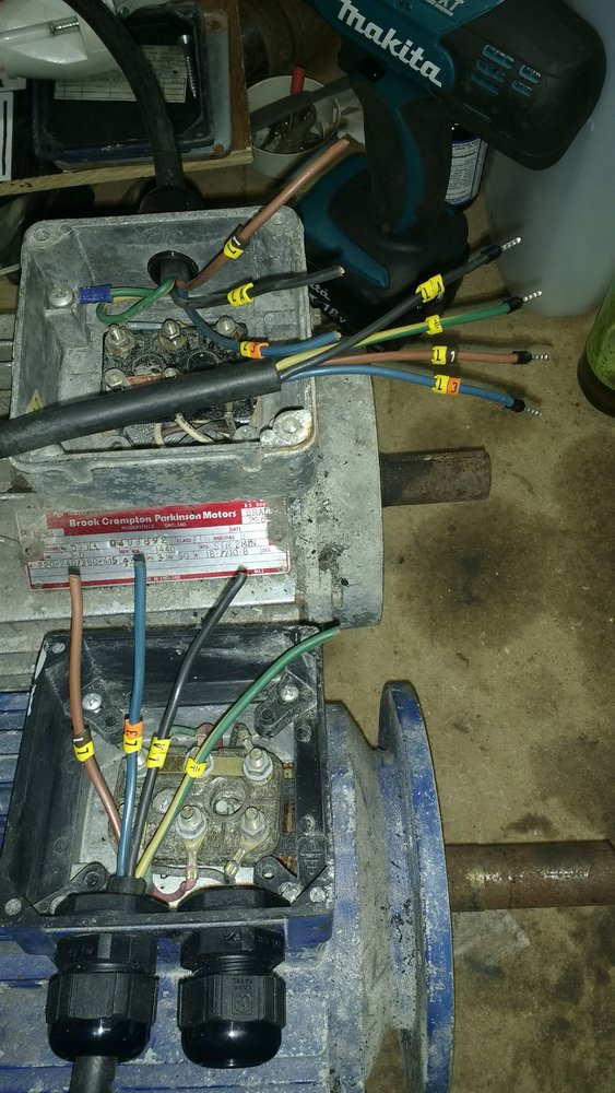

Glad you underdstand it all . LolHappiness is a bit more space, the radio on, the gentle hum of a fan heater, having the right bits to hand, namely some ancient H07RNF and even the correct PG16 glands for the Italian motor...and a beer (albeit in the wrong glass):
L1 & L3 will come from the autotransformer. LA is the "artificial" phase.

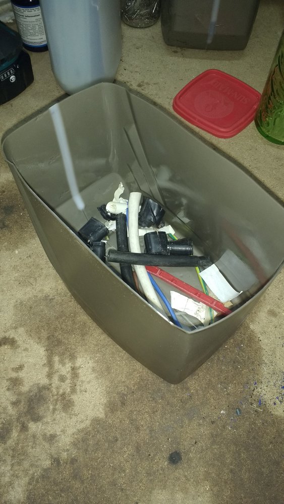

I'm even being extra tidy and having a bin:
I just want my blingy, Chinesium meters to turn up now!

Bigger one will manage the heat betterWow! Was it really that long since I was playing with this and had a clear bench?
Anyway...
I've rewired a 110V site transformer as above to give nom 230 + 110 so circa 340V as one of my phases.
This large trannie I've got, been trying to think of a use for it. It'd give me 230+190 so 420V:
Thinking though the 5kVA 110 trannie might be better than this 1.8kVA one?
