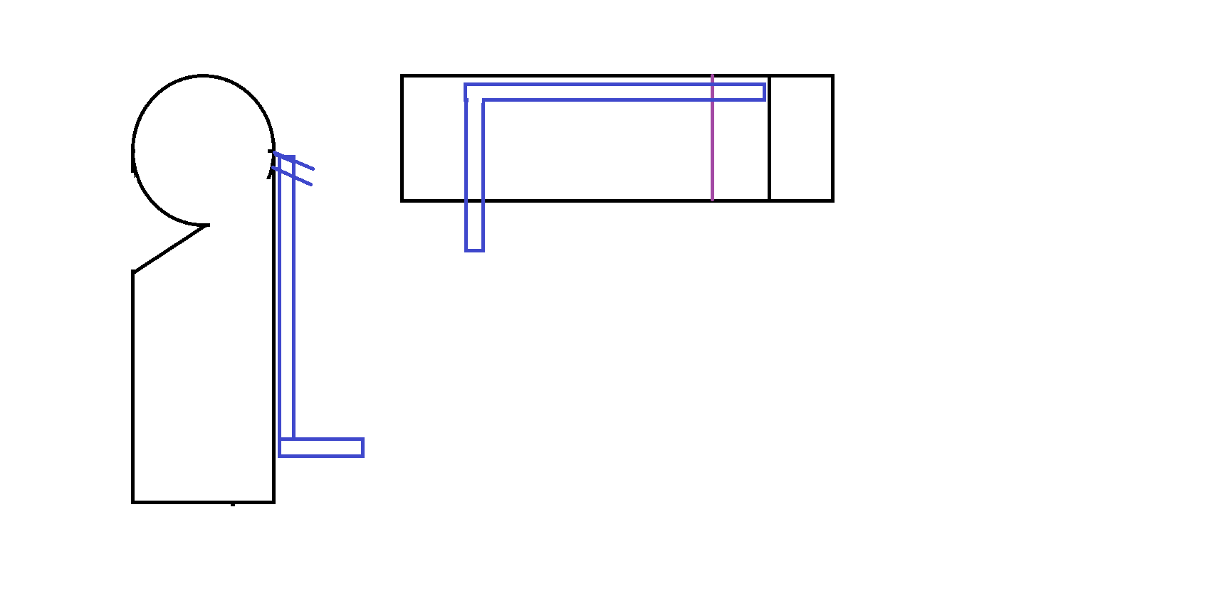

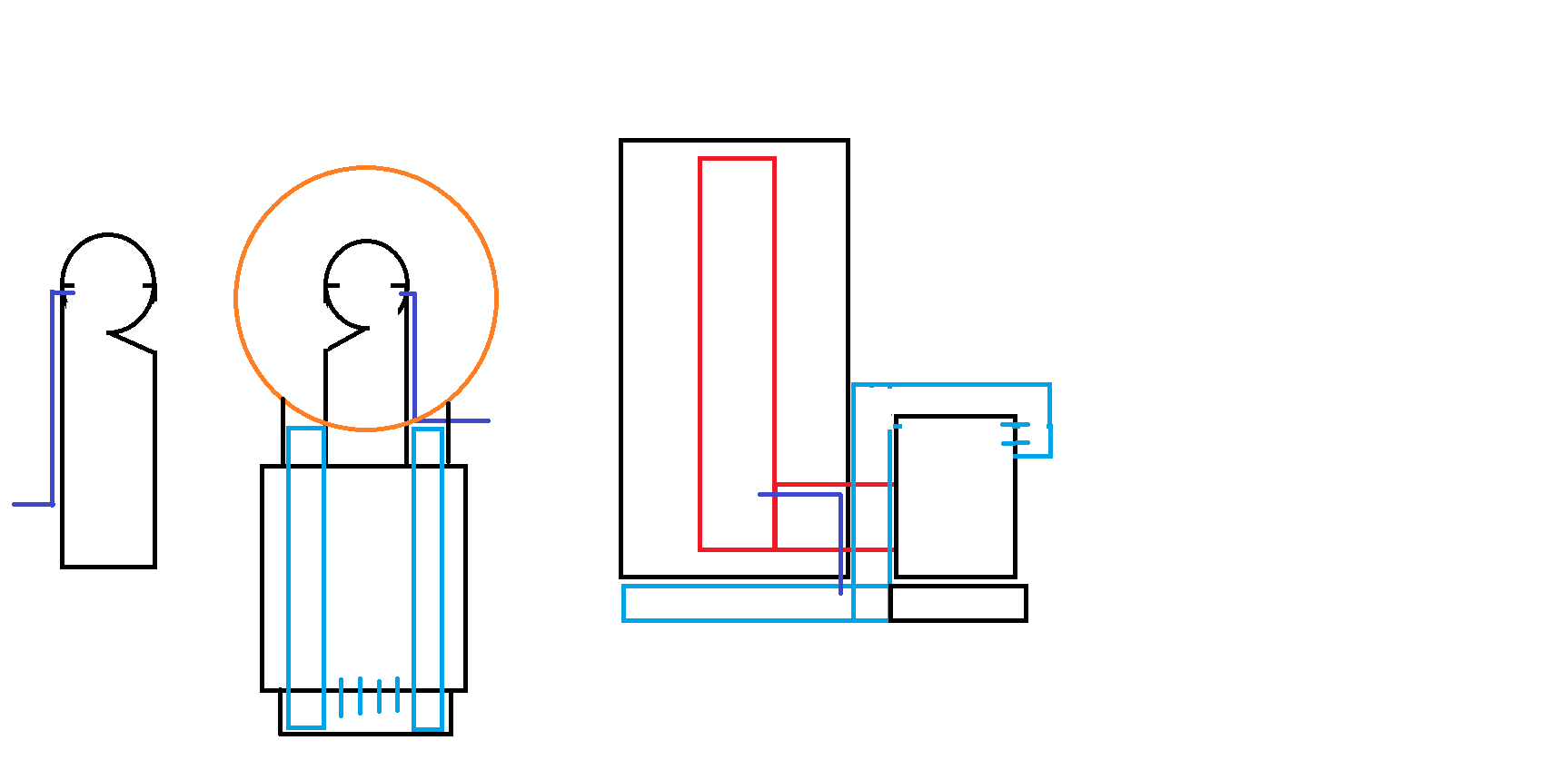

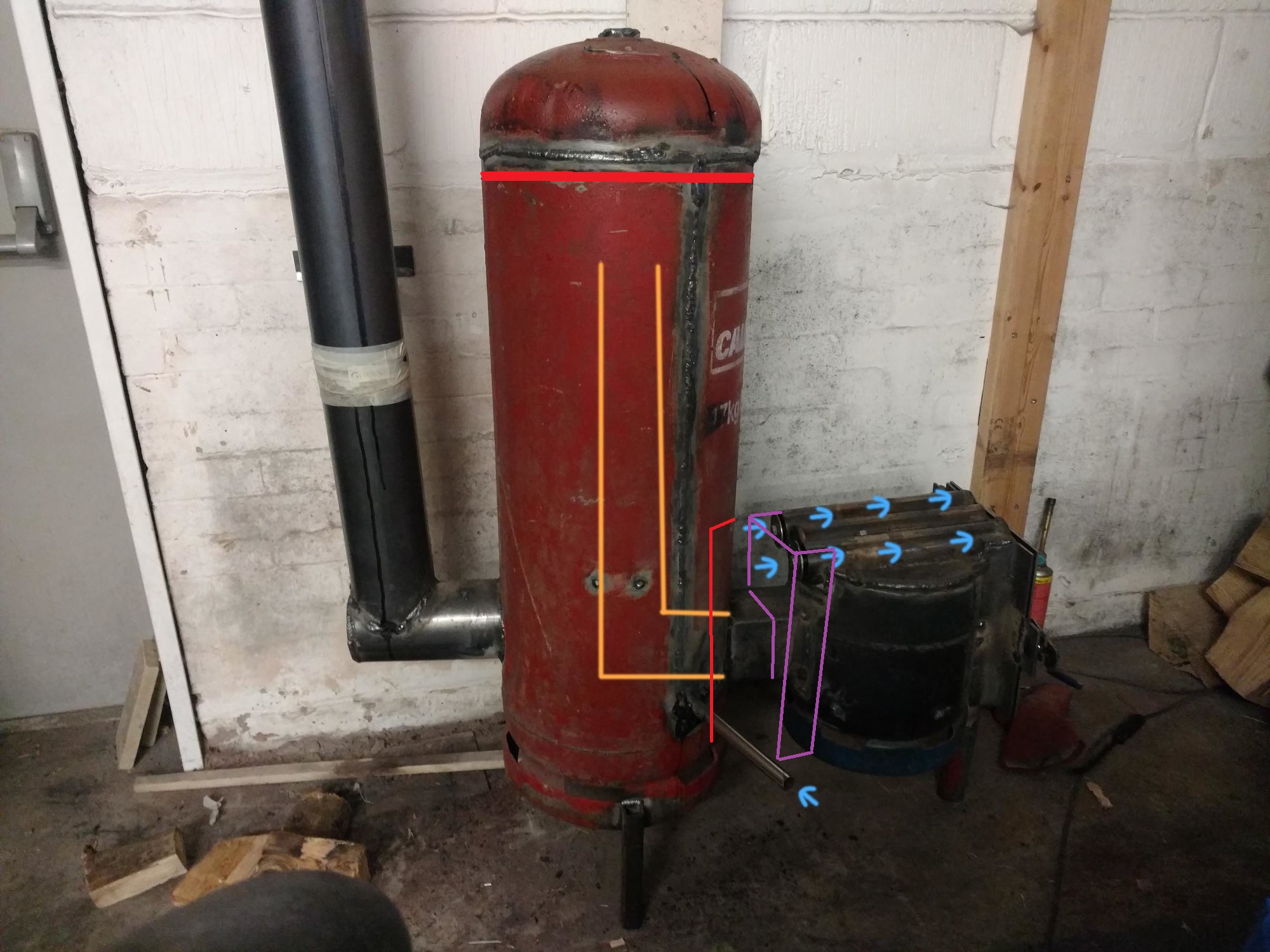

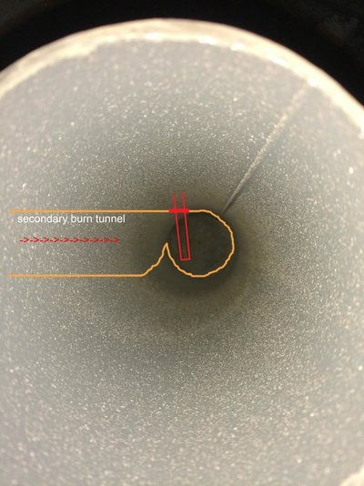

That makes sense, so you are still getting the heat that would normally escape up the flue. Your sketchup diagram looks spot on, I think I will try a garage version like that.
The rocket stove or rocket heater/burner is a fascinating and very clever piece of technology. The science behind it is equally fascinating which is how I got into them. Having said that, there are some fundamental design parameters you really need to get in the right ballpark; size of the firebox vs. size of flue and size of the primary air inlet. They need to be within a certain range of proportions. Remember you're building an air pump and air is heavier than you think at this altitude.

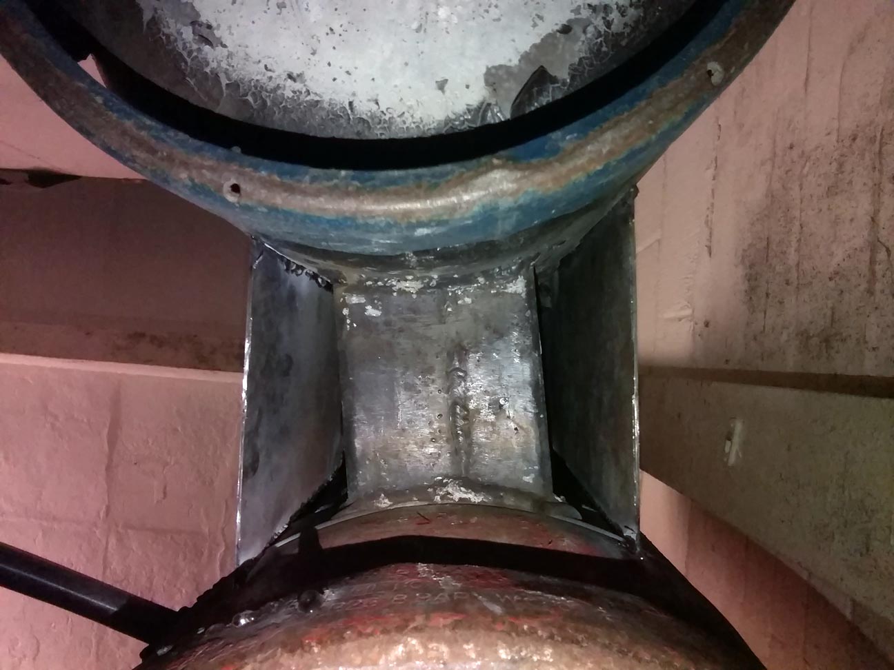

I cant hold my hand on the exchanger but compared to the firebox which is 10x hotter, if that gives you an idea.
... you have me worried now
