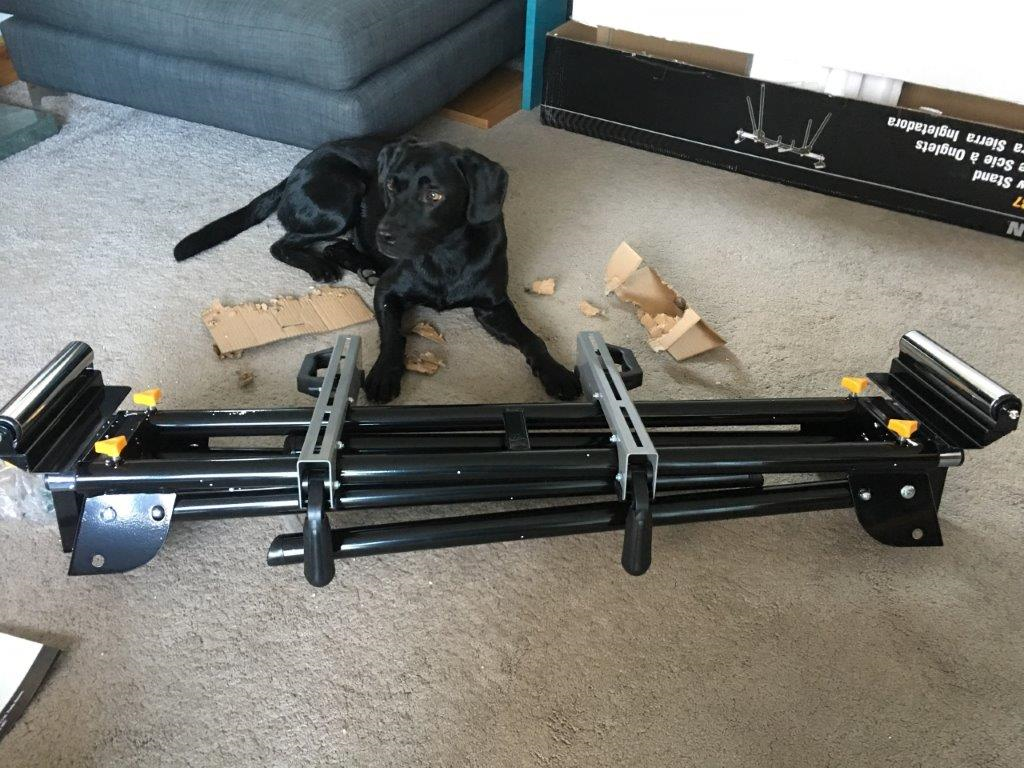

Unboxing
The box it is delivered in is pretty much the size of the unit when it's assembled and folded.
(dog costs extra)
all the bits, and a free dog chew toy
Some of the other generic brands have a single arm, but I expect that dual arms would be more stable

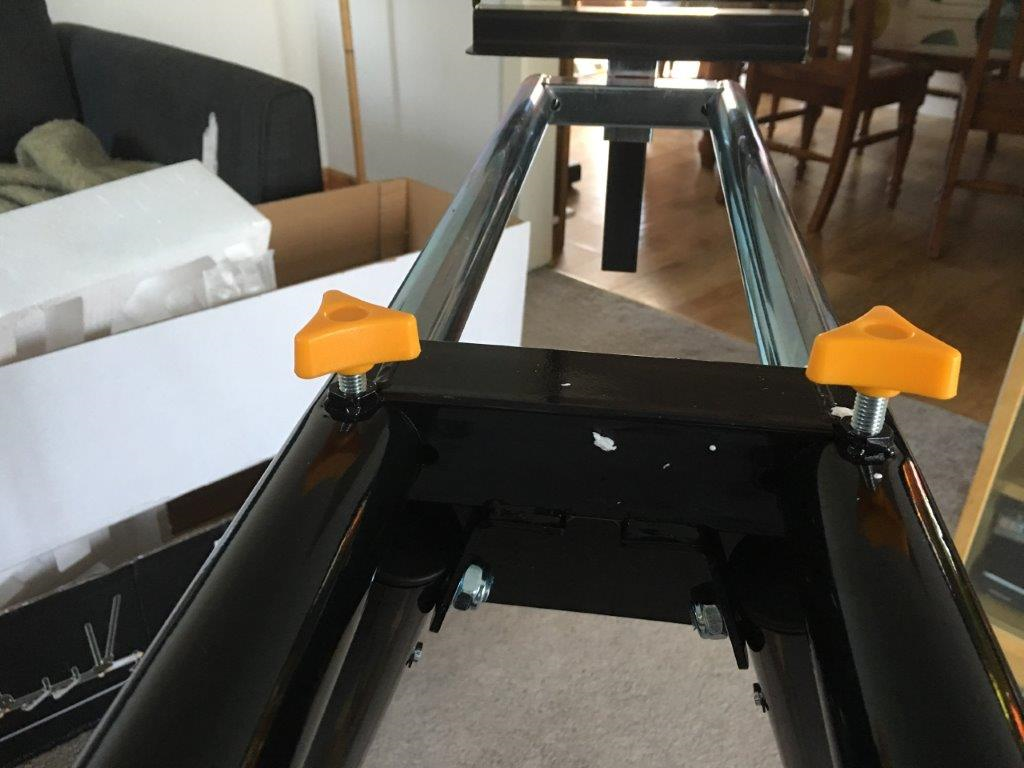

Folded up

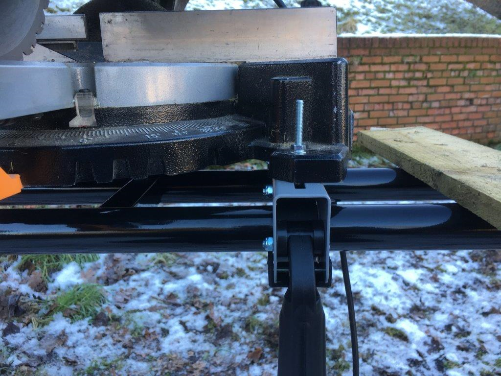

Fixing the saw
It was obvious in hindsight, but the feet on the Evo Rage saw foul the fixing, so they need to come off:
Yep - that's better...

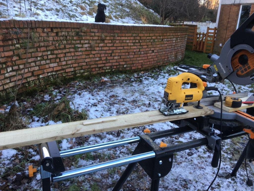

In action
Moving the saw and the sliding arms back and forth, and the rollers up and down:
And in action:
