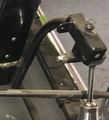

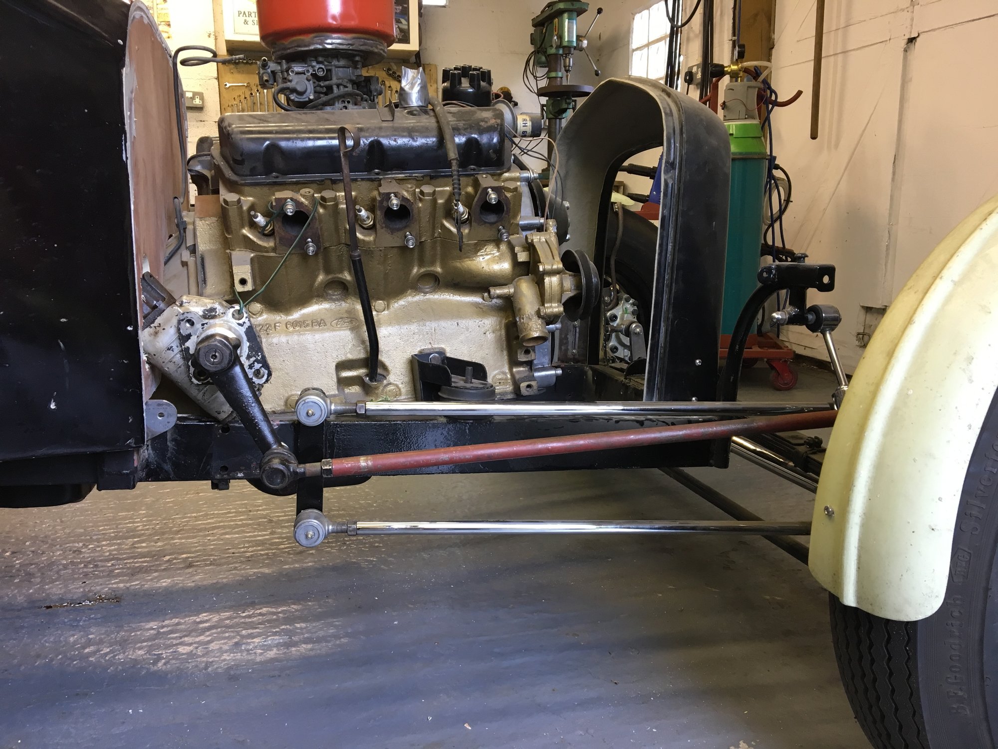

I have adapted a Landrover steering box for my hot rod, and plan to use a drag link from the same. However, I discovered the taper for the track rod end is in the wrong side of the steering arm.
I planned to put it in my lathe and taper turn it on the other side, but it is too long.
So, any suggestions? I’m thinking of cutting it in a V shape and simply re-welding it the other way round. Obviously it needs to be a good weld. And maybe add a reinforcing strip to the back face.
It is designed for a vehicle twice the weight of mine, so there is an excess of strength in the arm to start with.
The steering rod is temporary and will be replaced with correct length.
