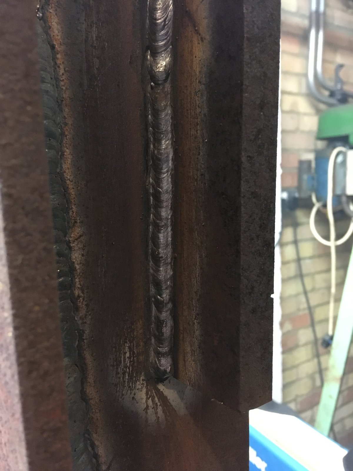

That was run at 125 dcep. Sounds a little low on juice but I could really see it burning in. That was v up
This.Not sure what these are made of but I should first of all warm it up a fair bit to help with cold cracking
This.
That should of absolutely being heated up to 100°c and held to soak for an hour. It’s obviously a high carbon steel to break like it did. My first thought was cast iron but your grinding sparks confirmed probably a cast steel. Still should of been heated though.
Also I don’t wanna come accross like a HnS **** but welding in an area like that is just asking for trouble. That bench was a total tip and fully loaded with combustible materials. I know you don’t do loads of welding but oily, greasy materials, rags, packaging etc will soon see your pride possessions up in flames if you make a habit of it. You want a nice clear bench if your going to weld and grind.
Yeah they looked quite yellow/orange and plenty of them so I’d say almost certainly a steel and the fact it’s a brittle break would suggest a cast possibly high carbon. Some research would probably confirm. Based on this limited observation in the video I’d say you’ve hit it with a good consumable 7016.Interesting observation re: sparks. I'll have a look myself.

That's it for today though. I was trying to level up the jaws because they're off. Probably took some effort to break the thing in the first place and I had assumed they'd match if I was careful to reposition the jaw where it had been.
It looked like you'd left a large gap between the rear of the insert and the jaw. That's likely why it's off kilter, as it'll be facing downwards.

That’s a nice clad repair.
It’s cleaned up well.
Doesn’t matter if it’s not as tough as the original. You’ve built it up with weld so once you’ve banged a few dents in it you weld it again.
