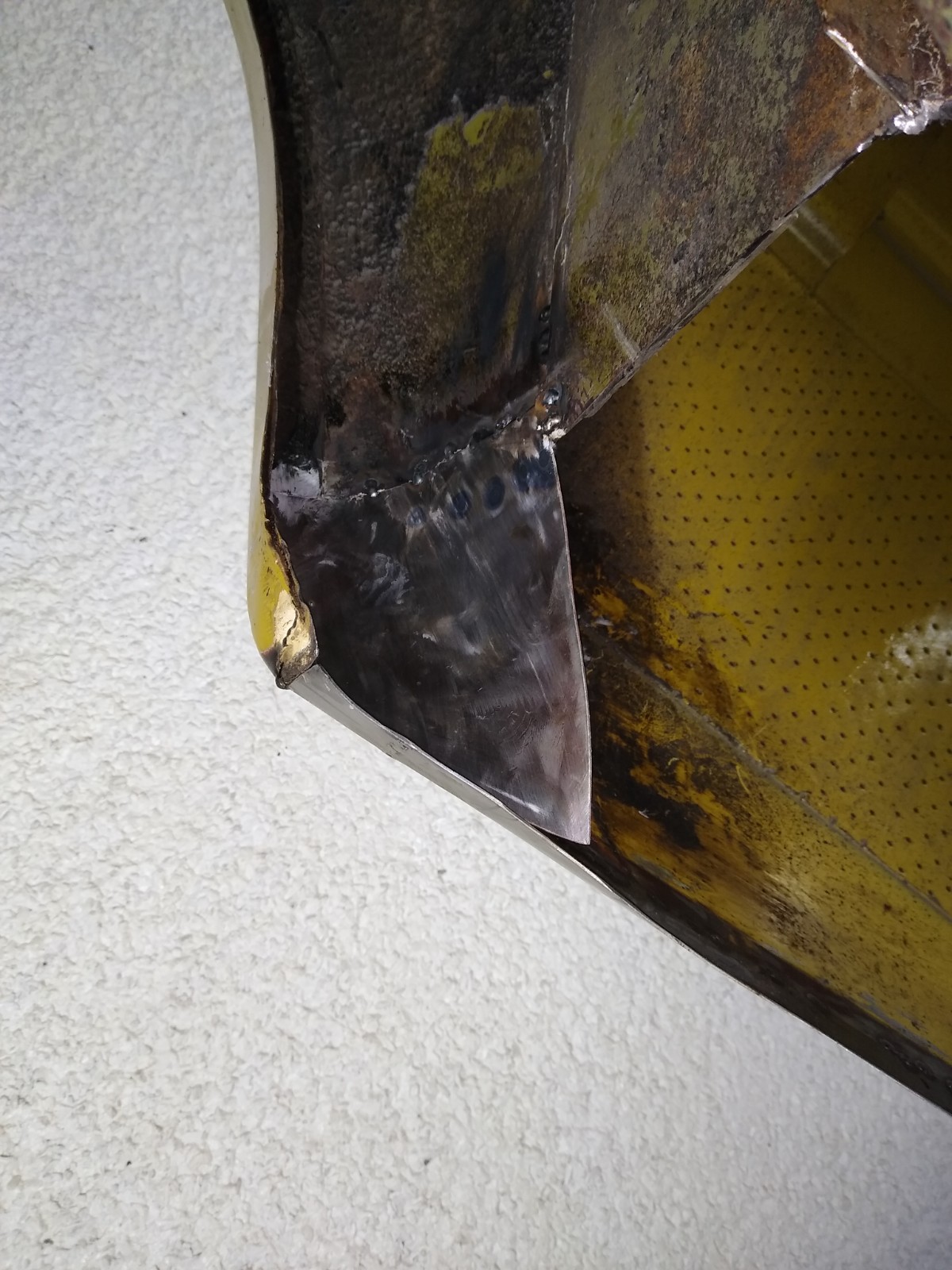

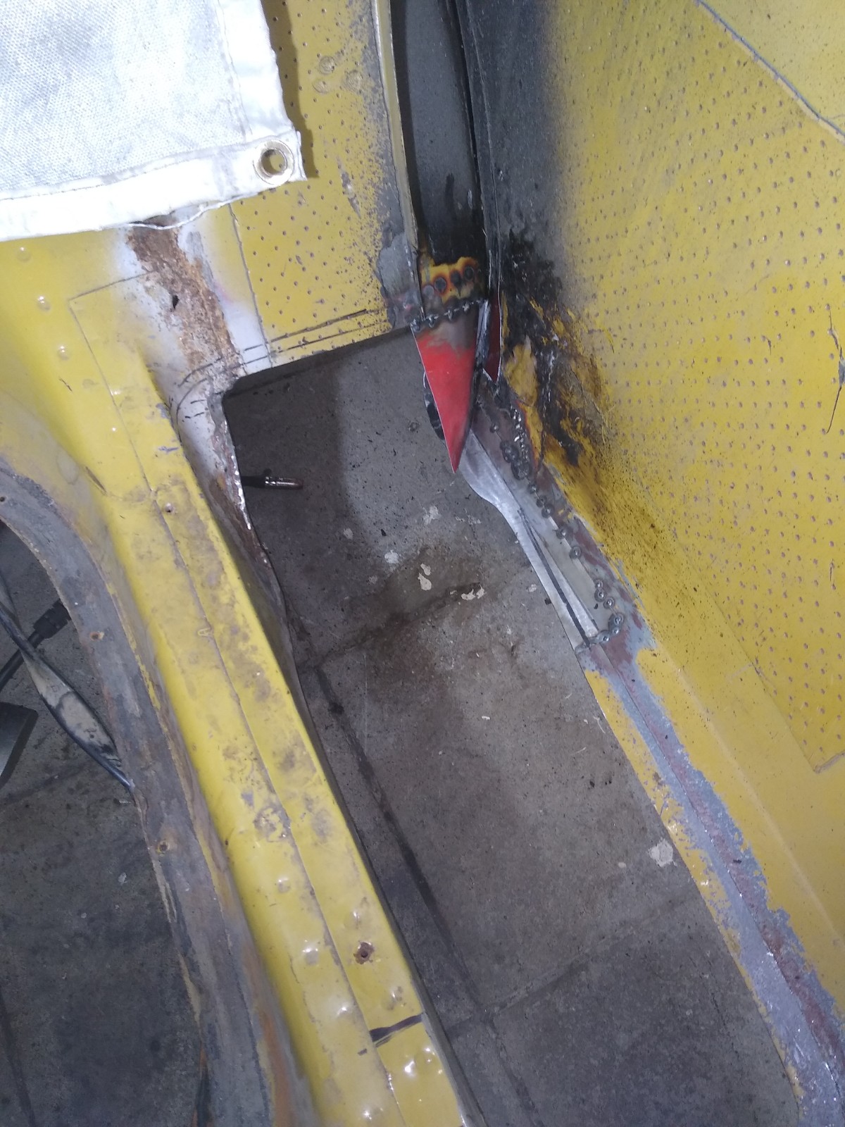

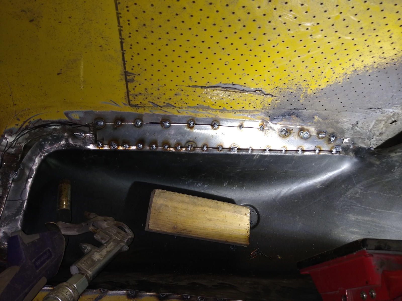

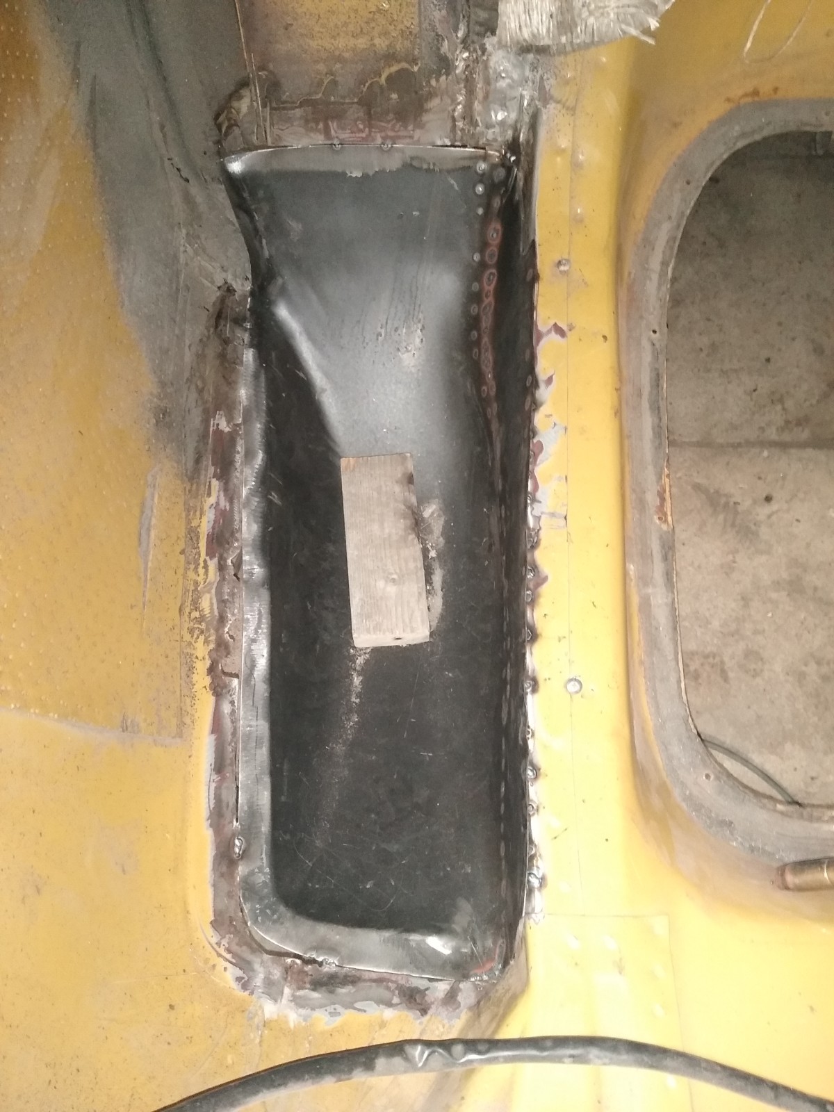

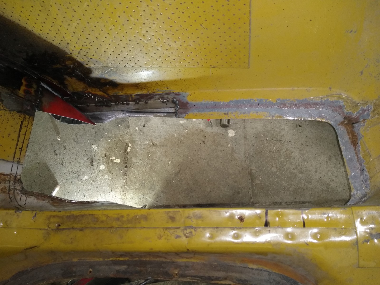

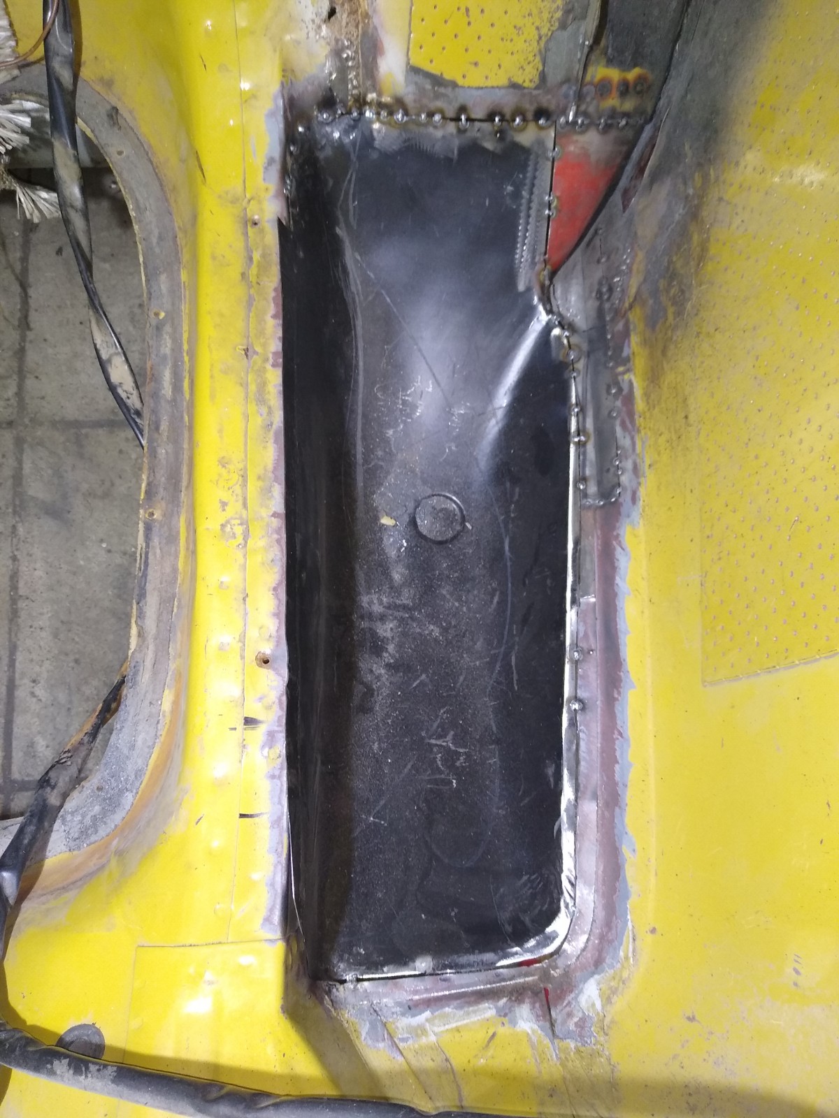

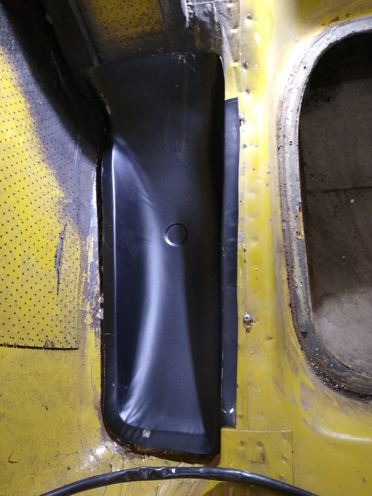

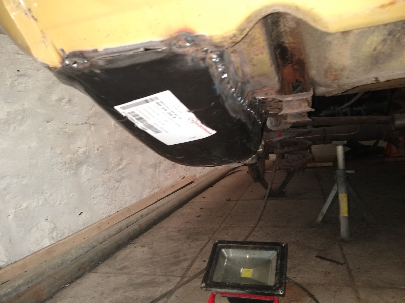

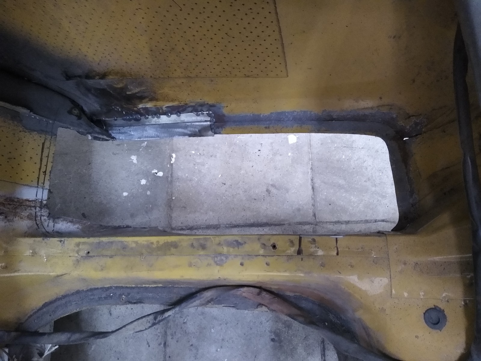

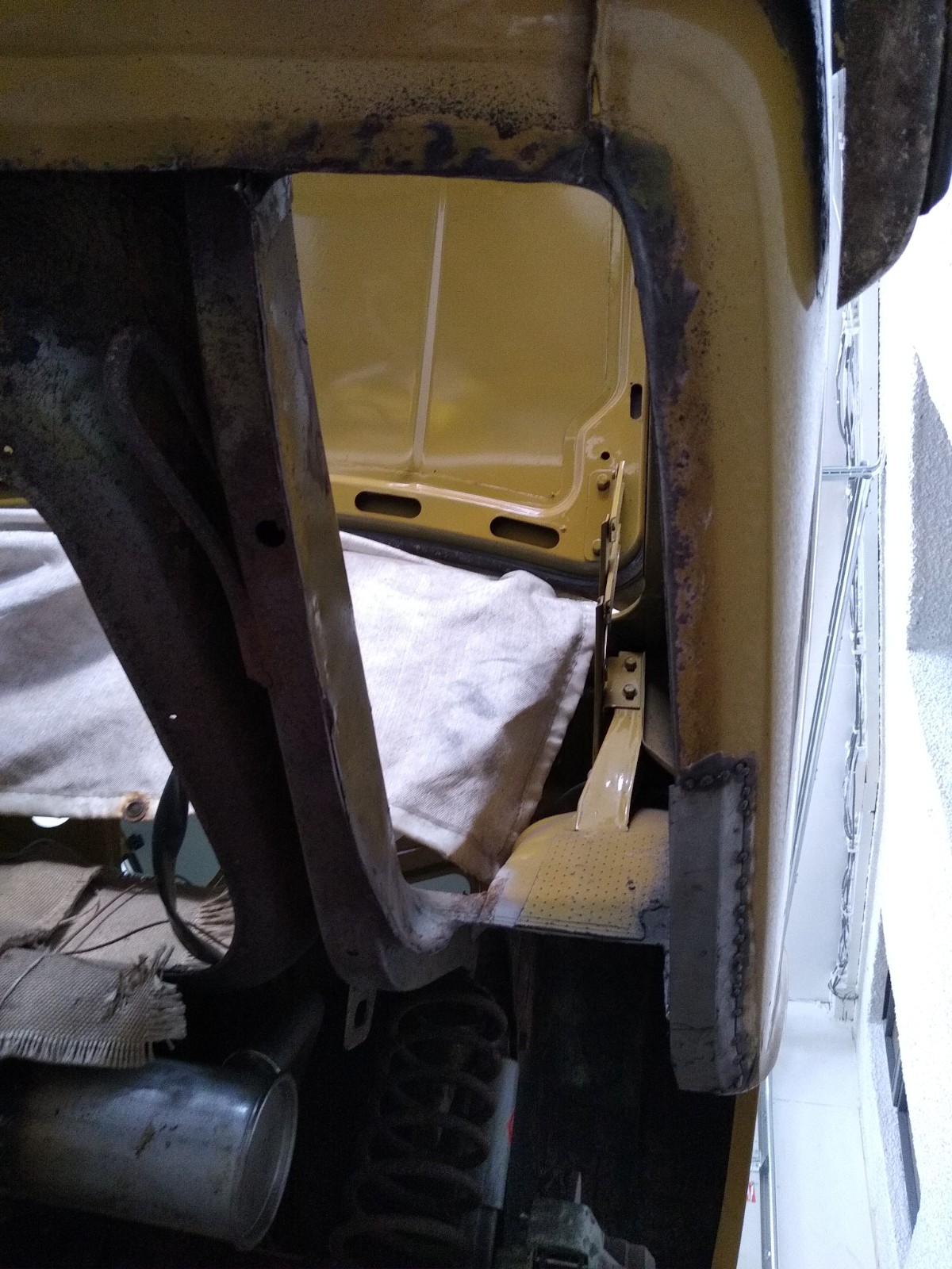

I like that bending machine it looks a very handy toolPrepping for replacing the rear outrigger, all the bits are made and just a little surface prep and I can weld everything in. Welded in one small repair already. Took me about 8hrs so far to prep everything so a bit slow going. Made a new outrigger with my little Gabro, it couldn't quite bend the small flanges so I had to finish them with a hammer. The outrigger is 2mm thick. Will get it all welded in this week after work is the plan.

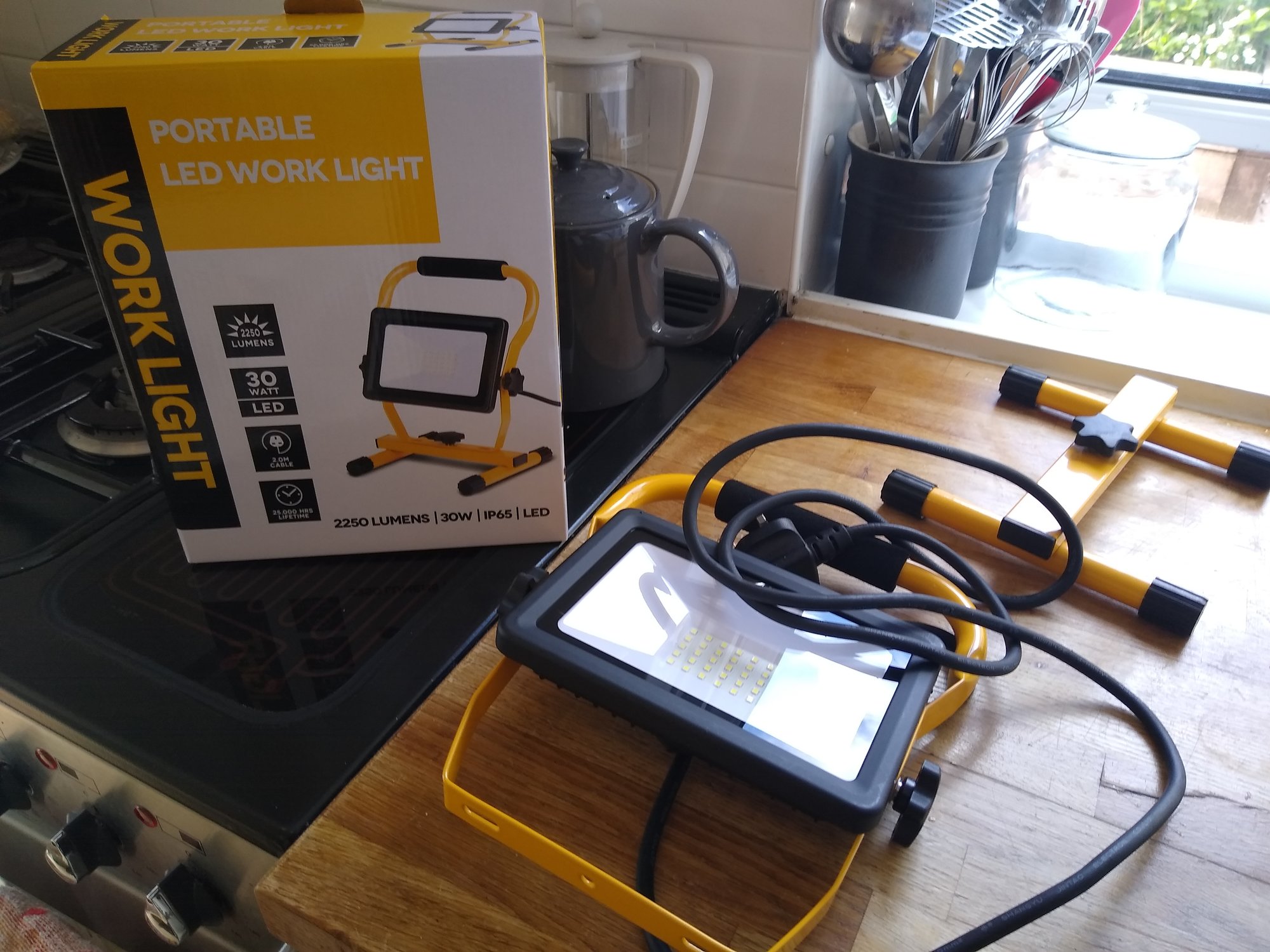

you soon have it done mate doing grand job what make is that light your using I could do with summat like that so I can see what im doing when welding it looks nice and bright it does
