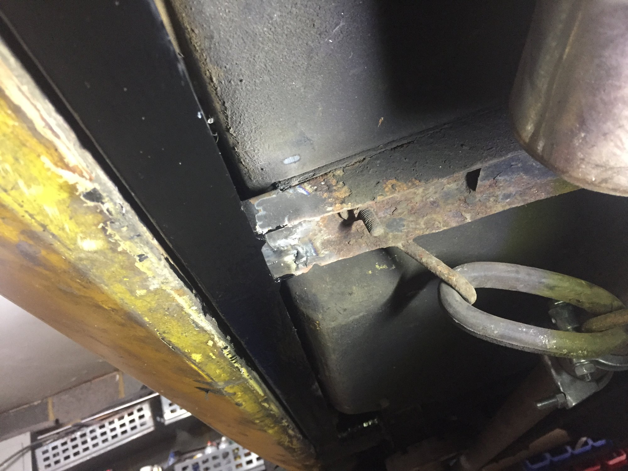

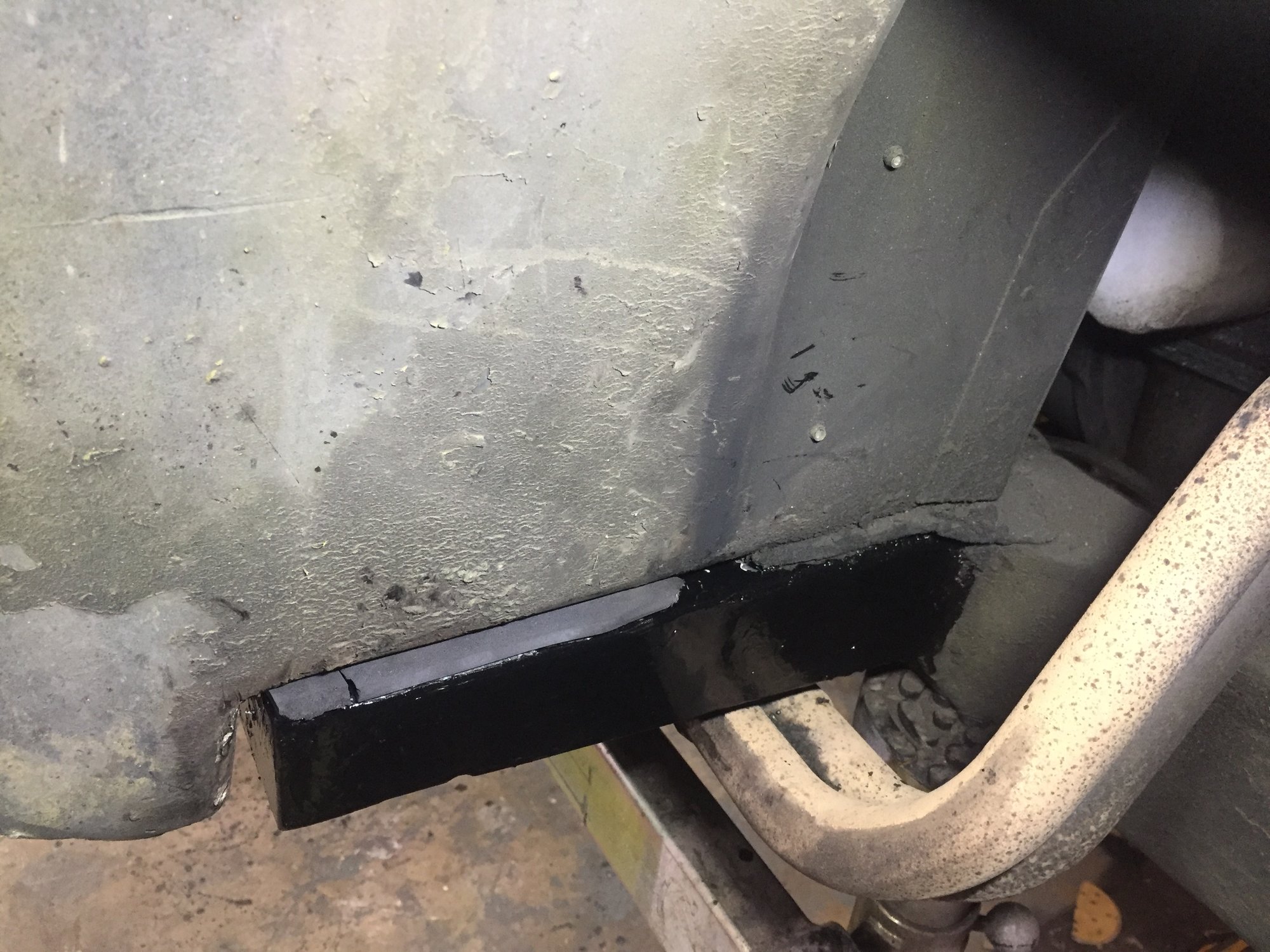

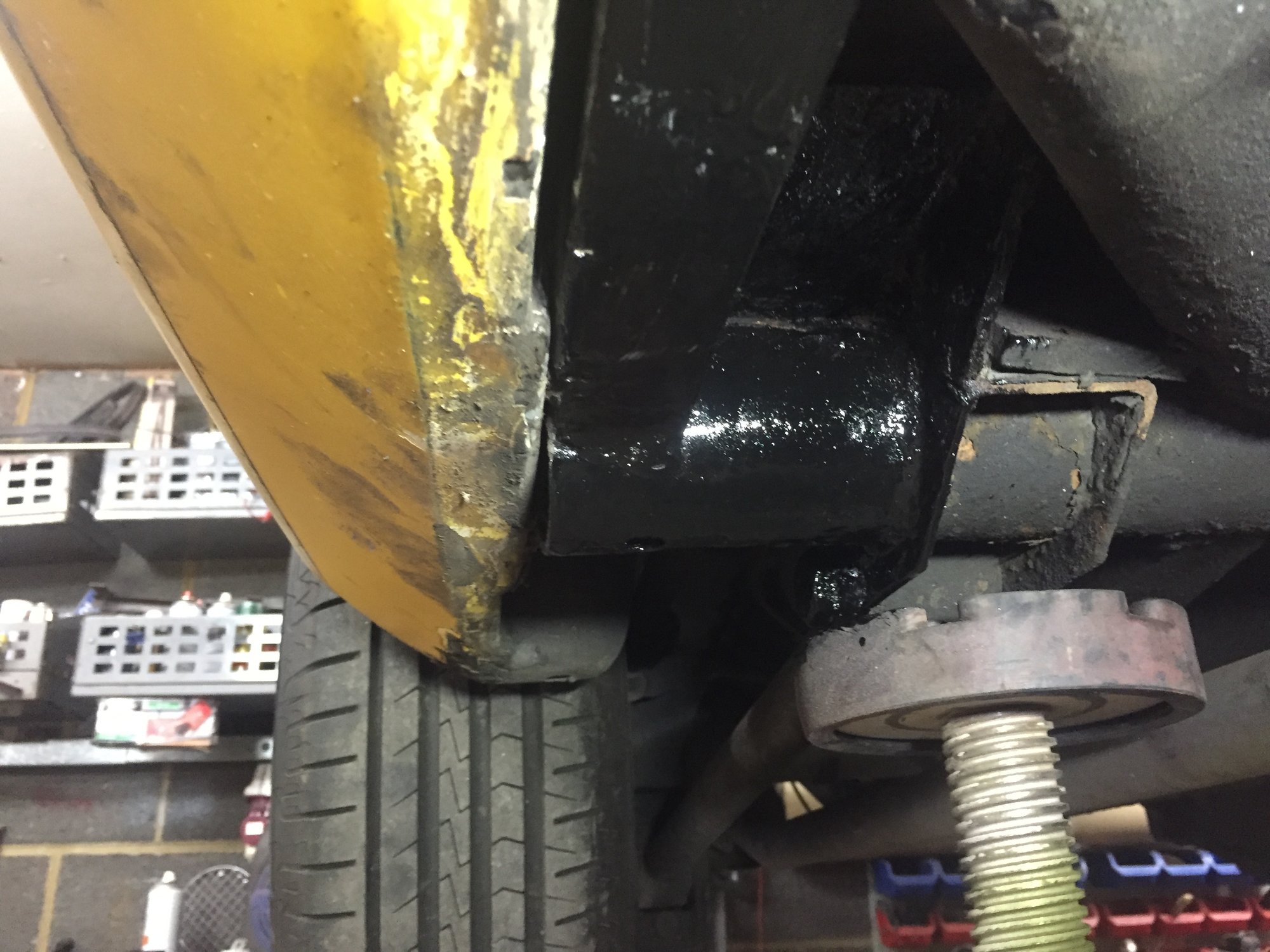

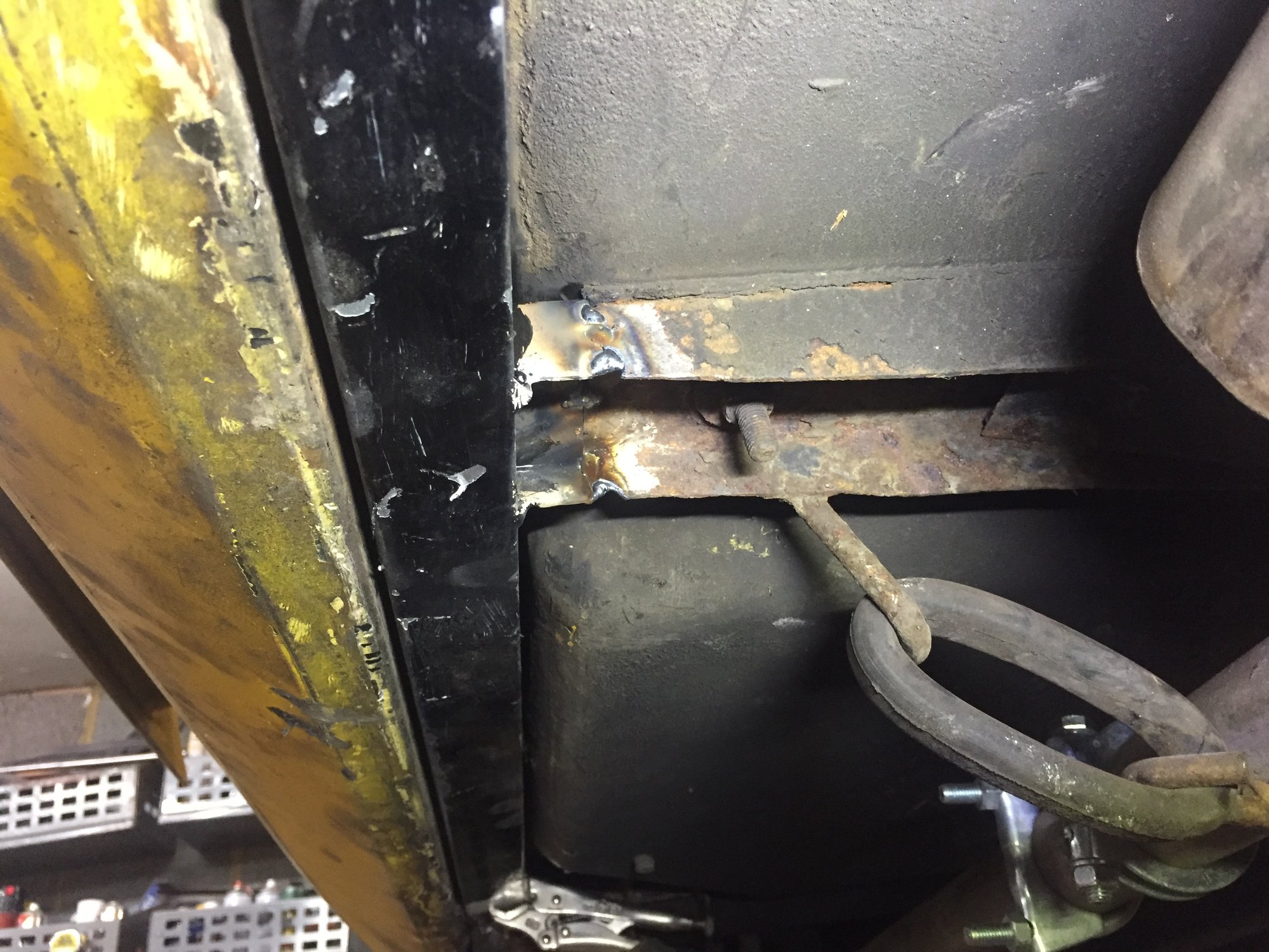

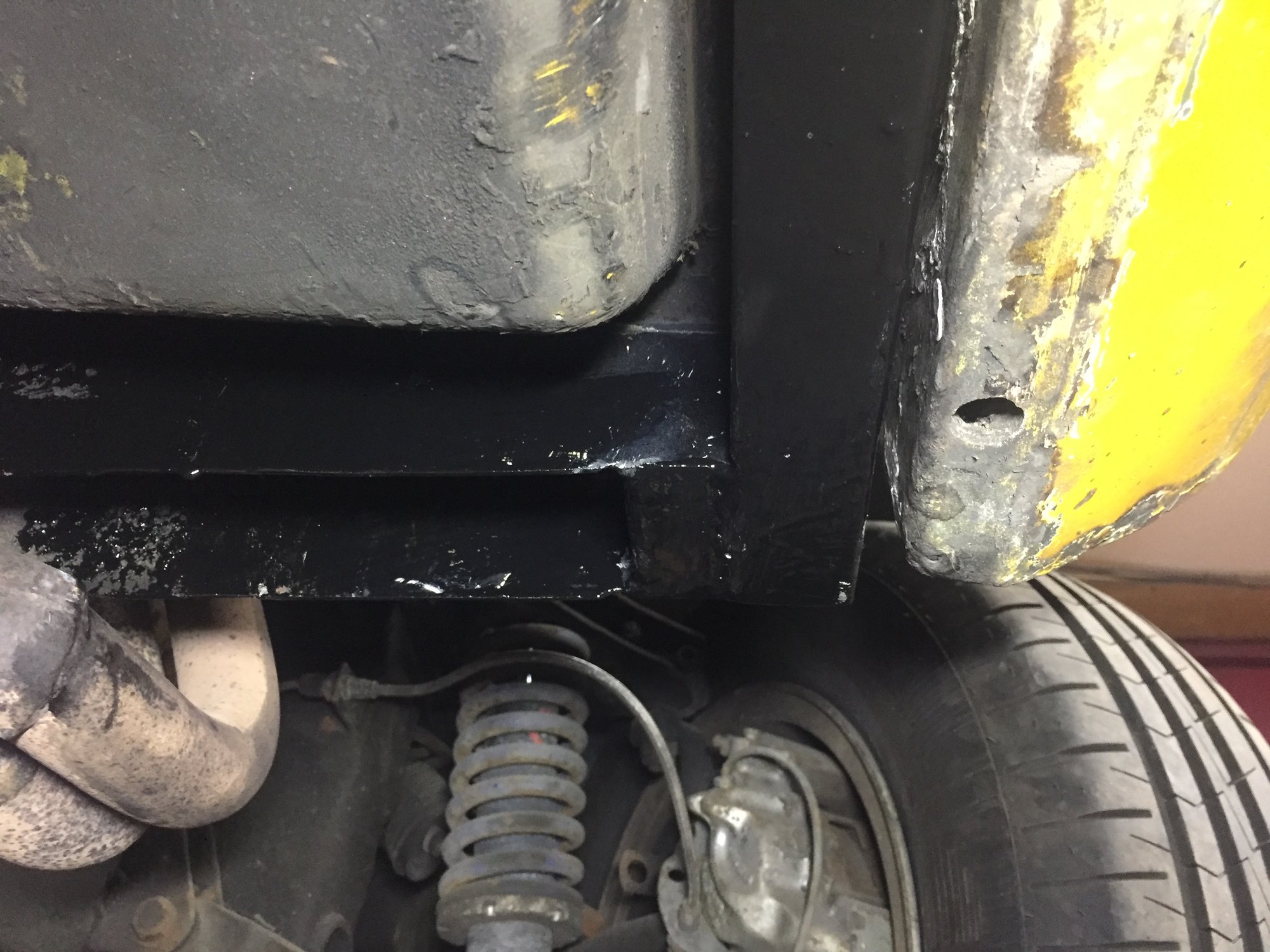

I had to do a bit more trimming but the rail is now all tacked into place. Had to buy a new gas bottle so final welding should happen to tomorrow.
Interesting to see how close you get the the FG without any damage.
Nice job @ajlelectronics . Do you by any chance have any more pics of where the side/ sill rail welds onto the transverse tube at the back by the seatbelt mounts? Access looks really tricky to me to get a weld on all 3 edges of the side rail? What tools did you use to hack out the old sections?Yes, it makes the foam smoke a bit, but no harm done to the fibreglass even welding along the top seam from underneath. All welded in now and painting has commenced. Just the bolts to fit back to the body to finish.
View attachment 163103 View attachment 163104 View attachment 163105 View attachment 163106 View attachment 163107
