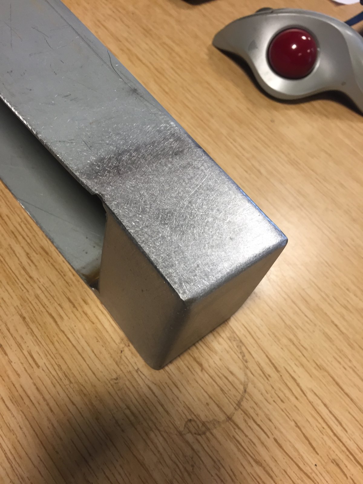

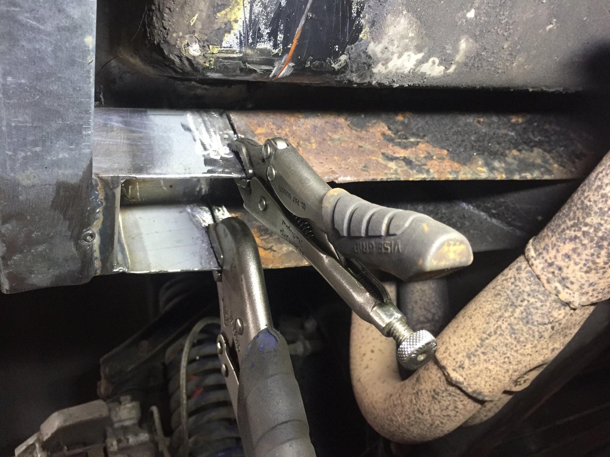

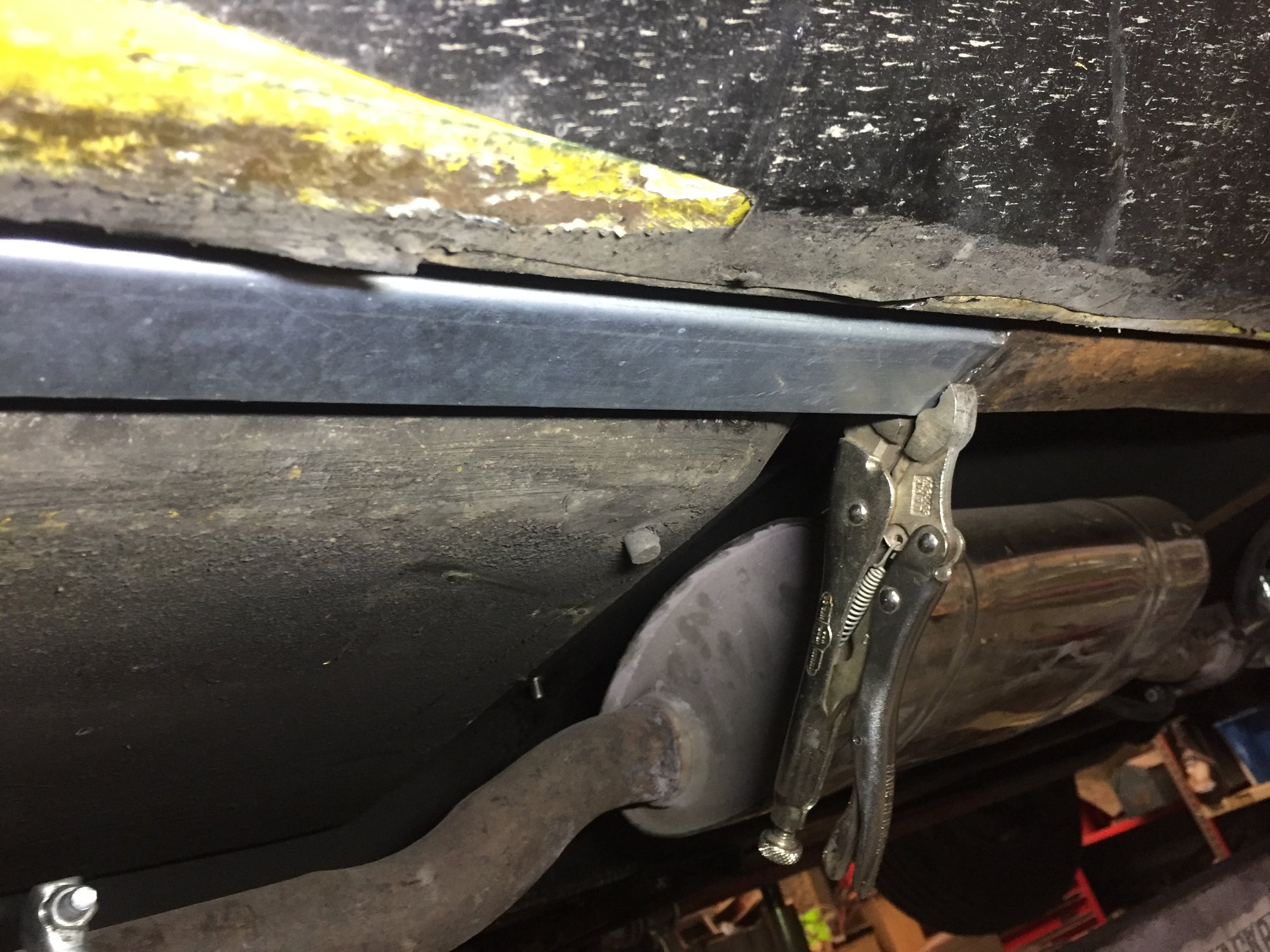

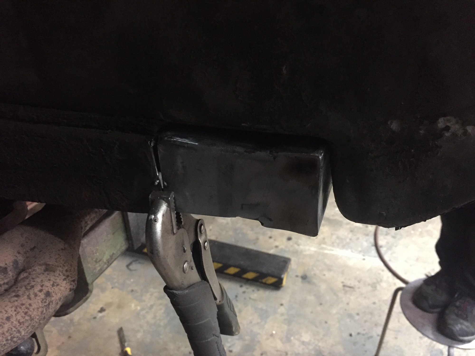

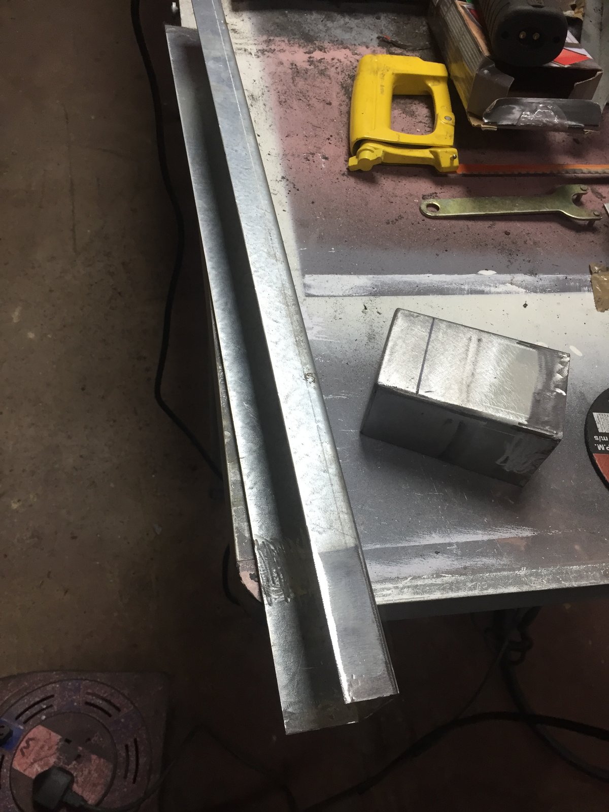

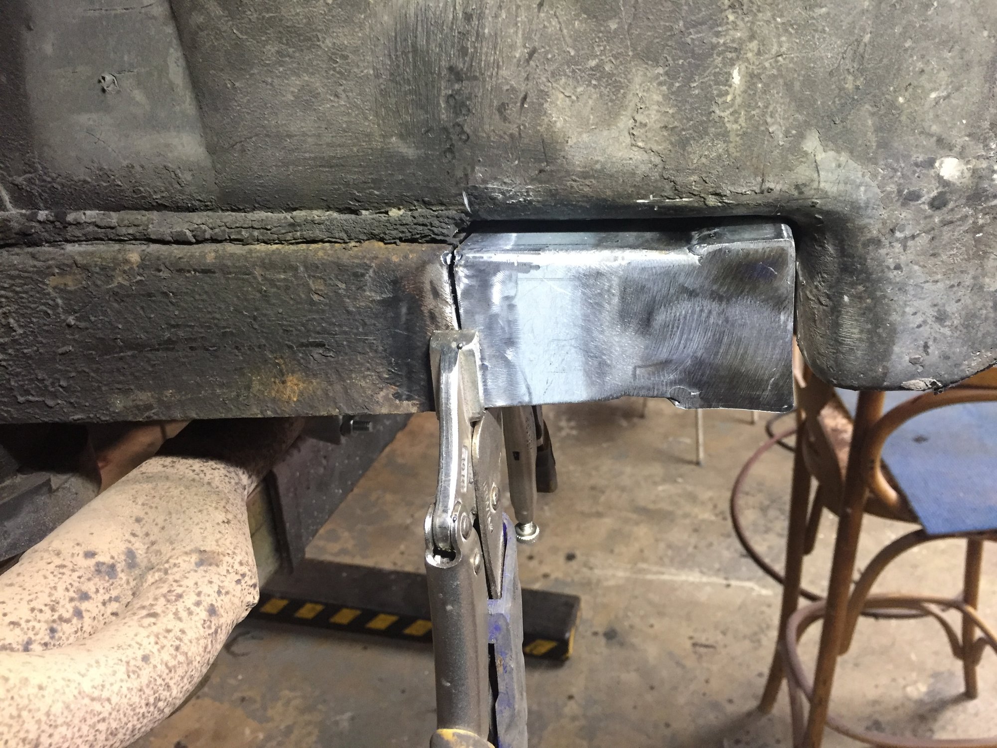

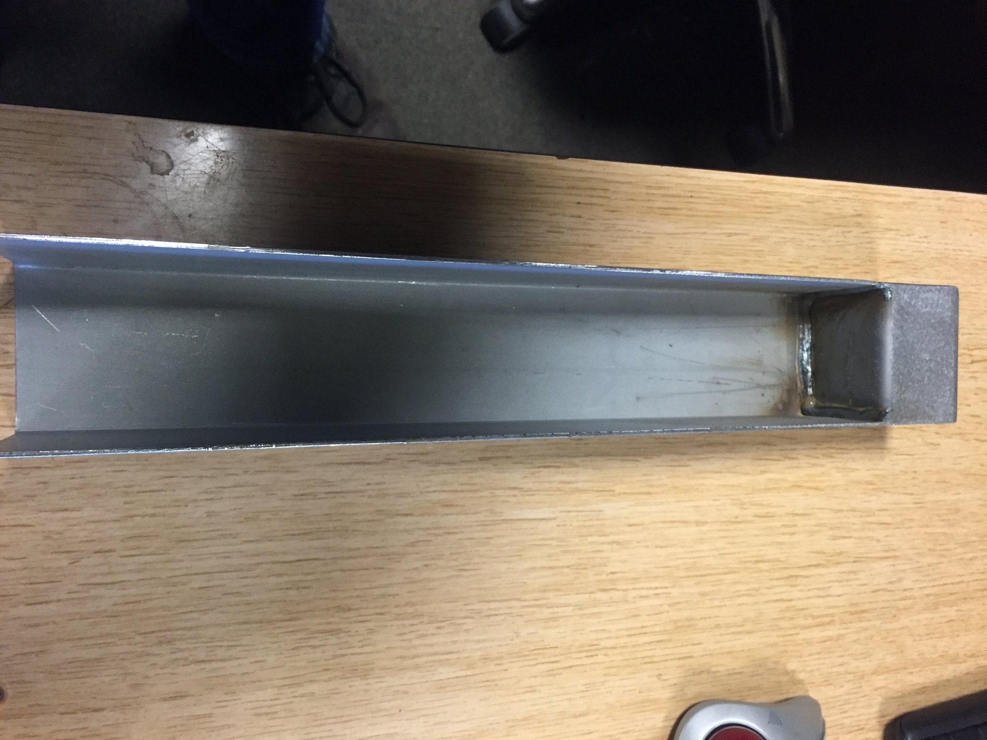

Hmmm, just realised that the chassis member is a different profile to the side rail I have in stock. Looks like I will have to fabricate the missing part from sheet 2mm steel. First thought is to do it in three pieces to make the C section, but would it be better folded? I have no folding equipment, it would have to be beaten over a block of wood.
Well find out what it is and maybe we could talk about it.
Yes it would be better folded, If you were closer I'd happily make it for you. The postage would be silly.Hmmm, just realised that the chassis member is a different profile to the side rail I have in stock. Looks like I will have to fabricate the missing part from sheet 2mm steel. First thought is to do it in three pieces to make the C section, but would it be better folded? I have no folding equipment, it would have to be beaten over a block of wood.
I think we're all secretly hoping this turns into a nut and bolt restoration with lots of pictures :-)
I've made loads of stuff in the vice but you do get a neater result with either a box pan folder or a pressbrake, is there no little engineering/welding places near you that would fold up a piece for a few beer tokens ?

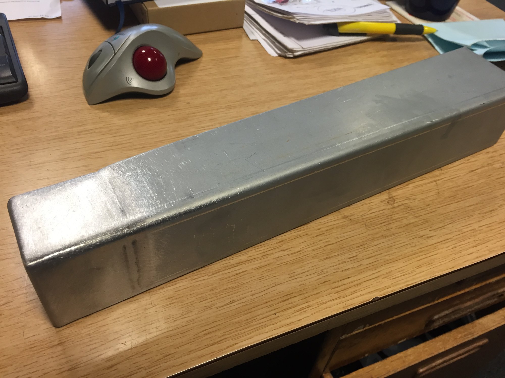

That bit of box next to the cut off looks shot on its inner surface wouldn't you say?
