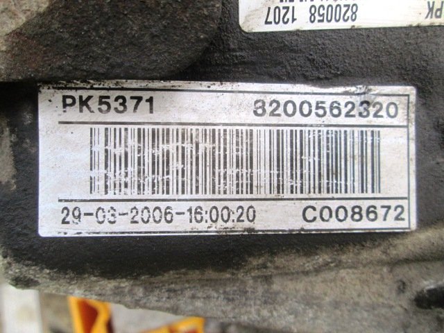

We have 2010 MK2 (one of the last ones) 2.5 DCi 120 with the 6 speed and....yes the wobble.
Already changed both drive shafts (right hand side was bad anyway, no pain with getting the bearing out) and swapped the engine mounts which were also bad but the wobble stayed.
Came across this issue somewhere else as well but asside from a picture of the cup that was all the information I could find.
Finally a came across a seller who sells the cups and the diveshaft tripod. Now I received a set but the tripod doesn't fit on the driveshaft but looking at this the cup will be the issue?
Are all the cups from the 6 speed the same? Because I am at the point of sending the set back to the seller but if the issue is in the cup and the tripod would nog be the issue and the cups are the same then I would still give it a go I think?
Or do anyone knows the correct number of a set like this?
Sorry for all the questions![]()

So you have a side to side wobble, and NOT up and down, worse when under power ?Firstly, your van @ 2010 should have the later PF6 gearbox, which has "normal" driveshafts on both sides, each with an inner and outer CV joint, which plug into the gearbox.
The tripod joint on the earlier PK6 gearbox, which they stopped making in 2006 is the one that sits inside the gearbox with the cup, so if you have this gearbox, it may have been swapped by a previous owner ? On the top of the gearbox next to the gearchange cable bracket is a sticker, which tells you the type and model of the gearbox, like this ......... This one is a PK5 (five speed) type 371
Check which gearbox you have . If it IS a PK all the cups and tripods are the same, as far as I know, but are difficult to find now. Do not bother with a used one.
Now, the later PF type driveshafts have inner CV joints that ARE the tripod type, but the tripod is smaller, which may be the ones you have, as they would be correct for the year and the later gearbox.
