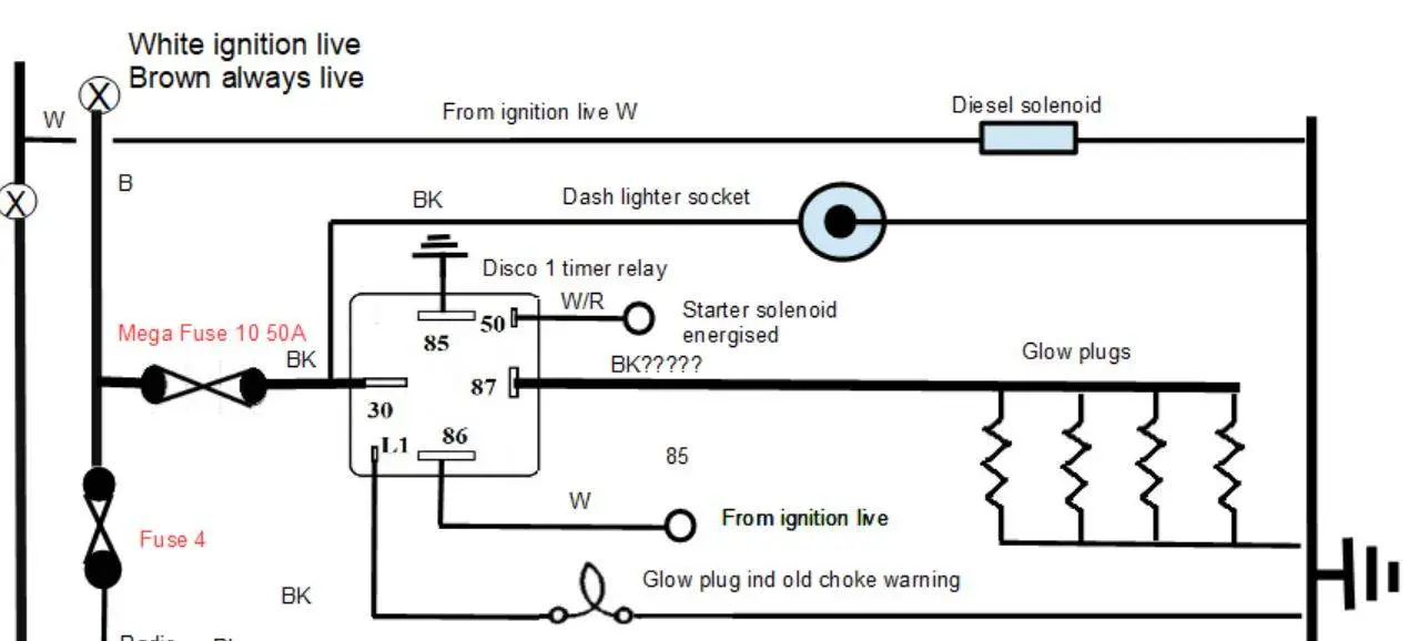

Dont bother with the glow plug timed relay......can be 160 quid depending on type.....
All I ever do is find a decent ign feed from the fuse box, or run a relay direct from a batt feed, via said push button..... run a wire from a HD push button switch...look at tractor gear old Massey n Fergy...cheap on line....
so to start ign on, press the new heater button for 10 sec's or whatever and off u go......
