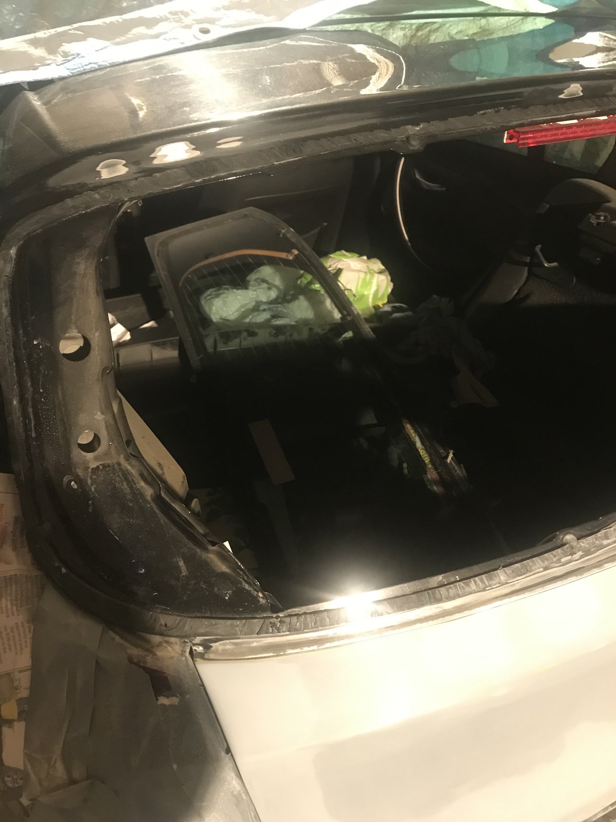

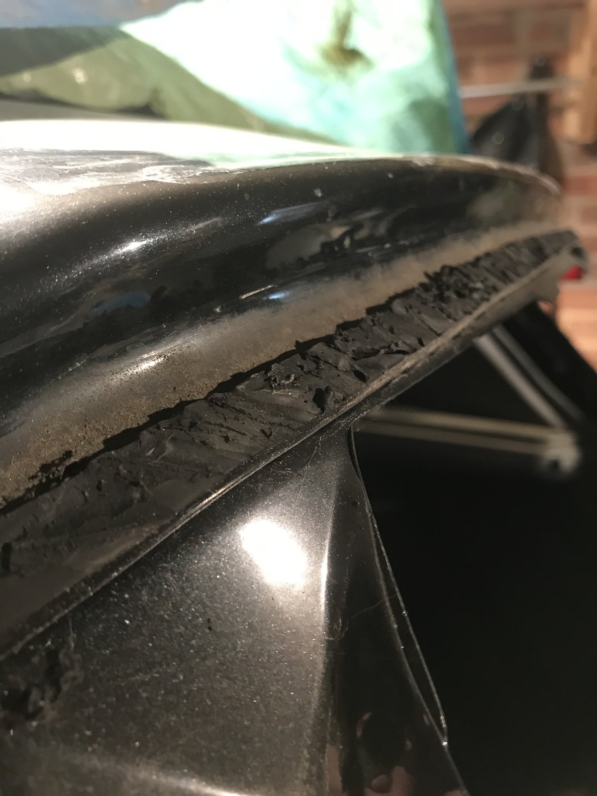

    I tried to paint under my rear window. I paint only to keep repeatedly breaking through it whilst sanding. I even made up a wd40 type tube for my spray can in an attempt to flood the void with paint and give me a lot to sand back with. Nothing works. I can never flatten that paint. It’s gone on far too long now. So, I decided enough was enough. The window was coming out. Anyone know what substance/glue remover will remove the rest of this sealant?
    Also, what is a good sealant for refitting when I’m done? If it’s too awkward a job to refit I’ll ask a window fitter to do it. Thanks.

    if its modern style of bonded winscreen sealant, the advice i was given from a window fitter was to not to remove the sealant fully. scraping back with a sharp chisel/stanley blade will give you room for new sealant and the best key. Plenty on the 'bay and the like of frost restoration etc.
    Any freshly painted areas will need to be keyed and primed with the primer that comes with the kits.
    Oh, and it seems to be a sackable offence for window fitters to do "Homers" these days unfortunately. Well, the couple of guys i spoke to anyways...
    Al

    Ok. Thanks. I’ll mask over the rubber that’s left then I think I’ll book it in for window fitting. Ill leave them to trim it back and re glue. I wonder how the hell they manage to cut the rubber out without damaging paint? As gentle as I was going I jabbed the knife into the paint in places. I really didn’t want to take this window out but it’s a last resort. Because it’s so bloody awkward to sand I cut through the original paint then had to re prime etc and I can never sand it without breaking through. I can’t wait until I’m working on the easier panels.

    did mine with a v sharp wood chisel. on its back it's not too bad to skim the majority off, but yes, you do hit the odd panel join/spot weld in places!

    This sealant was rock solid. The amount of force I had to put on the knife. I even tried a pumpkin carving saw until the handle broke off. I think I might have to mask a line off the where the body disappears behind the glass and respray that strip just in line with the damage. It’s going to rust like hell otherwise. Or maybe I’ll just dip a brush in some primer, base and clear and do some spot repairs. Hell of a lot of extra work otherwise.

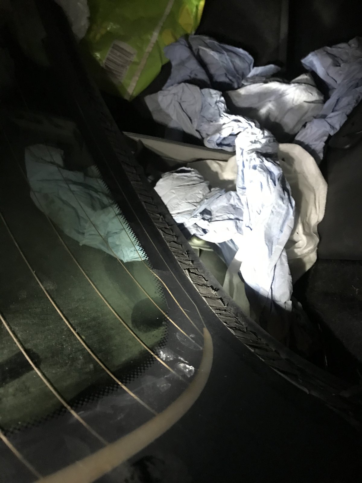

    I just tried the window back in place. I’d see a line if I tape off the scratched area and only paint that. Looks like I’m going to be re painting the whole lot now. Or at least priming the scratches, spot spraying the base then re clearing the lot.

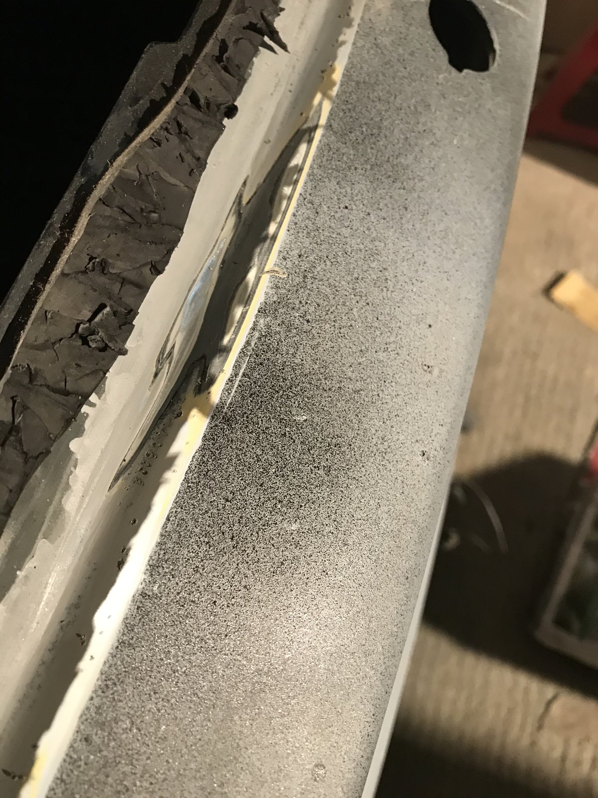

    Going to re spray all damage now. At least I can get the sandpaper in now. That bloody screen was doing my nut in!!!!

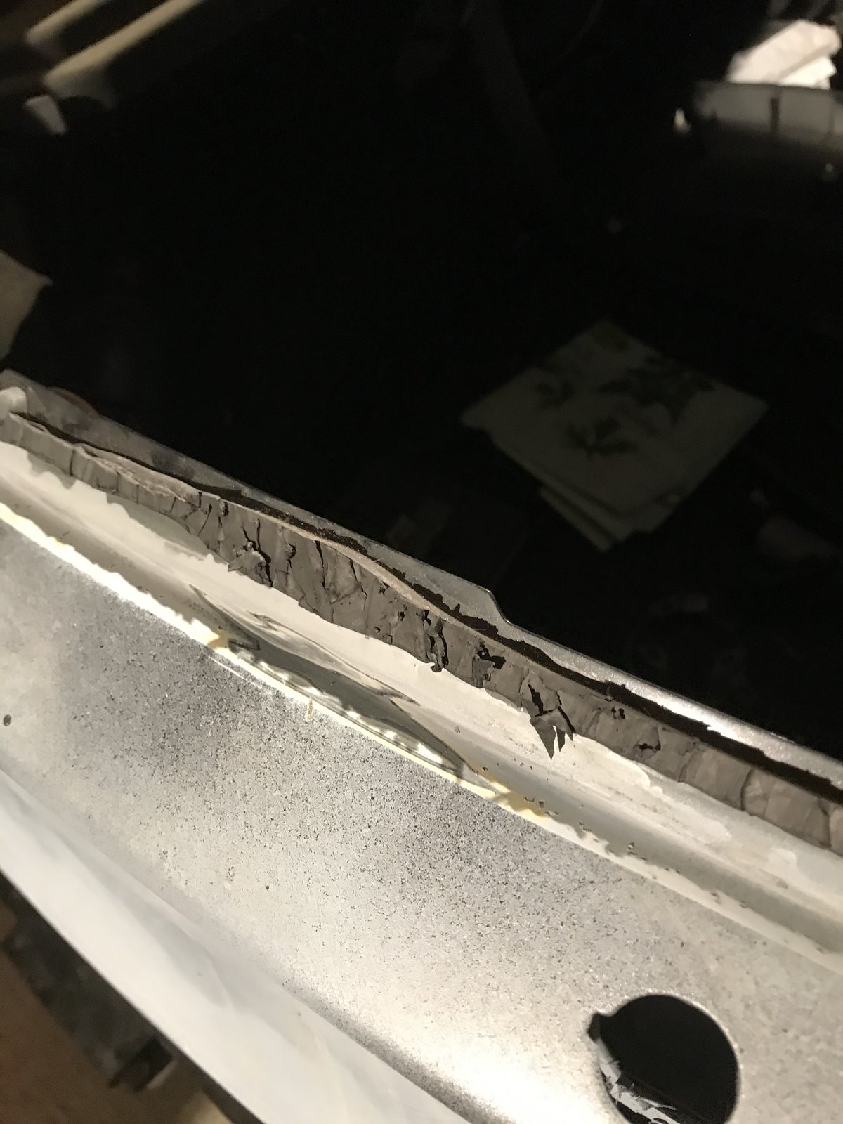

    You can buy a scaper/ chisel type blade that fits a multi tool cuts the polysulphide a piece of pee .
    many proper glass fitters use them in a cordless tool ( from the inside ) no paint damage !

    That’s the plan now when the paintwork is done. It was hard enough getting the bastard thing out. I wouldn’t know how much of that rubber to trim back before applying some adhesive and refitting the window. I know how to cut it out next time though. I found out you just poke 1 hole then thread a cutting wire through it and around the perimeter of the windscreen sealant. Then you sit inside the car and keep sawing using two handles attached to the wire. At least I know for next time. Good job I’ve got to respray this panel anyway, so the jab marks I made aren’t too much extra work.

    I think I would maybe have done even more damage if I was let loose with that . It’s bloody difficult trying not to go to far unless you can set the maximum cutting depth of the tool? I found a wire tool for cutting out the sealant. You make one hole carefully. Thread the wire around the windscreen rubber perimeter and back through the hole then use two handles on the inside to saw the rubber out. I know what options I have if I do this again.
