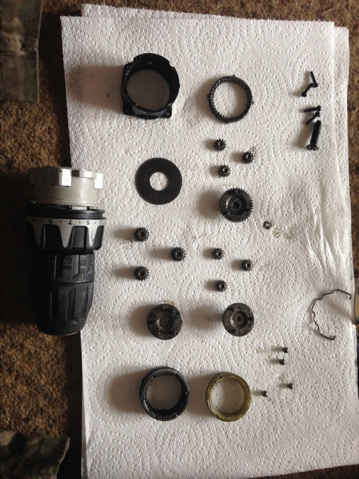

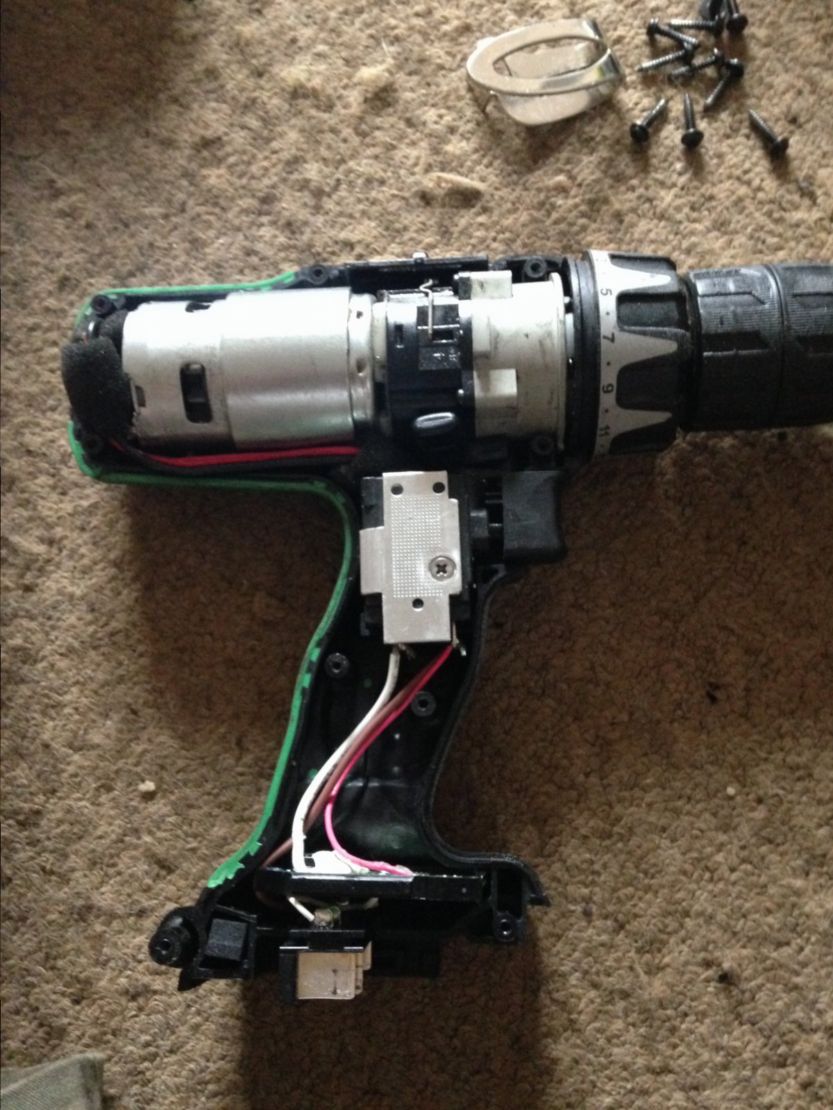

I have never seen an "exploded" battery drill.
i will be delving back into this tonight so am happy to take some pics for you.
Could you make some photo?

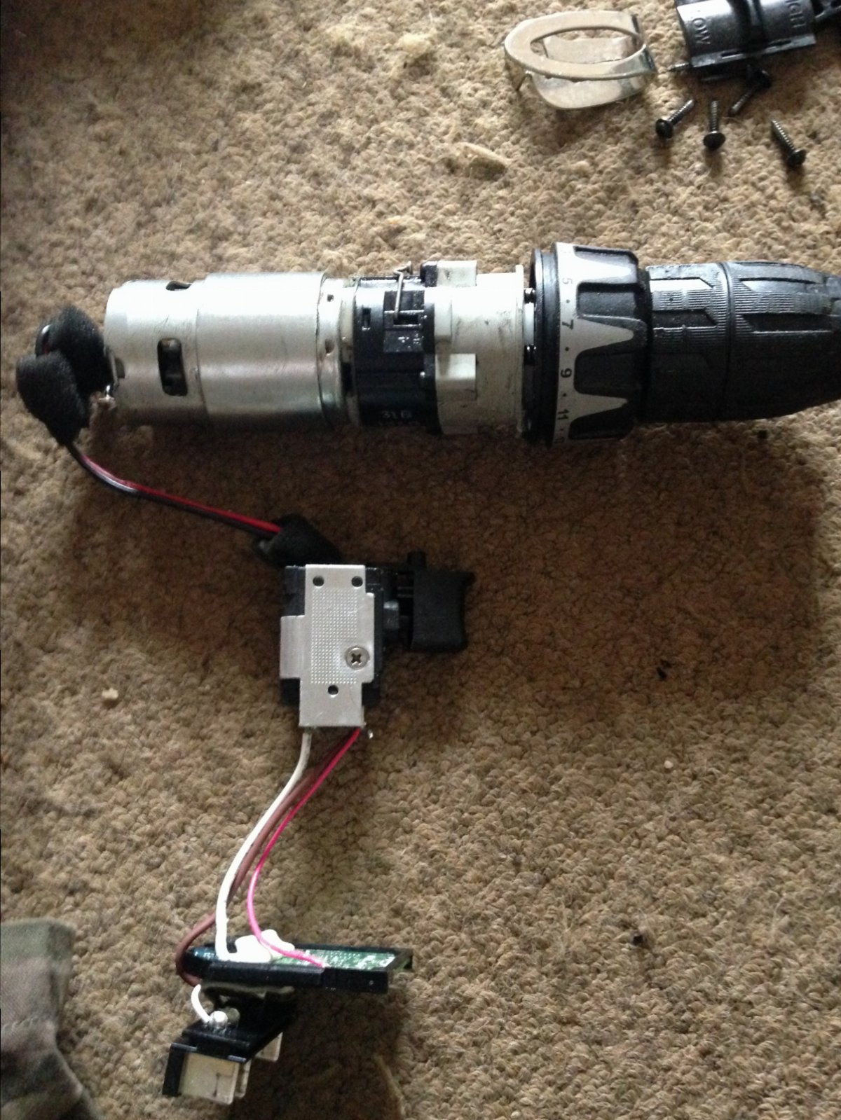

its a 2006 model. DV18DMR... 2 of the 3 batteries still hold a reasonable charge too. Was top of the range at the time. 10 years out of a cordless drill with medium (ab)use, I think i've had my moneys worth. £98 for a new gearbox

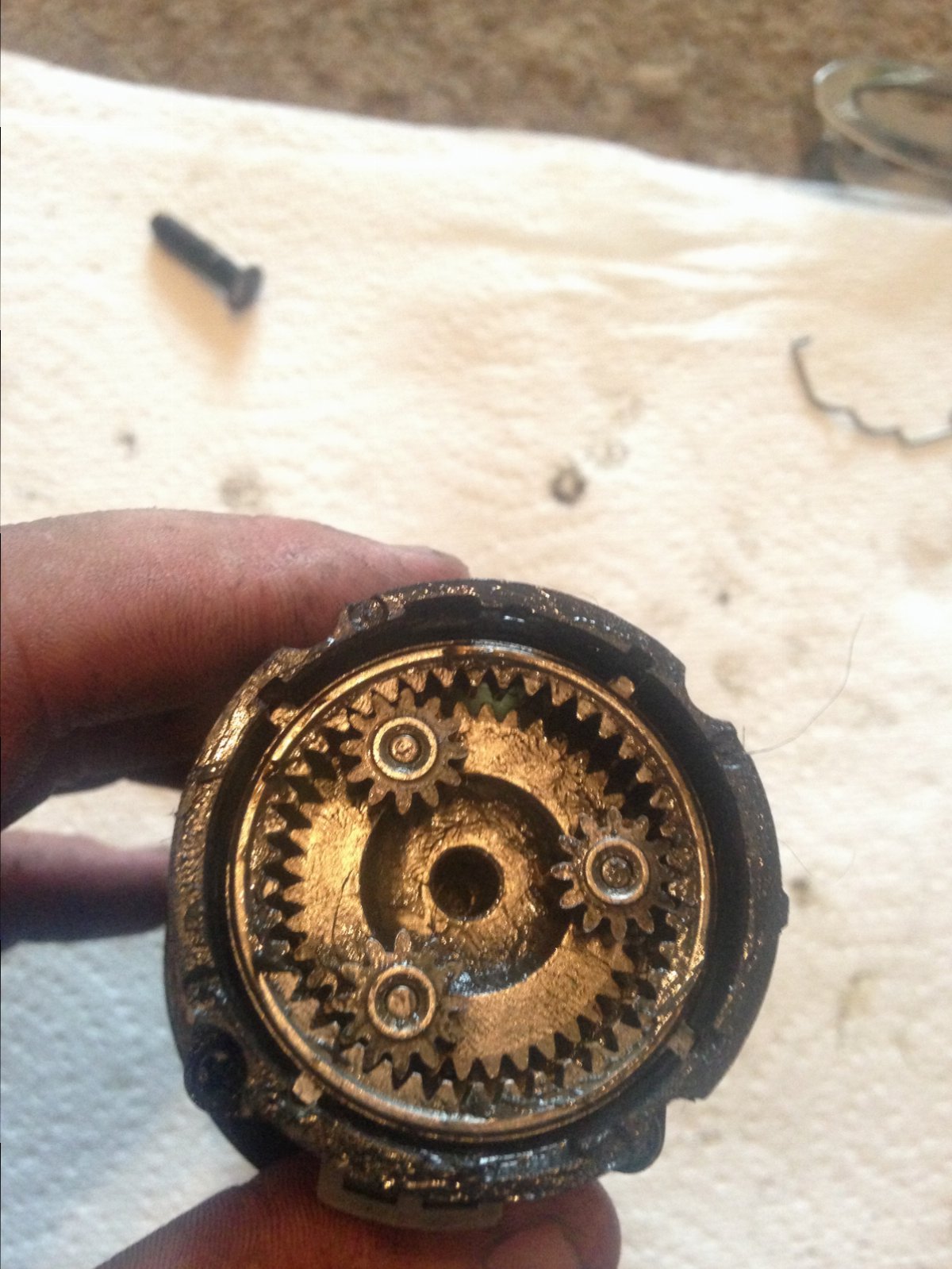

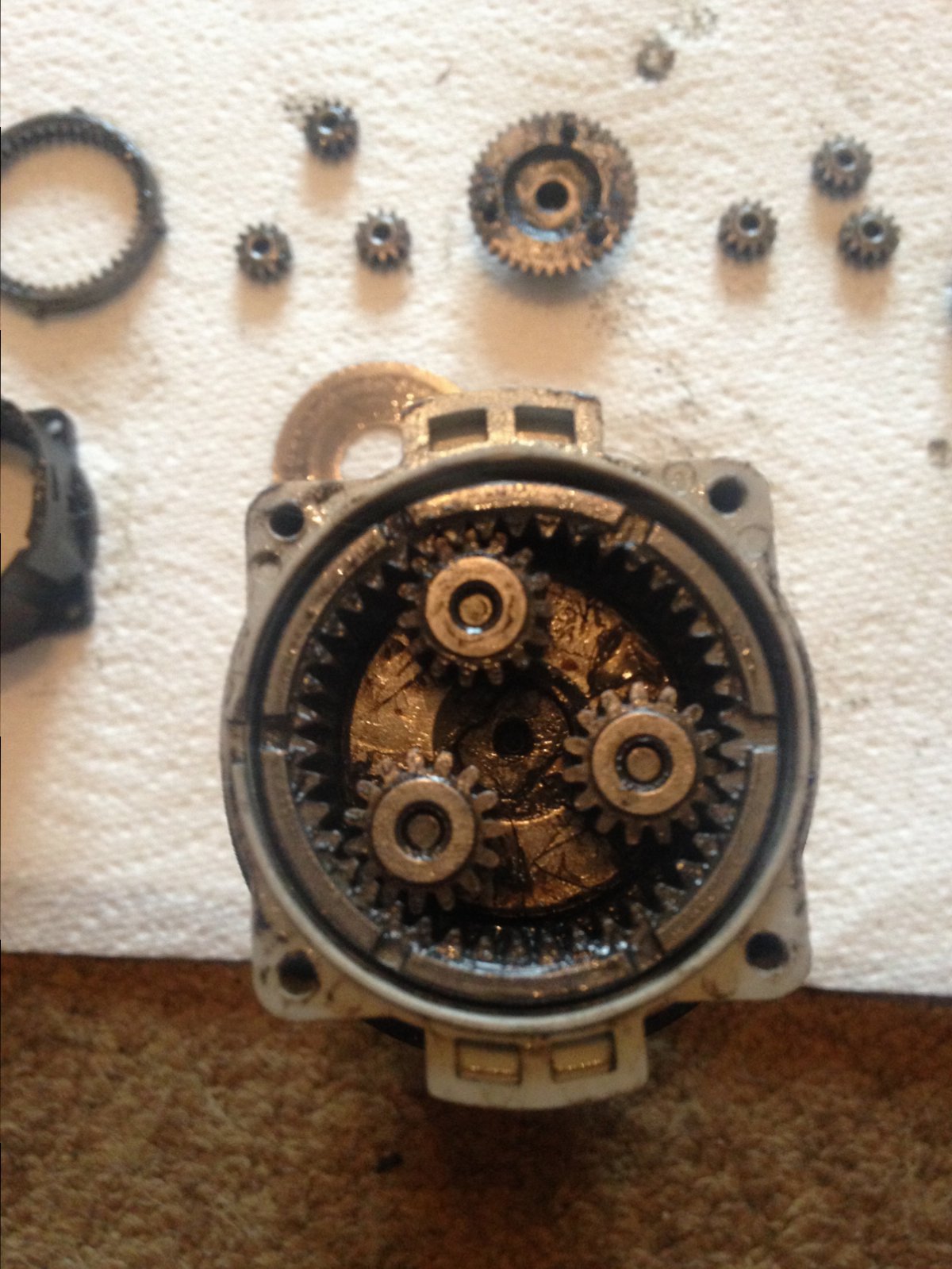

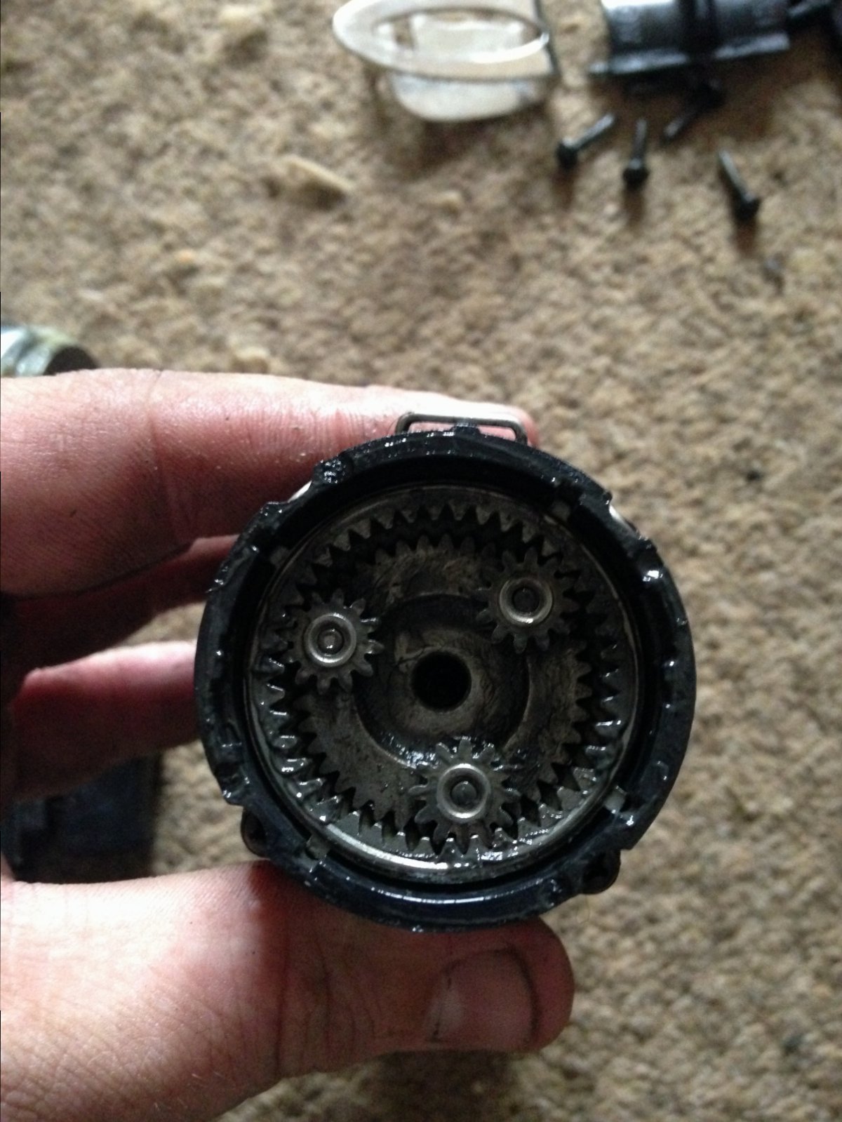

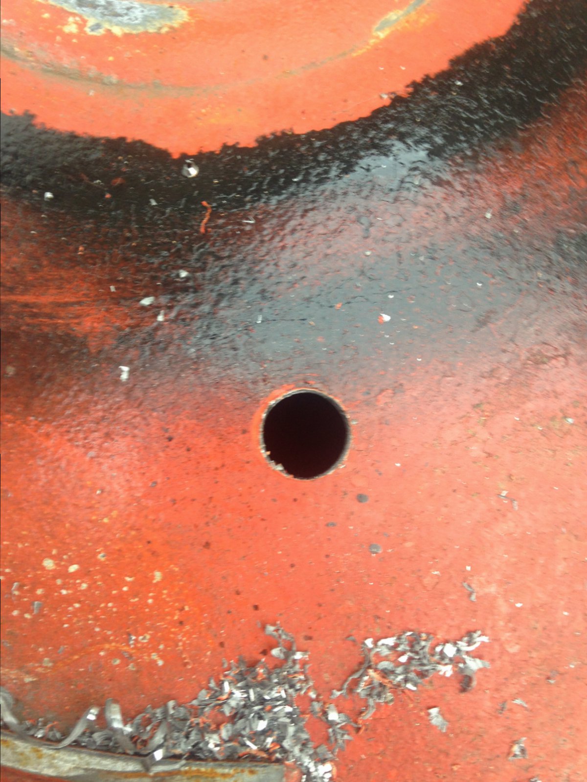

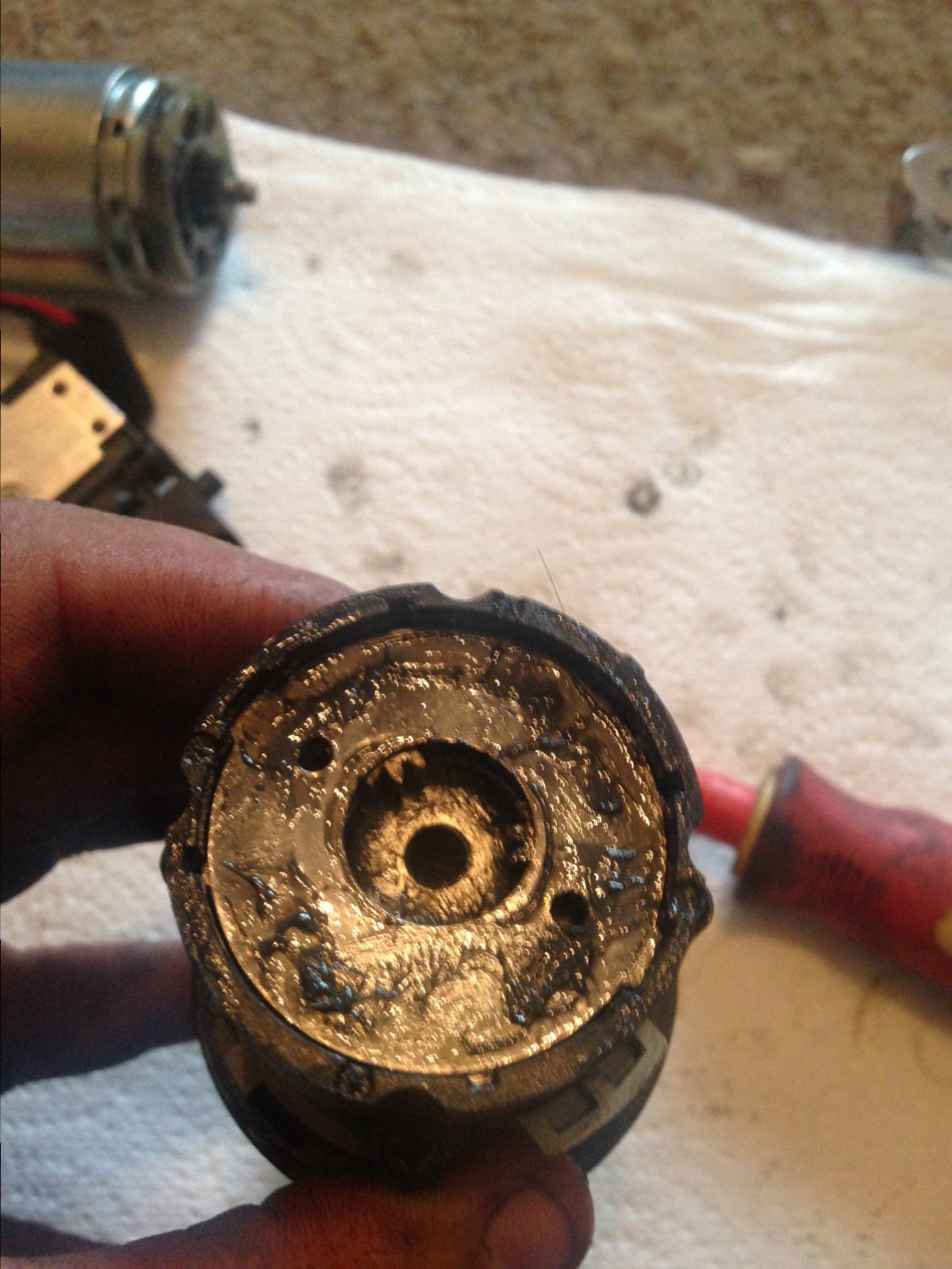

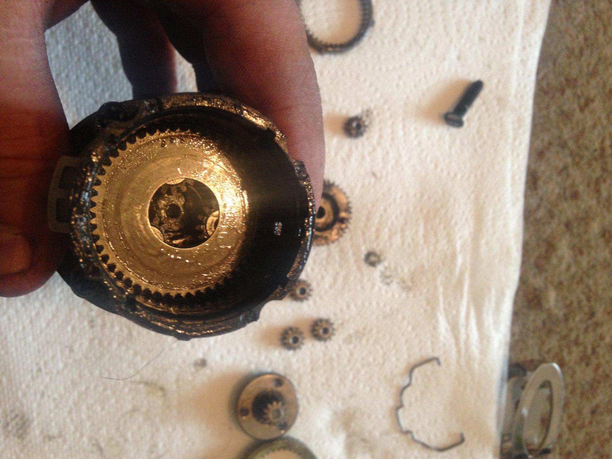

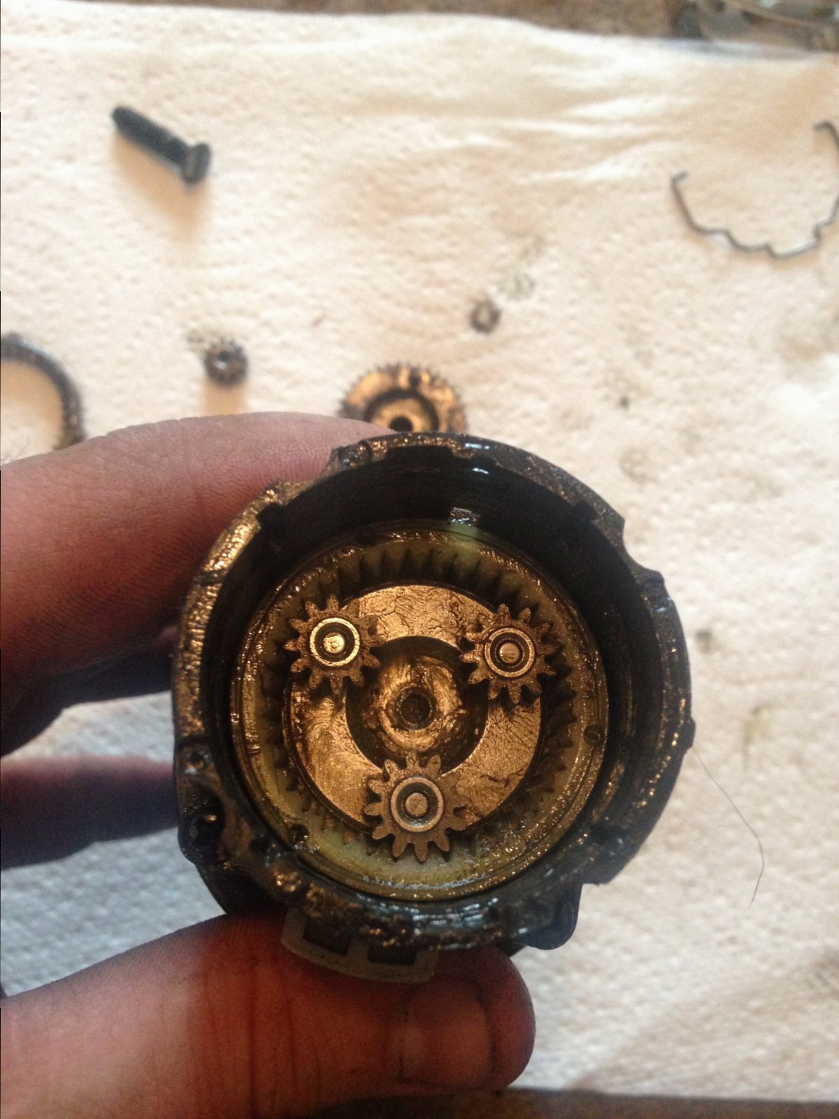

Something came adrift inside mine when it snatched holesawing through some stainless. Lost all drive in either gear. Took it apart, put it back together, got drive but only in second gear, and the torque settings are goosed now too. Although, its still done everything i've asked of it since (DIY stuff after moving house) Really is time I upgraded though,its a 2006 model. 2 of the 3 batteries still hold a reasonable charge too. Was top of the range at the time. 10 years out of a cordless drill with medium (ab)use, I think i've had my moneys worth.
Nice report, indeed.
Now I know I will never dismantle one, if it at least 25% working.

and where are those springs you mention I think they shot off when you stripped it as I can't see any in the pics
Don't see how any of that lot caused it to drill wonky holes, unless the bearing on the chuck had gone causing the chuck to wobbleand where are those springs you mention I think they shot off when you stripped it as I can't see any in the pics
cant see it my self, may cause vibration within the gearbox but not enough mass to make the drill itself make orbital movementsDidt realise I Tom the picture before I took the springs out lol.
I would think that with broken springs there is uneven load in the gearbox unit causing a bad vibration/wobble which transfers to the drill bit...like trying to drill whilst moving the drill side to side really quickly...
