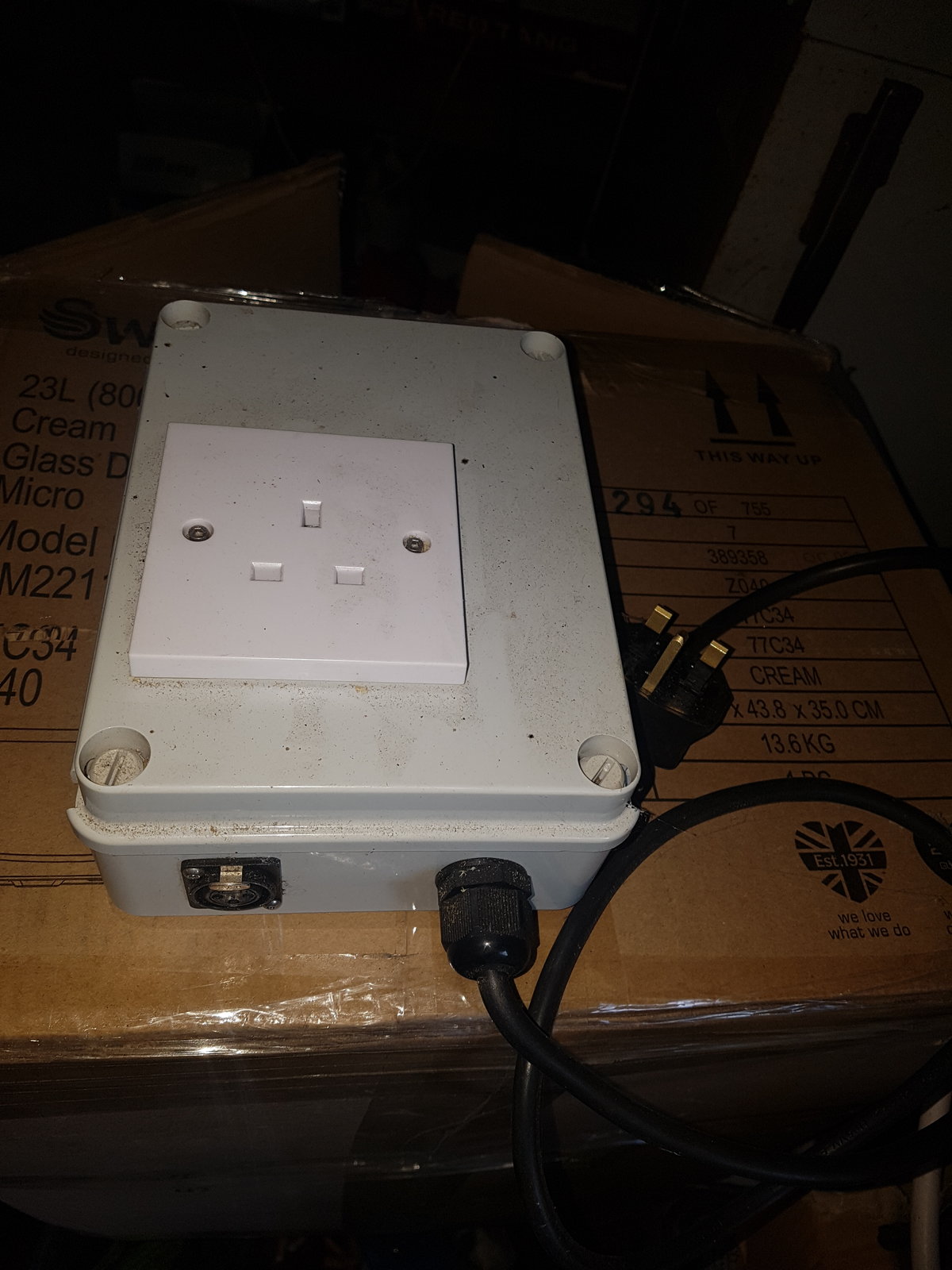

If you are going to put it in a box with a relay etc then I would mount a socket outlet into the box as well.
That way you could plug anything into it at will and not have to chop into cables .
You can use the heater in the winter and aircon in the summer.
Or the kettle so a cuppa is ready when you walk through the door!

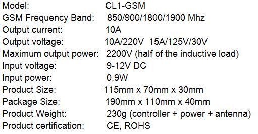

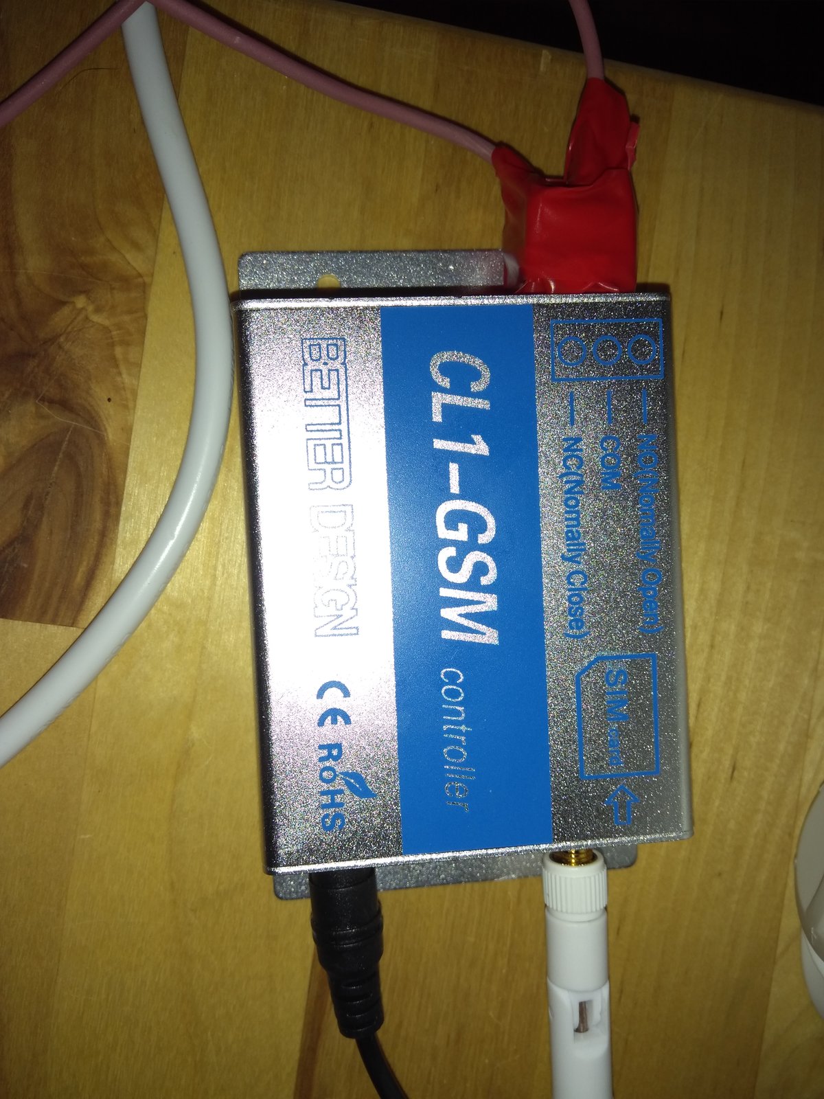

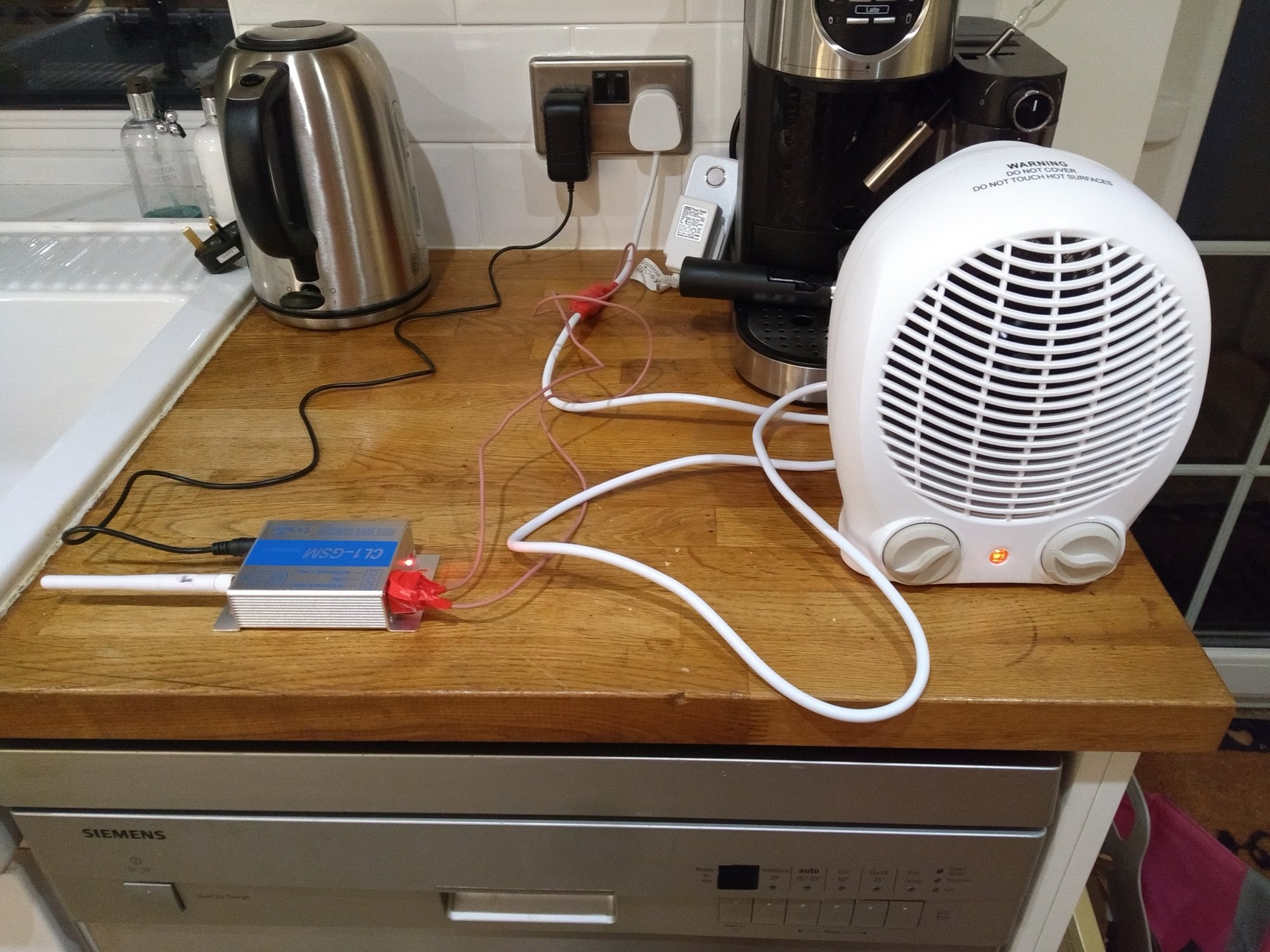

I bought a GSM remote controller to switch a wee fan heater on at the workshop. The model number is CL1-GSM and works a treat. Dead simple to wire up. I got a free pay as you go sim from Tesco. Simply send a text to turn it in and then a text to turn it off and it works which I'm always amazed when I wire something.
