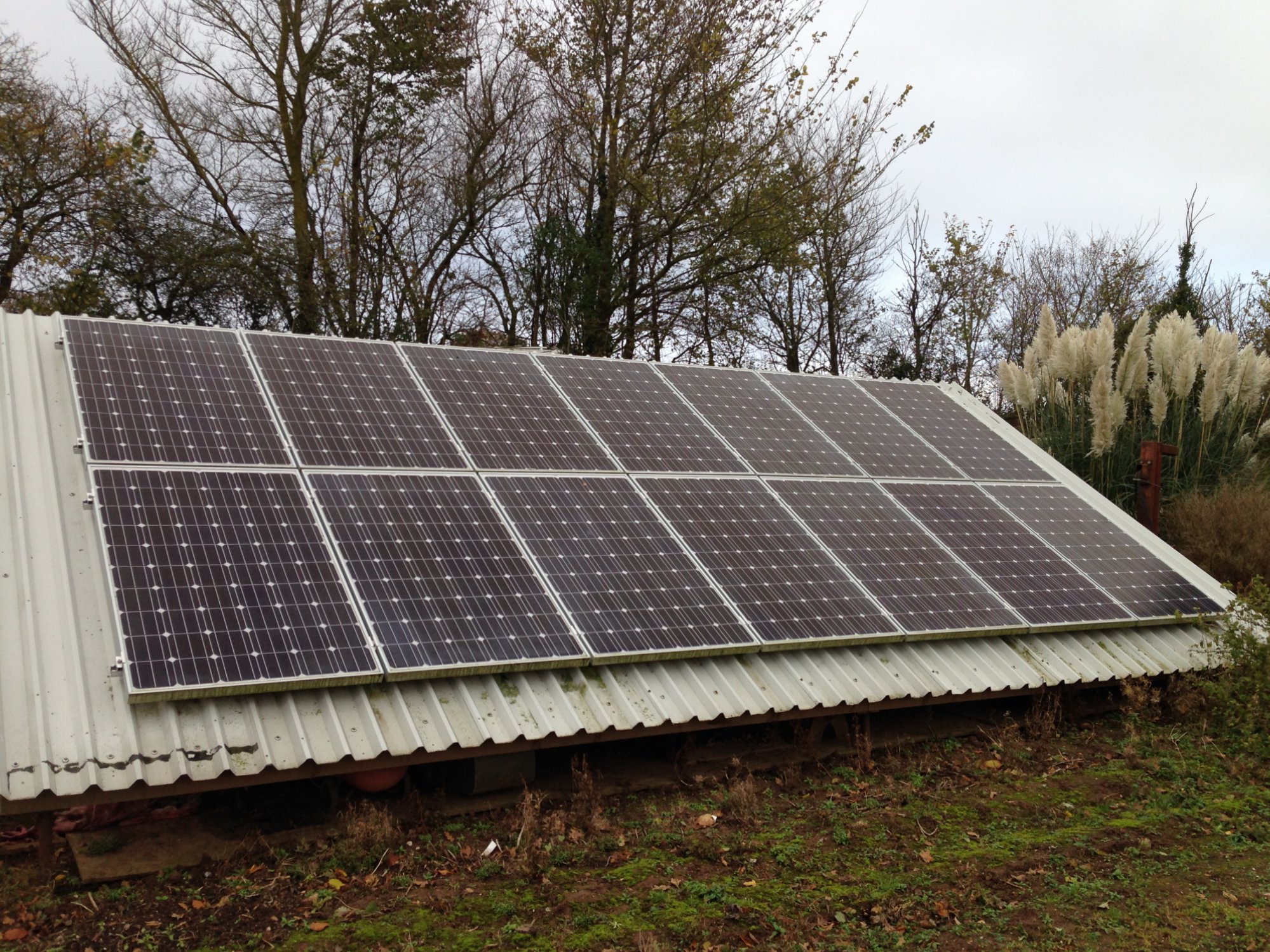

In June 2012 we had 14 panels installed, a nominal 4kw/hr array but the maximum output has never been more than 3862W/hr.
Cheers for that I thought it didn't look right when I typed it in.Your array is 4kWp kilo watt peak not kWh kilo watts per hour.
kW is power kWh is energy.
The reason you top out at 3862 watts is that that is the legal limit for production on a uk 16 amp system.
16 amps x 240 volts nom.
Actually is 3840 watts but close enough.
It was an open sided shed about 3m high and 8m long so we built a frame over the open side and clad it in some box profile I scavenged.If that on a building or free standing?
