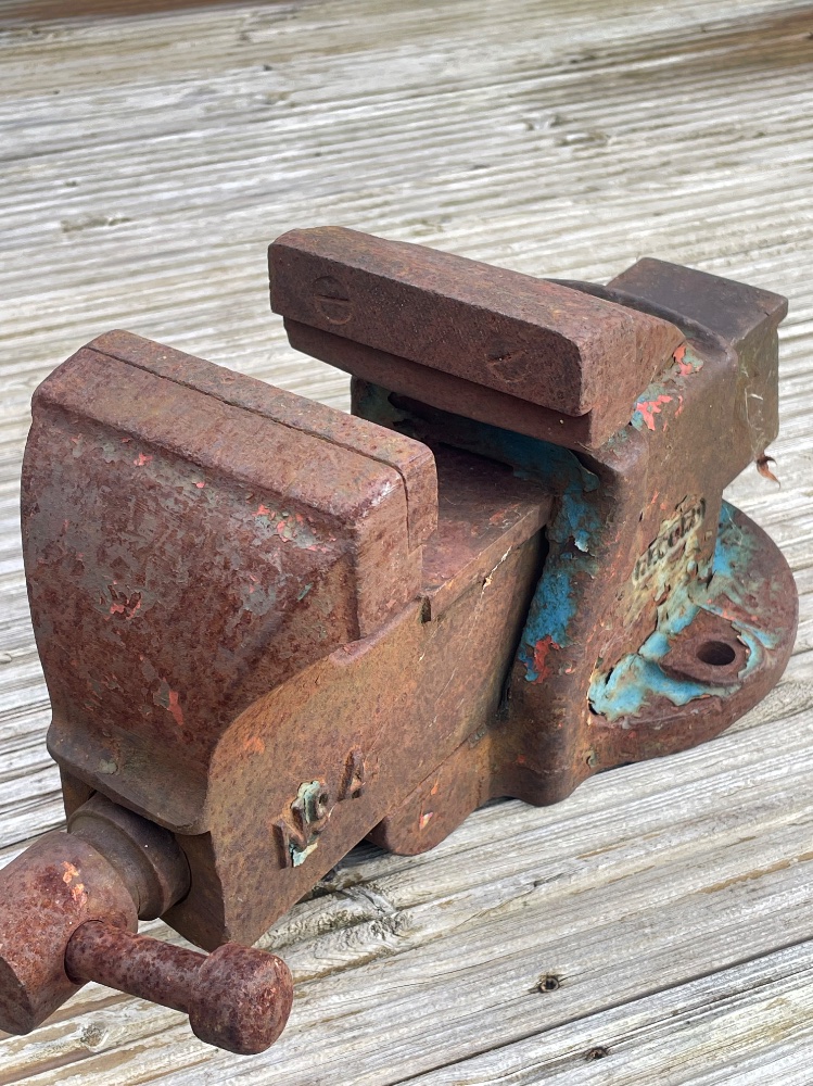

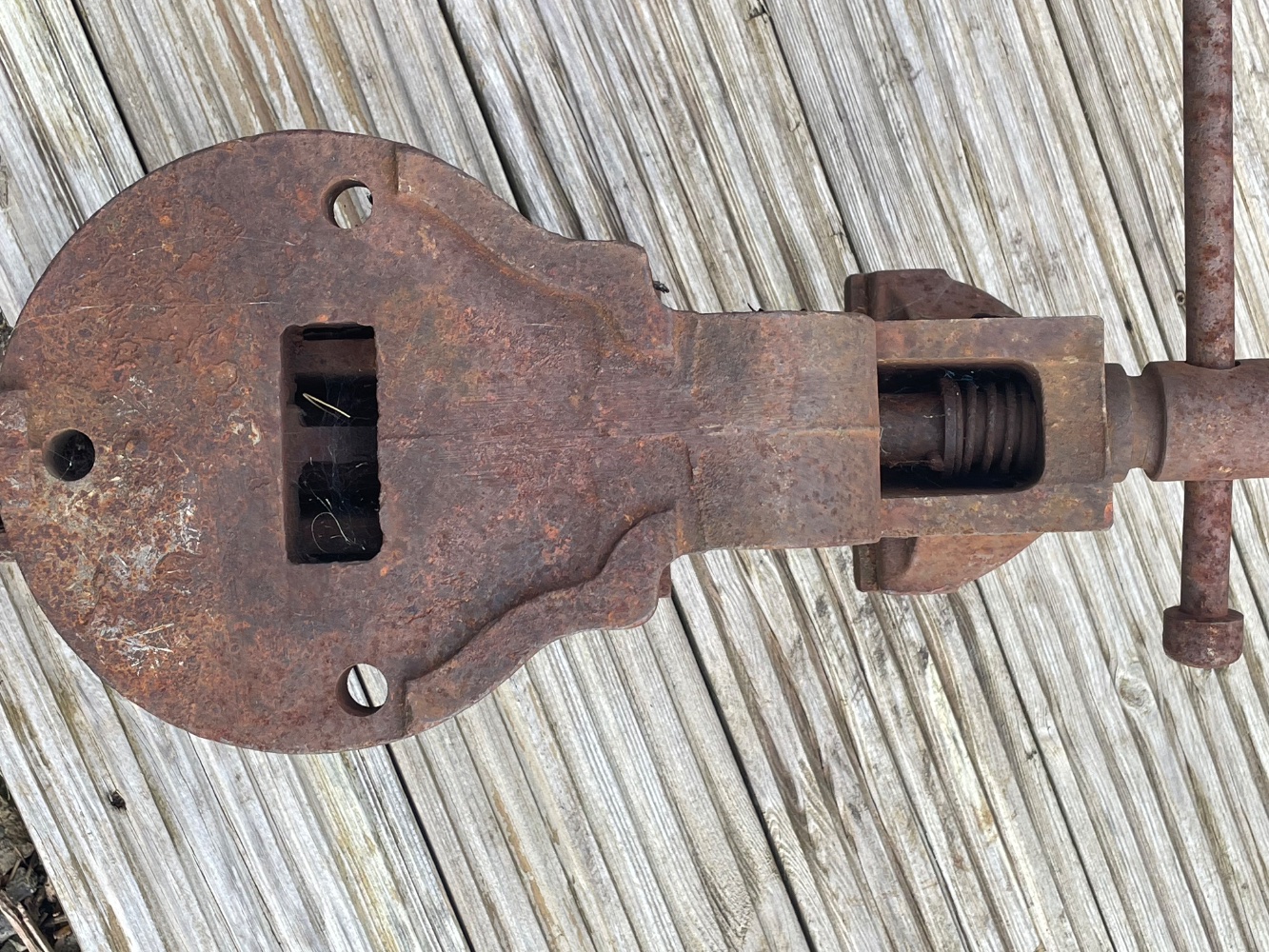

I think I might need a sledgehammer
To loosen seized or gummed up stuff, a single heavy blow might not be the way to go.
What works better is multiple, softer blows, prolonged vibration rather than a sudden explosion. An air chisel or an SDS drill with one of the radiator sludge-dislodging tools in it works well. It will help if the item is upright with penetrating fluid puddled in the joint where the pieces should move.
