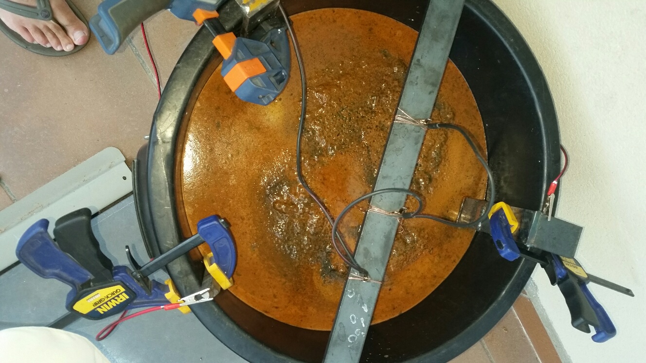

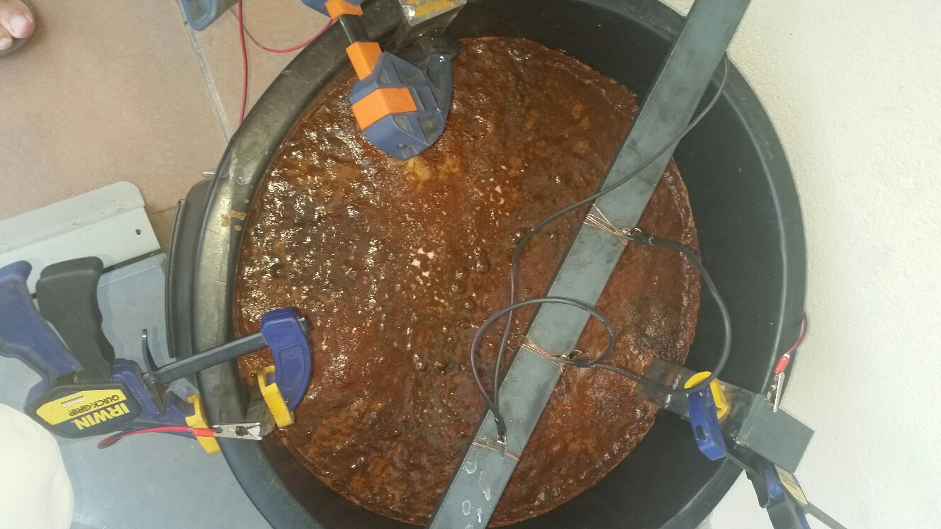

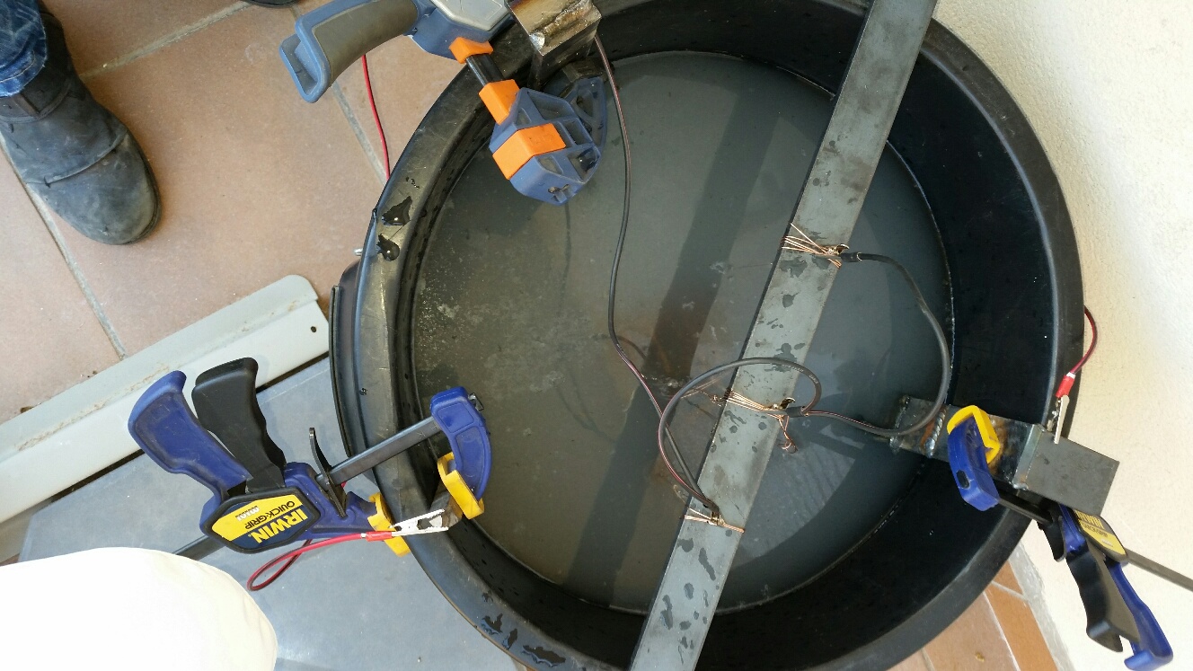

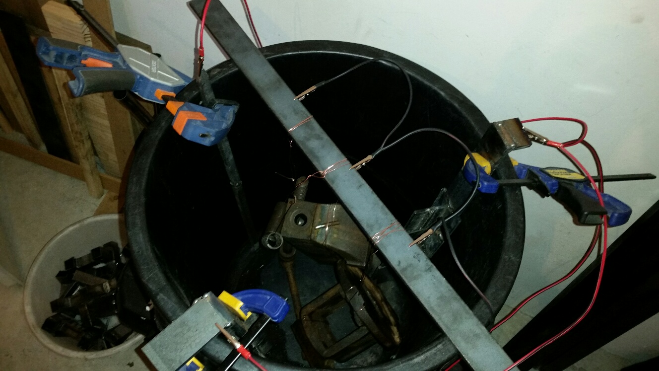

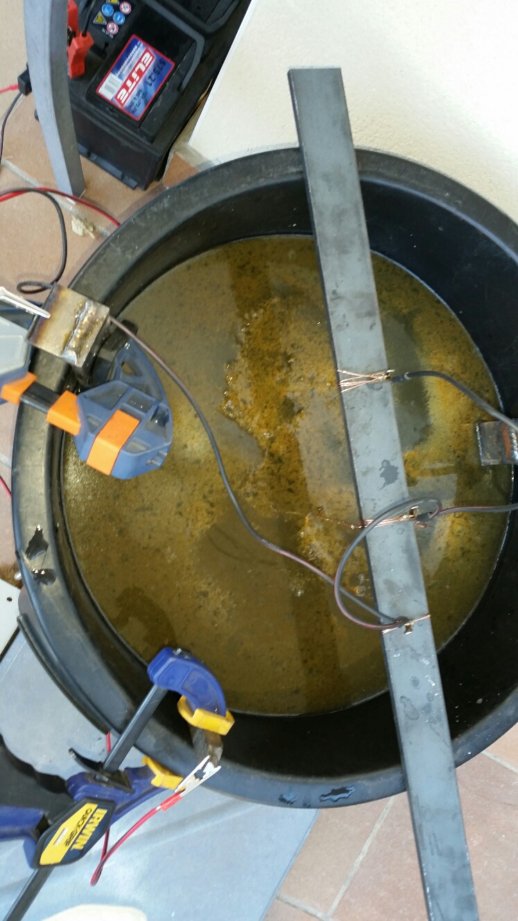

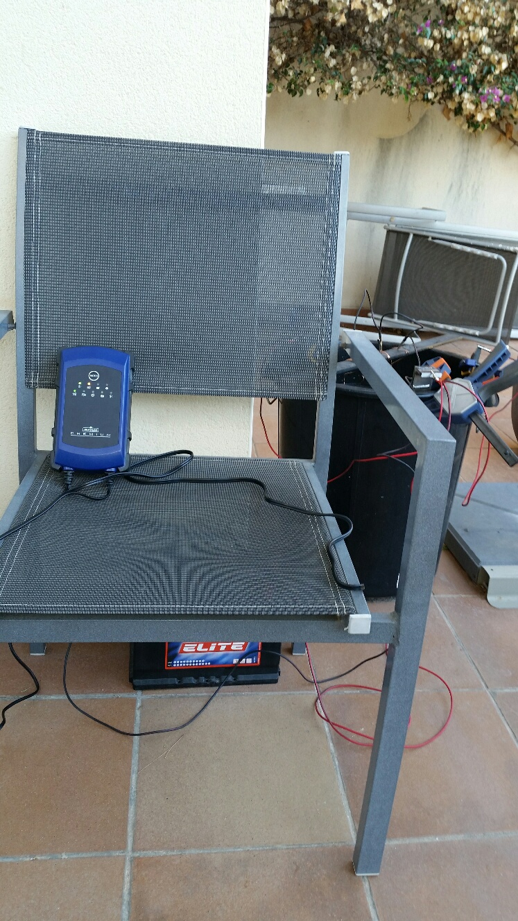

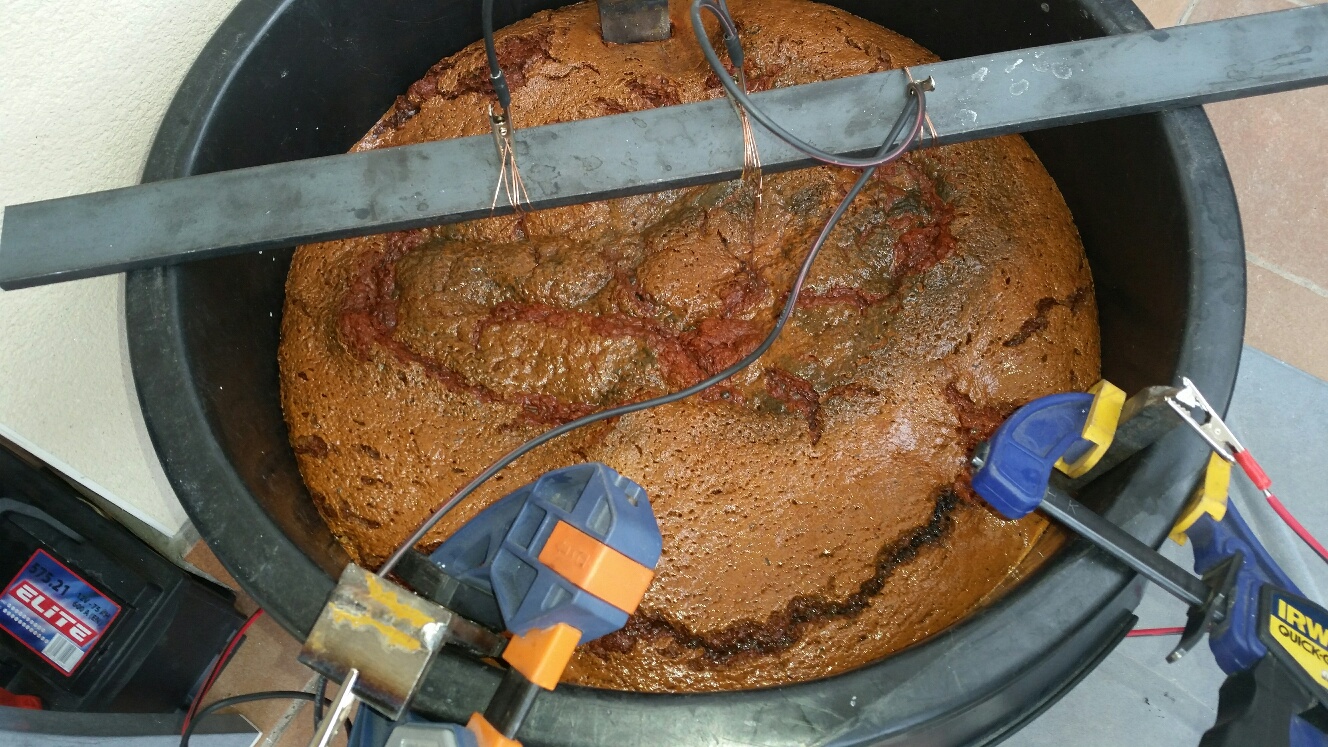

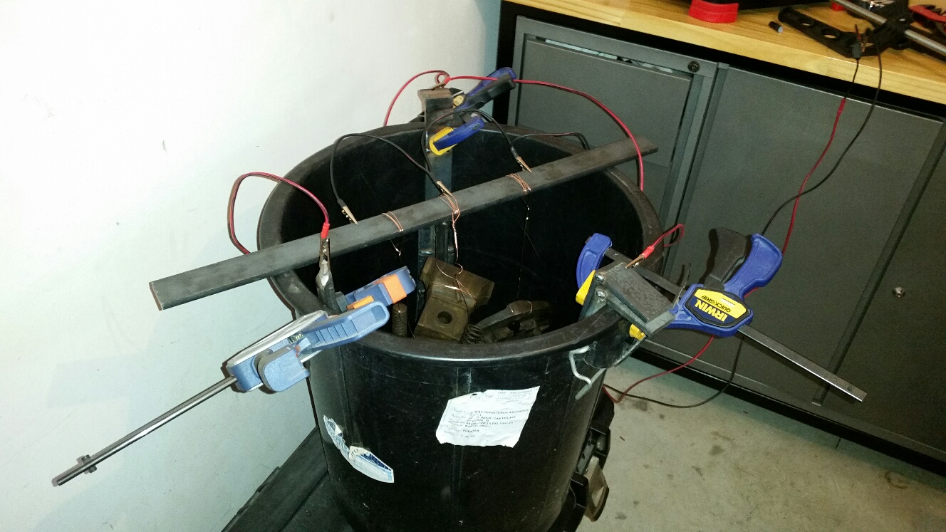

Welding wire to hold the bit to be de rusted is ok.
On the positive cathodes leave about 1" (25mm) (2.5cm) approx. above the water and connect the wire there.
Have as many as them as you can, the greater the surface area the better.
Consider putting in some mesh at the bottom of the tank.
If you want to be fancy add a magnet at the bottom as well and a water mixer.
