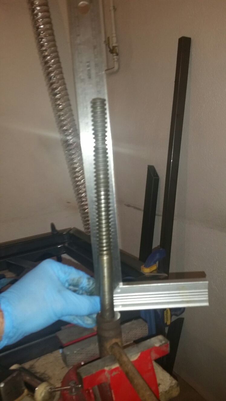

Thanks matt will get it cleaned up first then have a go.A press, else a couple of hardwood blocks and a mallet. You want the blocks several inches apart, and then place the bent portion over the centre of the gap, and then tease it back to straight with blows from the mallet.
Are you sure that square is square?![]()

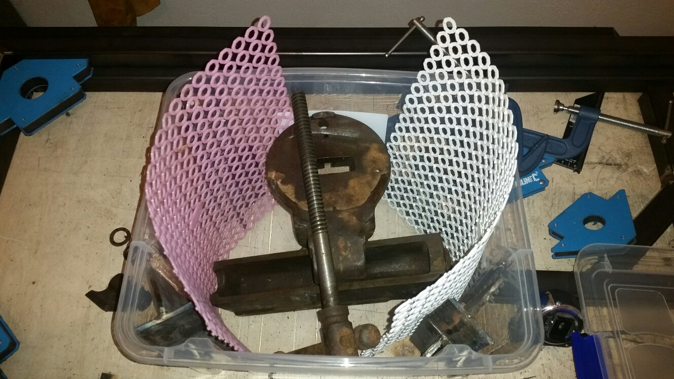

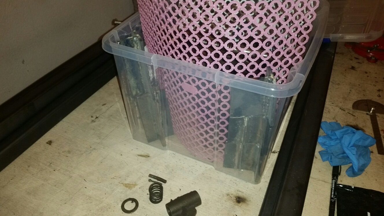

and found some draining things the in-laws bought last time they were here

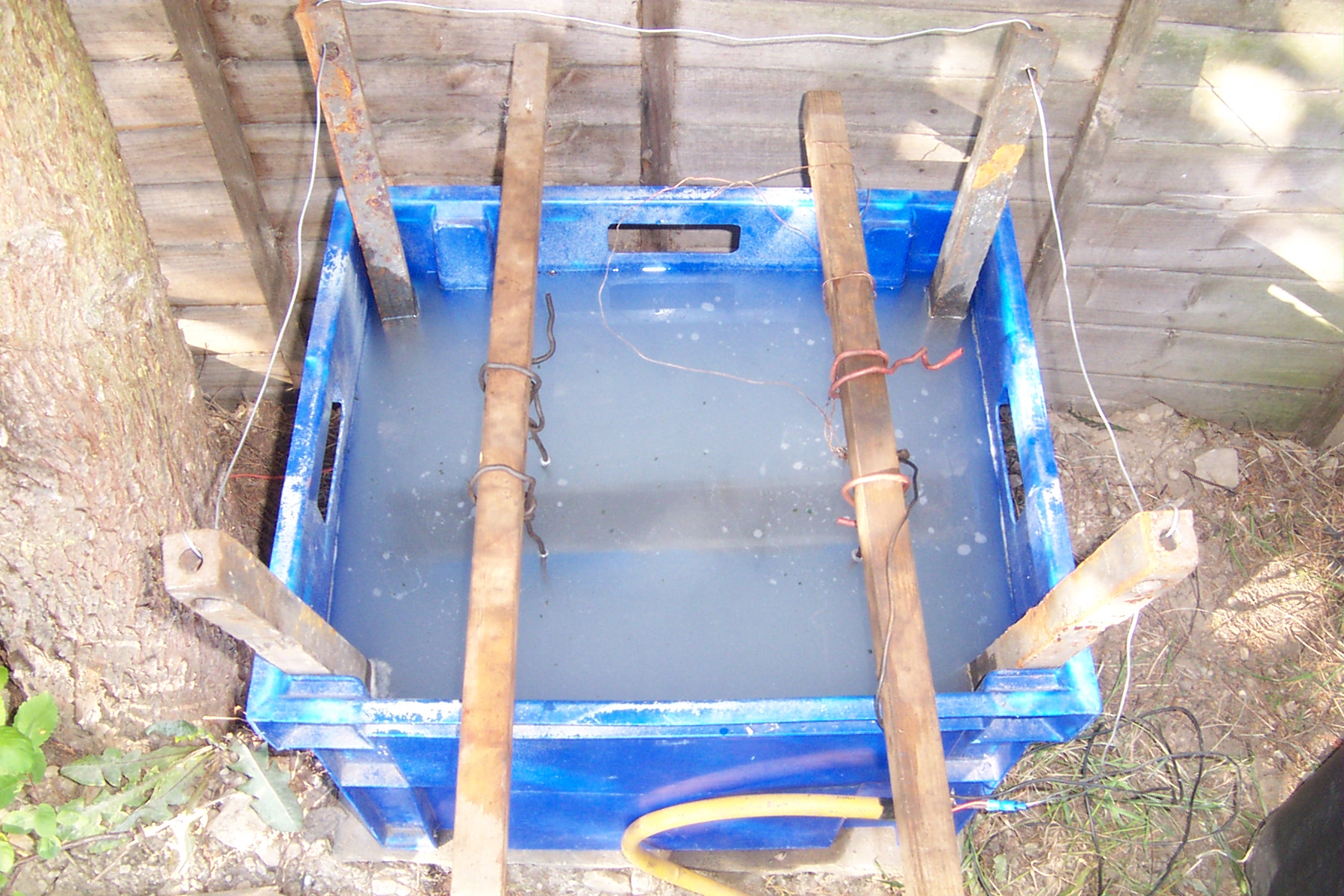

.Thanks matt i have a big dust bin in the back garden will use that.You're better off suspending them. You want the solution encompassing the piece, and the crud will end up as silt on the container bottom, so you don't want the pieces sat in that either.
This is one of my vats, to give an idea of how I go about it.
