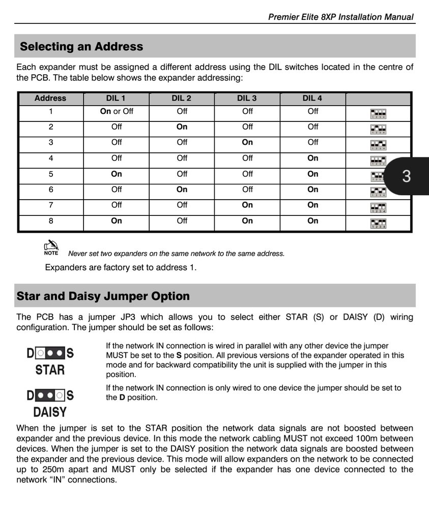

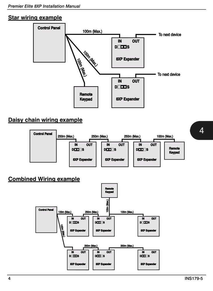

Yes thats what I mean…many alarms are wired by running from sensor to sensor, reducing your zoning options along with the amount of cable used. Is your EE zone also pir?
EE = Entry Exit?
Yes they are PIR and will be programmed as such. I can have a short delay time on the door nearest the keypad. And for the other access door to house have that one programmed as another entry route with slightly longer delay time.
Both garages will be set as an inner room type deal so as soon as they would trigger the alarm will go off. (Can't recall the terminology but I understand that the PIRs have to be programmed correctly according to my layout)
