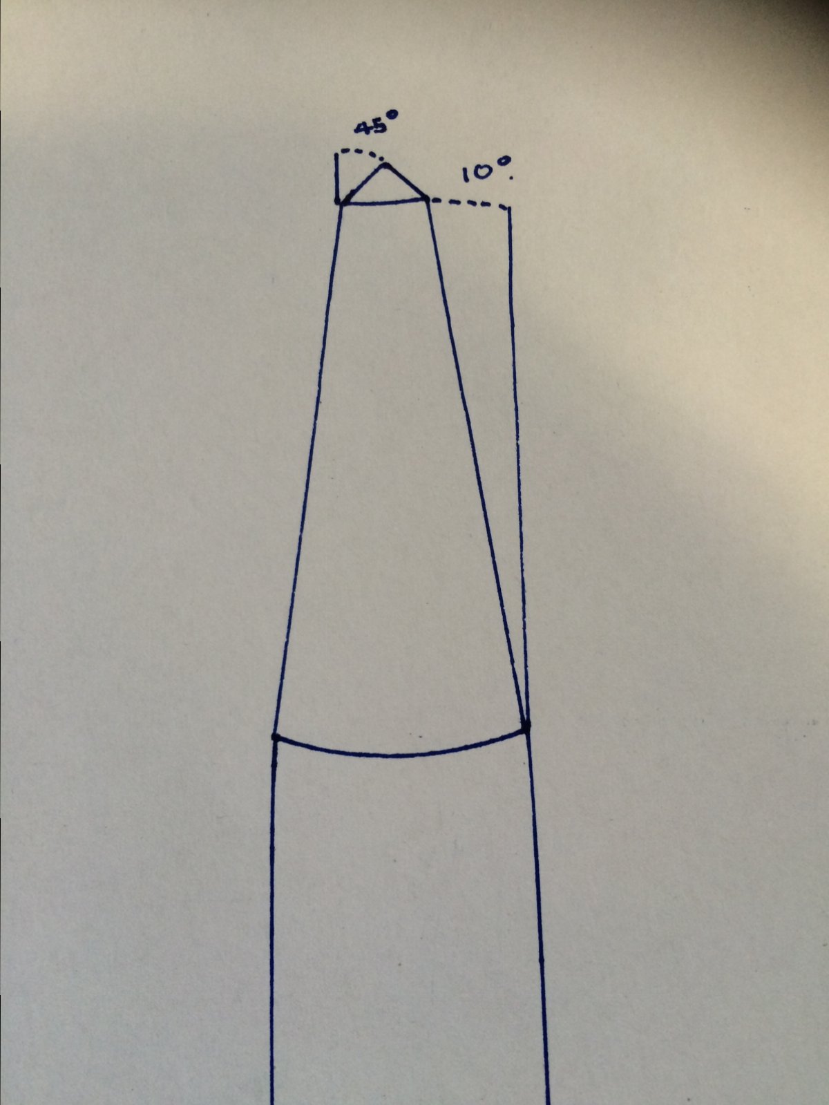

Also ive prepped you 2 x 2.4 tungstens the way I would use them for ac.
I did you a dc prepped 1.6.
Try out the ac ones on 70/30% balance and see what you think. If you like the prep copy it. It is the only way I do them.

No probs I'll put one up Tomoz.give us a picture of your prep Richard , ive tried many different shapes and still havent found anything that I can rely on

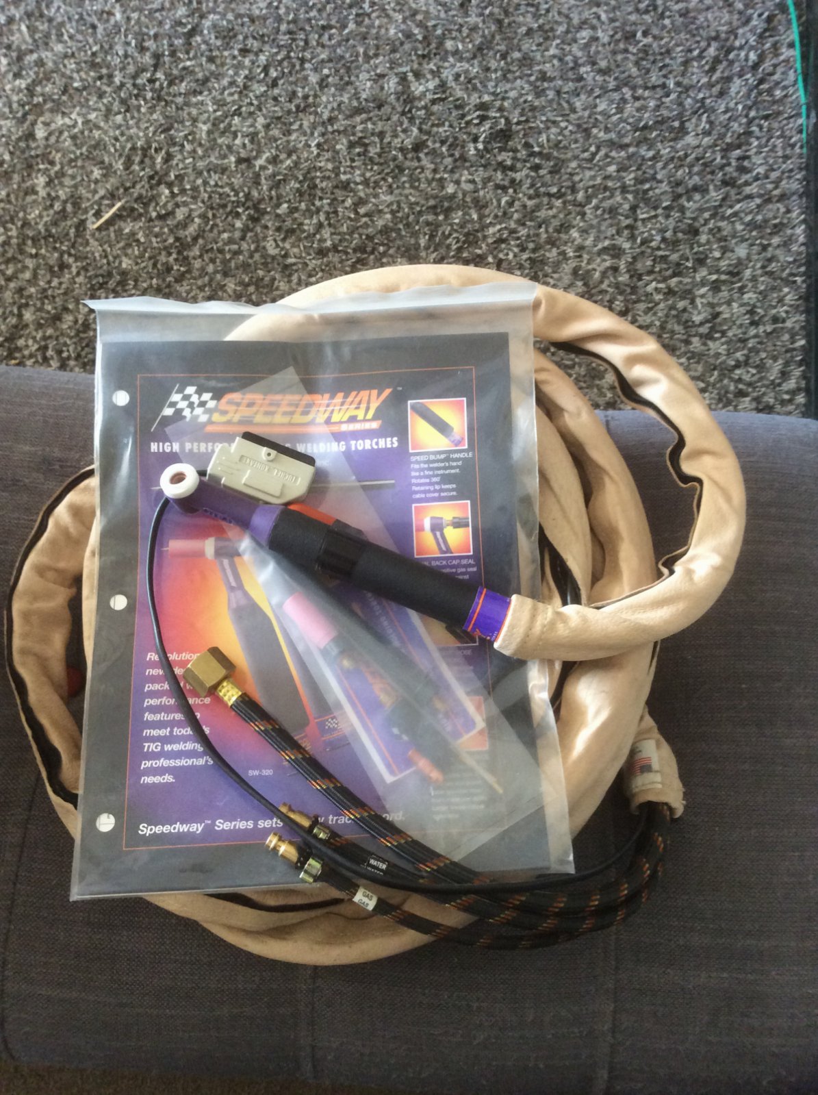

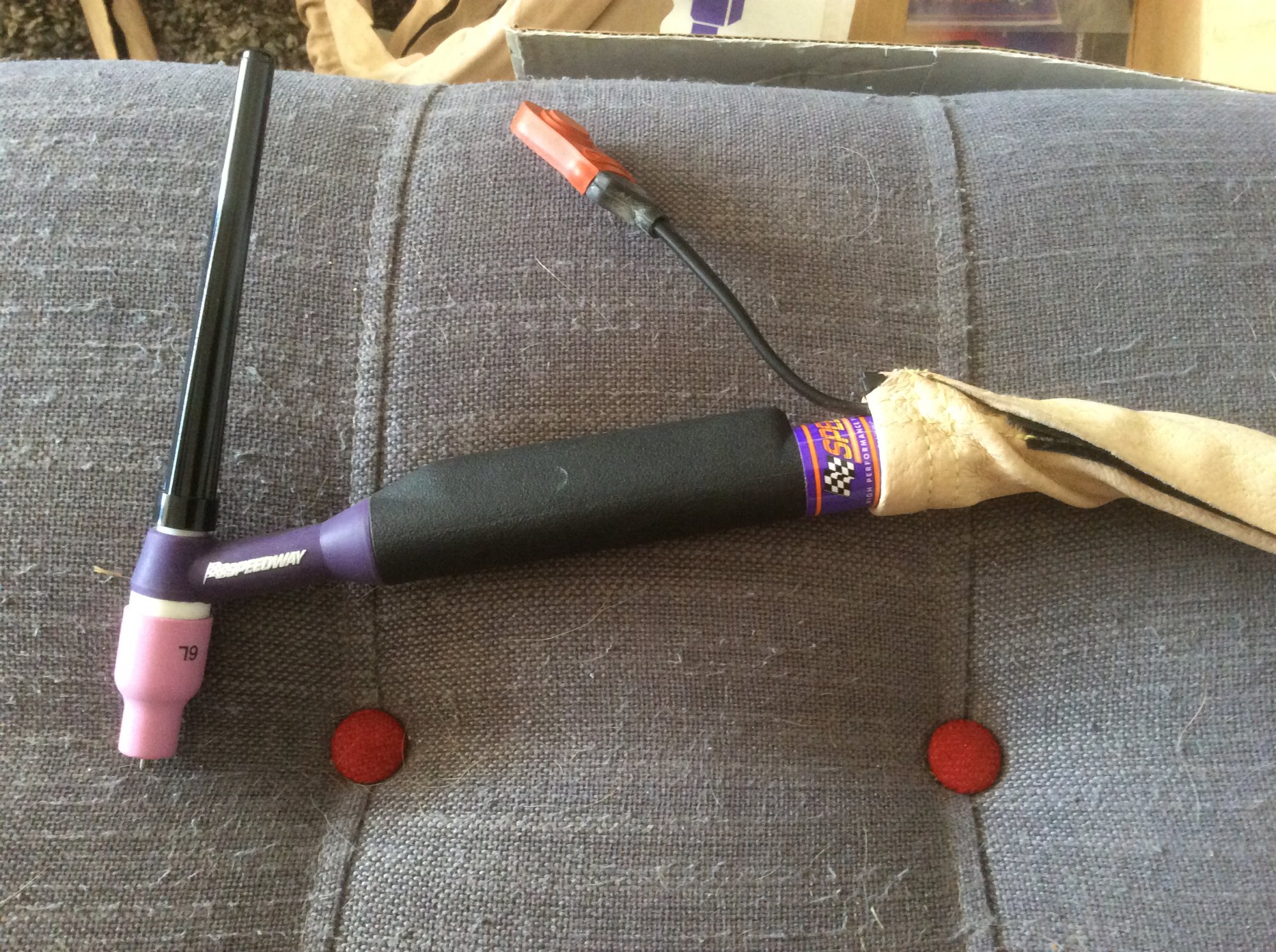

Yes it certainly the one I would of gone for.Nice to see the torch was as good as it looked in the auction![]()
Not sure about the girly colour though lol. Mine was blue.
