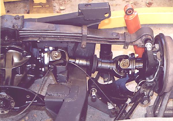

Just what you want a leaf spring as a top arm
Been there, done that, & had the skid marks to prove it.
Vitesse, many years ago.
The Mk 2 was better, not great, but better as it had the lower wishbone arm and the Rotoflex doughnut coupling.Been there, done that, & had the skid marks to prove it.
The tie rod removes most of the shear force
and the combination of coilover position and top link removes a lot of the braking force IMO
I presume you are getting rid of the leaf spring ?

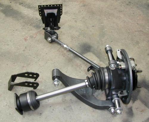

Hi guys
I am also trying to find out what adjusting bush was used, but its a long shot to find that
The original wishbone is in the middle in photo No 1
), that threaded adjuster looks just like a part TVR used on my car, I couldn't find replacement bushes but got some the right ID and OD but too long, and shortened them on the lathe.Why would the coilover position remove a lot of the brake force?
I do think hard my friend and have designed suspension systems beforeAs said that joint defiantly has some shear loading and anyone who thinks the damper has some influence on the loadings should really think hard before giving advice on something as critical as this.

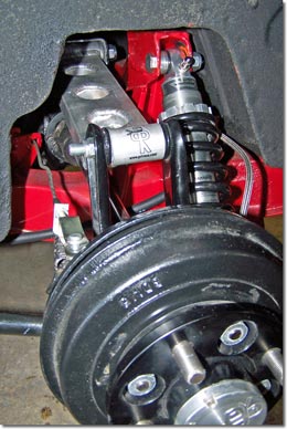

because the coil over becomes another telescopic link, it is pushing down off hub centre, to the rear of the hub unit and that reduces the turning moment you can clearly see the coil over mount pointing rearwards with the nuts and washers, the front tie bar forming a triangle with the front of the bottom wishbone that is a normal two bar wishbone set up, the triangle the wishbone forms stops the rear of the hub unit moving in and out at the rear ie the tracking adjustment keeping the rear wheels parallel.
The tie bar also along with the top arm help each other to stop the brake reaction turning moment, by the tie bar being pulled ie under tension, then the opposite under power, it would go into compression to stop the power reaction ,
If the tie bar was mounted along the wishbone between the inner and outer joint as in escort mk1/2 then the two joints would be in slight shear as they are in escorts and can bend under extreme loading the brake reaction in escorts is taken by the shocker
But as can be seen in the tr6 case the the tie bar is mounted right at the hub.
So where you think that inner joint is in shear?

On all the other small chassis triumphs. They have a solid drive shaft that causes big camber changes.
HOW can a coil over pull up???????they support the car!!If anything the damper will be pulling up due to weight transfer and not pushing down,
if the wishbone was removed the tie rod and the spring/ top arm would stop it rotatingif you remove the wishbone and leave everything else attached the hub is free to rotate,
