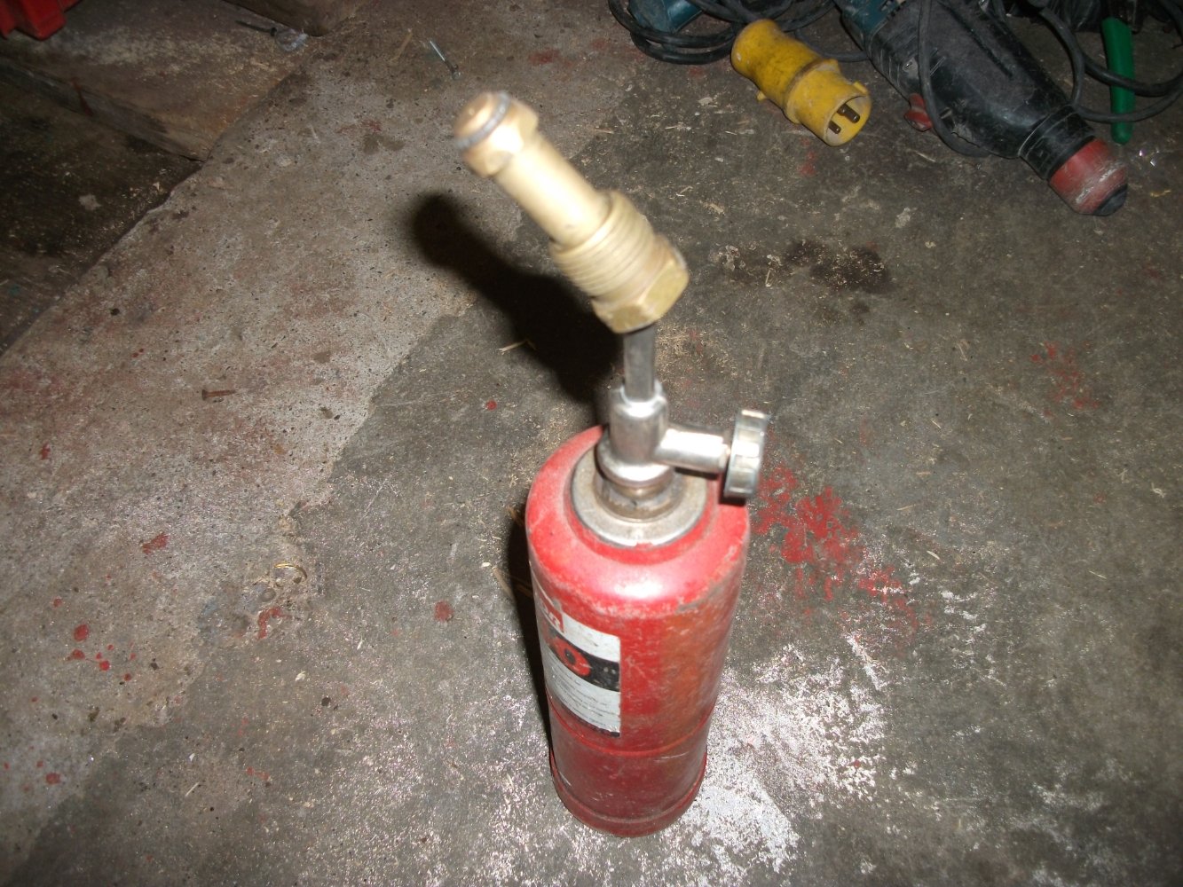

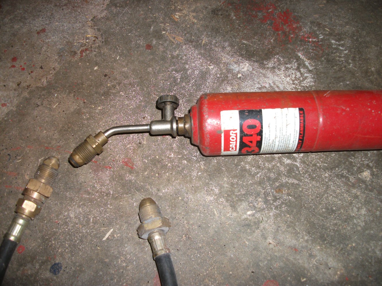

anyone refilling the plumbers type propane bottles from a larget calor type bottle?
i use the little hand helf torch pretty often on cars and for small bending aplications, but paying between 12-16 quid for mapp gas bottles.
i now have a 47kg propane bottle so wondering about just using propane instead. the torch can be run form the blue bottles and im assuming its just straight propane in those.
any issues with refilling them? apart from the obviosu needing to turn the large bottle upside down?
would also be interested in refilling the gas for my camping/fishing/crane stove as well that takes the little 450g dumpy cans of gas but i think has the same thread as my blow torch although will need to check next time im at the lock up

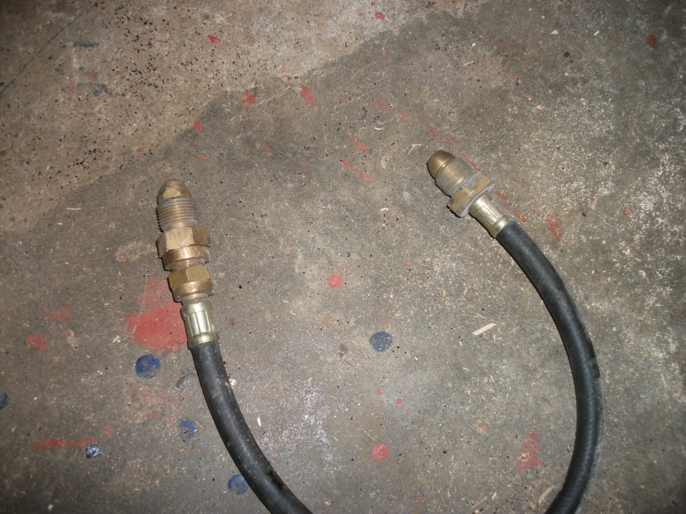

can fill the 7.5kg bottles of a 47kg bottle with the other adapter i have
